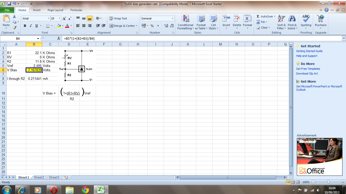

It looks like your earlier suspicion was correct, a duff TL431, with P1 set to maximum and a value of 6K8 for R9, the voltage should have been just over 7V; see my calculator.
For some reason I can't upload the excel spread sheet.

Hi RonD2
With the given resistance values, you should be getting:-
voltage across the TL431 should be 5.06V when P1 set to maximum
voltage across the TL431 should be 5.8V when P1 set to minimum
Double check the value of R9, it doesn't look to be 6k8.
