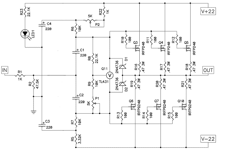

How did you measure the resistance from the drains to ground? What range on the ohmmeter? Did you measure the resistance from the drains to the heatsink with the heatsink isolated from ground?
I have just been using the continuity tester. When the heat sink is ungrounded, there is no continuity in any of the mosfet leads. Only when the ground wire is attached.

Pls look at this connection. The green power line from the 3-prong power socket ties to chassis and to one lead of the thermistor.The other lead of the thermistor ties to star ground which is made up of 2 green wires from the right and left psu pcbs. Is this correct per schematic? A thin pink wire connects from this *ground on the EU connector to ground on the pcb affixed to the heat sink. Is this correct per schematic? When the heat sink is bolted to the chassis it is connected to power ground. Chassis power ground and psu *ground are separated by thermistor CL10. Is 10 mean 10 Ohms?It is 1.3k R from drain to ground in all 3 P fets.
This is how it is wired.I think it is correct per the schematic.
Again, correct. The pcb is grounded to the chassis.
It is actually a CL22 thermistor but it is indeed 10 ohms. Bolting the sink does tie it to the chassis ground and through the thermistor to the psu ground.
That is probably OK. Since there are diodes in the PS, you should also measure the resistance with the multimeter leads reversed. If you measure the resistance from V+ and V- to ground with the output board disconnected you will probably see about the same resistance.It is 1.3k R from drain to ground in all 3 P fets.
800R with the leads one way, 1.3K when reversed.
V+ is 16k to ground and V- is 3k to ground with V+/V- disconnected from the F4 board but with all grounds intact.
Strange that V+ to ground is 16K. Don't you have a bleed-off resistor on V+?

I suppose the failure is in handling C1 and C2 please put in for a test two 220uF
I suppose you jumpered the wrong one.
The lower 220uF must be jumpered and the upper 220uF must be replaced by the 1000uF
Am I right?

Thanks for ZM's schematic! Didn't know it existed.
Will definitely make changes to the board based on it.
I think the fets are well isolated. There is no continuity on any of the source pins and they all measure around the same 8k R to ground.
Generg: I will definitely try 220 mF C1 and C2. May also jumper D3 and D4 and add back R1 and R2 and be able to use the regular "In" pad.

Do Not Jumper D3, D4 they are conducting only one way, your jumper will conduct two ways.......

Just had a close look at the photo of the board mounted on the heatsink in post #3753, are there any insulation washers underneath the two middle PCB mounting bolts furthest away from the FET's, it looks like the output track could be shorted to the heatsink.

Just did a quick check and this was the problem! Thanks to you (and kasey197) for finding this.
