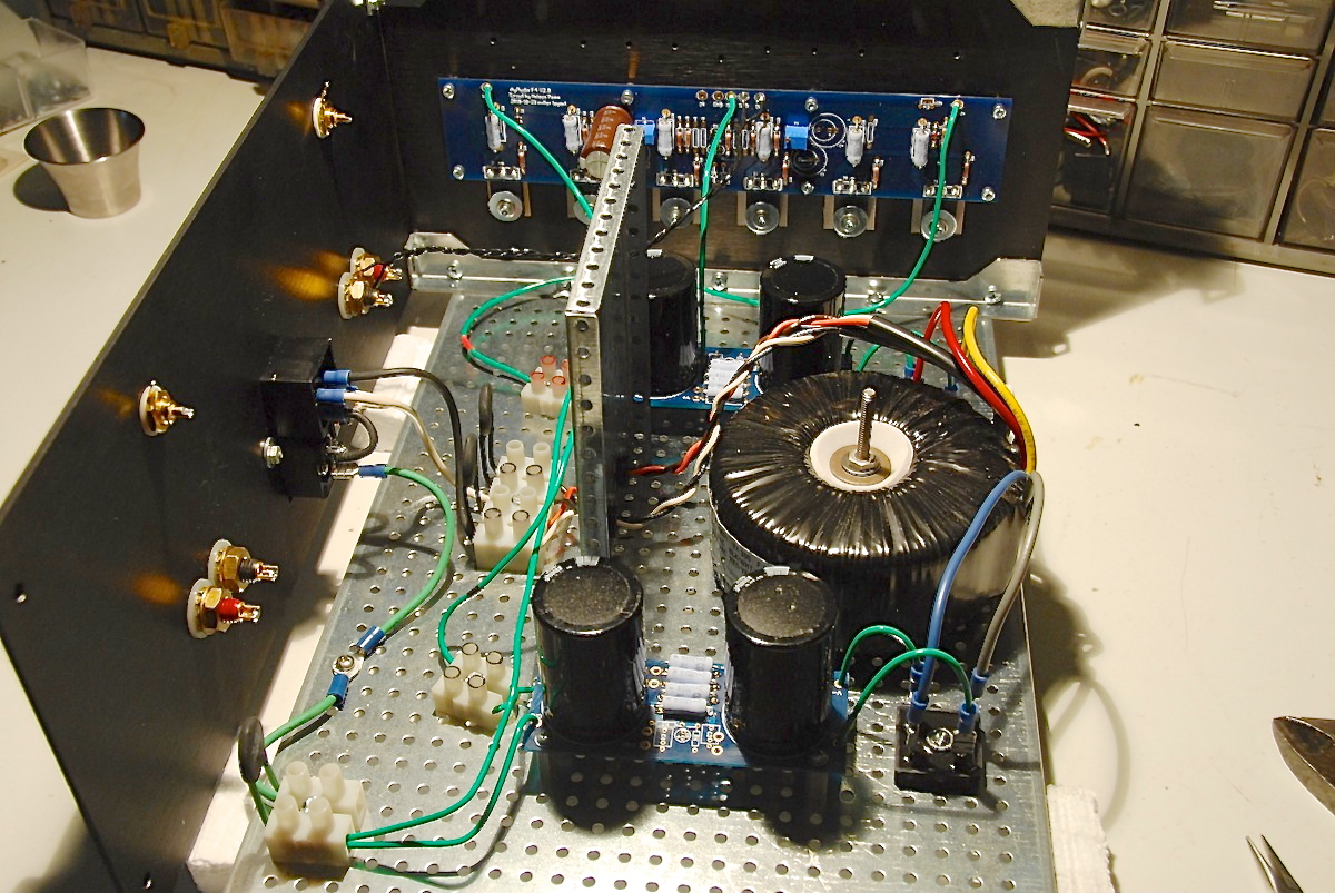

Thanks 6L6 and lhquam. I removed the board from the heatsink, cleaned it and carefully remounted it and now, I am happy to say, it is working fine.
I did find a suspicious particle or two on the pads.
Is it safe to assume that the FETS are OK as it biases properly?
Time for a break. Will post some pics after making it presentable.

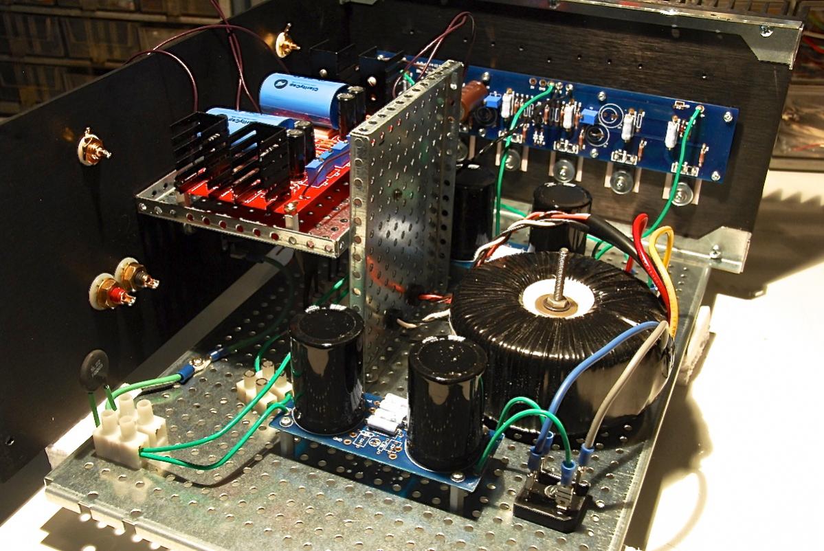

As I am approaching the point of no return on my layout, I thought I'd post a picture of where I am and where I'm going with the build.
I am assembling a BA-3/crippled F4 stereo chassis. BA-3 will run off the main PS. Finding it a bit tighter than I imagined prior to receiving the DIY chassis.
Do love working with the Deluxe 4U though. It brings back fond memories of building "Erector Sets" as a kid.
If all goes well with this stereo build, my plan is to build balanced monoblocks.
Looking for constructive criticism. This is an ambitious build for me and I can use all the help I can get!

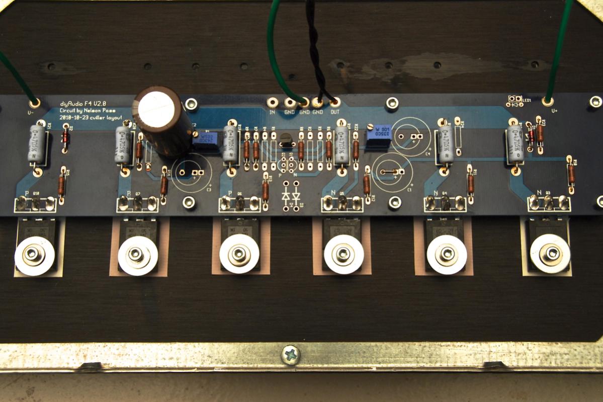

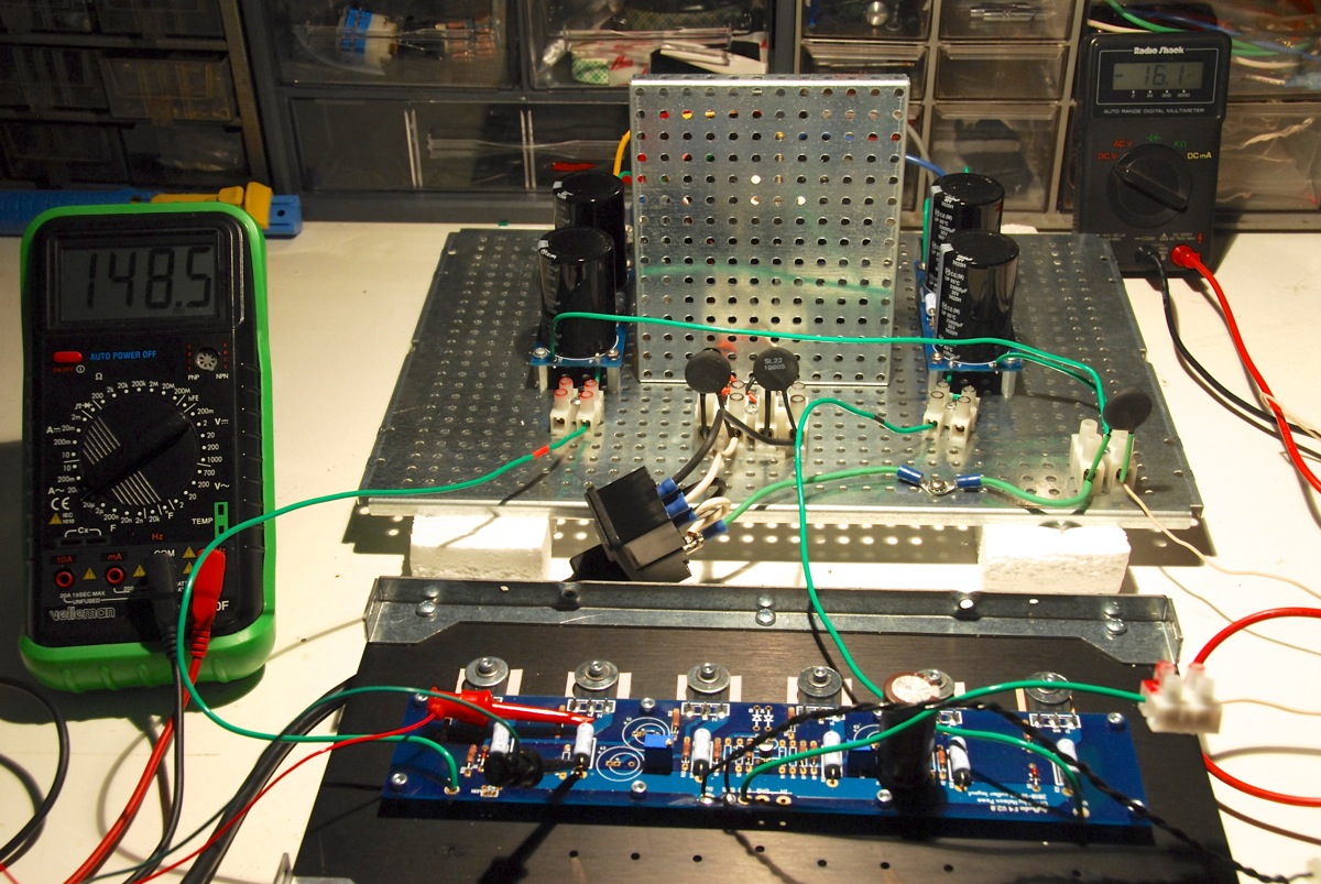

My crippled F4 board biases fine when tested as shown in the attached picture, i.e. the heatsink is not connected/grounded to the chassis base/PS. The board itself is grounded to the chassis via the CL60.
The picture was taken on powerup and after warmup is easily adjusted to 195mV bias and <5 mV offset.
However, when I attach the heatsink to the chassis (and, therefore, ground it), I get no bias and V+/V- voltages in the 100's of mV range. Feeling like I'm dancing with the devil with this, I immediately disconnected. No blown fuses and board/PS work fine when once again separated.
I then attached the heatsink to the PS/chassis base with the power off and find that all the mosfet drains are grounded.
This leads me to believe that I have improperly "crippled" my crippled F4. I have attached a close-up of the board. The cap in C2 is 1000 mF. I have jumpered across the empty C1 and planned to connect the input here.
I eliminated Q1, Q2, D3, D4, R1, R2, R3, R4, R24, R25, C1, C3 and C4.
Wish I could figure this out on my own but really need some help. Thanks again!

With all due respect, using the same color green wire for ground, V+ and V-may not be helping you resolve the problem. It may contribute to the problem. You are also using a twisted pair of black wires for power output and ground. Can you tell which is which at the loudspeaker terminal? It is also possible the MOSFETs were damaged as their rail fuses blew. Slo or fast blow may have made a difference. Which have you used?My tales of woe will keep this thread alive forever it seems.

My apology RonD2. I did recognise that you properply tagged the power rail wires with red and and black and none. MOSFETs OK.
- Disconnect V+ , V- and ground leads at the main chassis PSU.
- Isolate electrically the heat sink assembly from the main chassis.
- With ohmmeter; is heat sink assembly shorted to its own ground , to its V+ and to its V-pcb joints?
- Affix the heat sink assembly on the main chassis; but keep the 3 pcb power leads disconnected. Is heat sink shorted to chassis ground.
- Connect pcb ground wire only to power supply star ground. Shorted heat sinkto ground?
- Connect V+ wire of pcb to power supply V+. Is heat sink shorted to ground . Ditto wiyh V-.
Well it looks like your Heatsink is connecting something to another dunnit ?
Since it looks like mosfets are all nicely isolated The problems prob not there.
Why not try removing all those screws (and mounting hardware) that are holding the pcb to the Heatsink?
Seems likely one of them is connecting the Heatsink to some trace on the pcb that doesn't appreciate being tied o ground......
