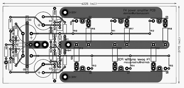

Modifications added - I almost redesigned PCB. I will probably place sources in PDF format for a minute.
schematic f4_r0
schematic f4_r0
Not so fast - I knew there was a reason I was going to wait
a day - reload the schematic and check the connections on
D3 and D4.
www.passlabs.com/np/F4R0.pdf
D3 and D4.

veteran said:
I hope i have your permission to print this board to test it out, ?
I placed corrections on schematic and PCB - now it should be OK 😉 I have to look at this design one more time in day light (it's midnight round here) and try to short tracks as much as it's possible.
Jleaman, you don't need a permission - do what you have to do 😎

This version bootstraps the front end so that the JFETs only see about 1/2 the voltage swing.
WoW! So are you saying we can get into say +-40v or so, assuming adequate cooling? Where would that put us - 50wpch or so of class A?
