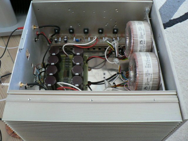

A question for they who have build a F4 already; what is the degree celcius per watt of your heatsinks ?. Have done some time with the pcb cad program but I need to know if the heatsinks that i have in mind are large enough.
Jaac TheMaster said:A question for they who have build a F4 already; what is the degree celcius per watt of your heatsinks ?. Have done some time with the pcb cad program but I need to know if the heatsinks that i have in mind are large enough.
I don't know what rating you need, but the amount of current is the same as in aleph30, but you'll have 6 volts less rail to rail.
I have mounted my f4 in a temporary box (I'll put it in a different one when I finish my preamp). The heatsinks are 36x7x18cm, but the fins are horizontal, thus making the air flow resistance too high. You can't boil an egg on them, but after a couple of hours, I cannot hold my hand on the heatsinks for more than a few seconds.
What do you think about DC protection and soft start circuit integrated on PCB? This amplifier is quite powerful 😉
veteran said:What do you think about DC protection and soft start circuit integrated on PCB? This amplifier is quite powerful 😉
The usual NTC is enough for softstart of the toroids, and there is no need to do tricks to avoid thumps, they have been removed by papa! 🙂
I have placed the fuse and NTC on a small scrap board to the left of the psu board.
It might be a good idea to have some speaker protection in case of transistor failure, if you have expensive speakers, but the circuit feels rock solid as it is.
