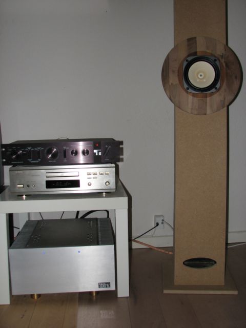

I have been listening to the F4 on the Abby-clones for a while now. The Abby's are ofcourse an easier load than my ProAc clones and the F4 overall seems to be at home in this setup, with the NS10 as preamp. The F4 can drive the Abby's to really high sound levels, seemingly without loosing the grip at any time. It has more control than the Zen's and Aleph's in the same wattage range. All music genres comes through as they should. Listening to acoustic Delta blues and jazz is intimate and engaging. Power Blues and heavy, comes through in a realistic way too. I think the F4 is one of the most versatile amps I have heard yet. Soundstage is very precise, I beleive mostly because of the extended and detailed J-fet topend? Good firm bottomend, deep and clear cut. Voices are very good and natural.
I will stop now, trying to keep both feets on the ground, allthough its hard not to be very enthusiastic about an amp sounding as great as the F4😉

steenoe said:I have been listening to the F4 on the Abby-clones for a while now. The Abby's are ofcourse an easier load than my ProAc clones and the F4 overall seems to be at home in this setup, with the NS10 as preamp. The F4 can drive the Abby's to really high sound levels, seemingly without loosing the grip at any time. It has more control than the Zen's and Aleph's in the same wattage range. All music genres comes through as they should. Listening to acoustic Delta blues and jazz is intimate and engaging. Power Blues and heavy, comes through in a realistic way too. I think the F4 is one of the most versatile amps I have heard yet. Soundstage is very precise, I beleive mostly because of the extended and detailed J-fet topend? Good firm bottomend, deep and clear cut. Voices are very good and natural.
