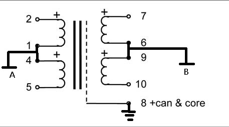

I looked at the data sheet and believe on the input side the two primary windings should be hooked up in parallel. ( 2 and 4 connected ; 1 and 5 connected.) positive phase connected to 2/4 and negative phase to 1/5.
Alternately 1 and 4 could be grounded and positive connected to 2 and negative to 5.
On the secondary side the center taps (6,9) should be grounded as you mention in previous post and plus output connected to 7 and negative phase to 10.
With a gain of 4x the 2V RMS from DAC should be raised to 8V
what sort of signal you are using ?
ballanced ,symmetric , non-ballanced ?
if you use primaries connected in series , with CT grounded at signal side , and secondaries in series - with their CT connected to gnd at receiving side .......... you'll have both perfect symmetric balanced ........ and gain of 2:8

well , sometimes is nice to use xformer to get rid of absolute DC offset , as is case with diff. DAC chip output
several times I found that solution better than Jfet buffers with caps in signal route

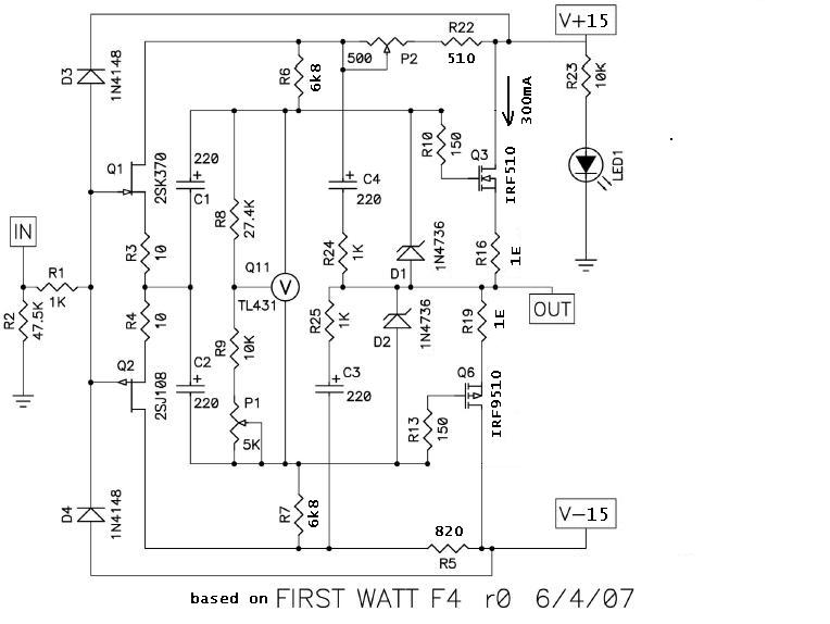

With your schematic as reference would it be possible to connect transformer between junction of R4/R3 and junction of C1/C2.
I would use Jack Ellianos PVA2-N as generg favored it in post 23 of MAGMA thread - http://www.diyaudio.com/forums/pass-labs/188109-introducing-magma-front-end-ba-2-f4-3.html
I believe it could also be wired as an autoformer. Cost is nice as 4 of these would be less than the Lundahls

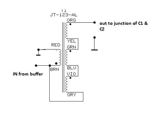

for your balanced F4 can iteration , you need xformer with center tapped secondary , or in other words - with two section secondary
either that , or using one xformer per leg ...... which isn't smartest thing if you can choose
I don't know does PVA2-N have CT secondary
buzzforb - thanks for info
Choky - I understand your belief that best sound comes from one magnetic circuit
Nelson - thanks for recommendation - a couple of questions if you don't mind - remember it takes time for this to sink in my brain
Are you recommending one of the Jensens in each of my R-, R+, L+, L- legs?
Can they be connected at junction of R3/R4 (input) and junction of C1/C2 (output) on the F4 board?
I think wiring as a autoformer is grounding brown lead, connecting red and orange and using that as input, connecting yellow/ green, connecting blue/violet and using grey as output (ref http://www.jensen-transformers.com/datashts/123alcf3.pdf)
Thanks again to all and for anyone looking for a headphone amp - a balanced F4 is at the top of my list
two things , unfortunately :
1. I'm not Pa
2. yes , with Jensen , being xformer sans CT secondary , you must use one per leg
3. looking at schm you posted in #3390 , connection is like attached :
4. #3 and #4 are just to confuse you , considering two things mentioned :devily:
