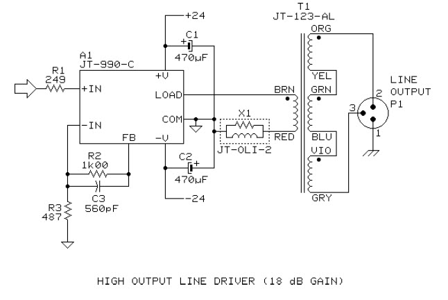

Hooked up the 4 Jensen JT-123-ALCF transformes wired as Nelson and Choky pointed out in posts 3399 and 3400 to my F4 headphone board.
I lifted R3 and R4 on the version 2 boards currently in the DIYAudio store on the cap side. I connected both leads to the transformer input (grey/brown)
The output was connected to the F4 board where R3 was lifted and the ground was also connected to the F4 board.
The sound is absolutely superb !!!! 😉😉 Have listened to Etta James, Eva Cassidy, Nina Simone, Phoebe Snow, Judy Collins, Doug McCloud, Laura Nyro and Van Morrison. Voices are amazing as is sound stage. Plenty of detail and outrageous bass. No problem driving the my HiFiMan 500s
Thanks Nelson and Choky for the help. Choky I see why you like the M2 !!!
