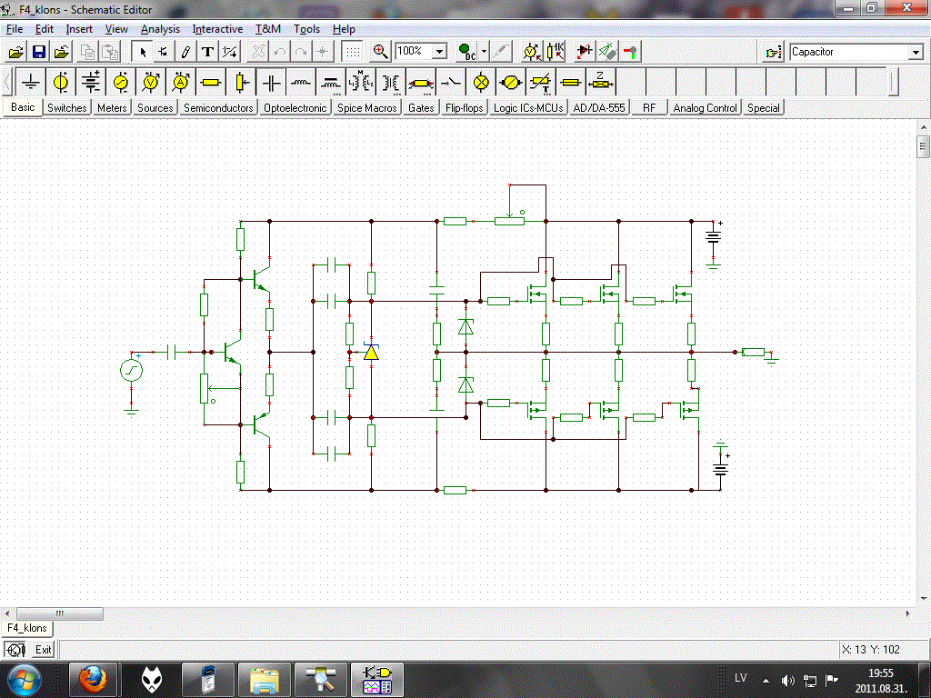

Hmm, would bipolars work in frontend? Made a quick sketch, and in simulation it works..
Oh,input is wired to wrong NPN, actually it is at other NPN's base

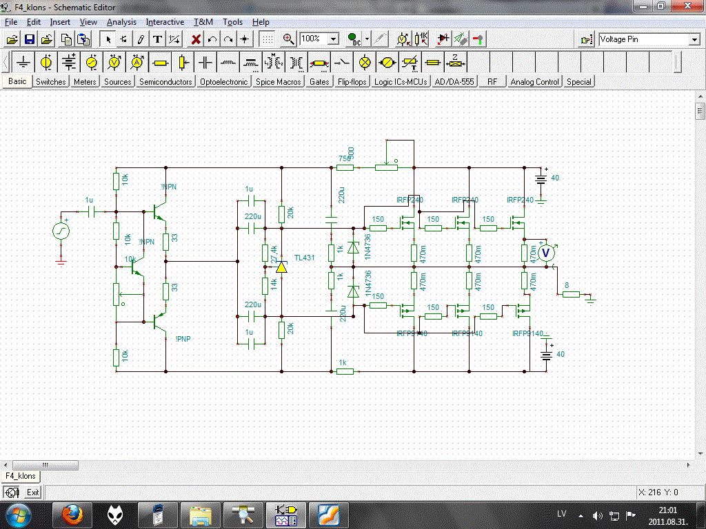

EDIT: Added picture.. Estimated values of components. Also, I think I could wire NTC in series with bias regulating pot ( 14k resistor in diagram),so bias current doesnt drift.

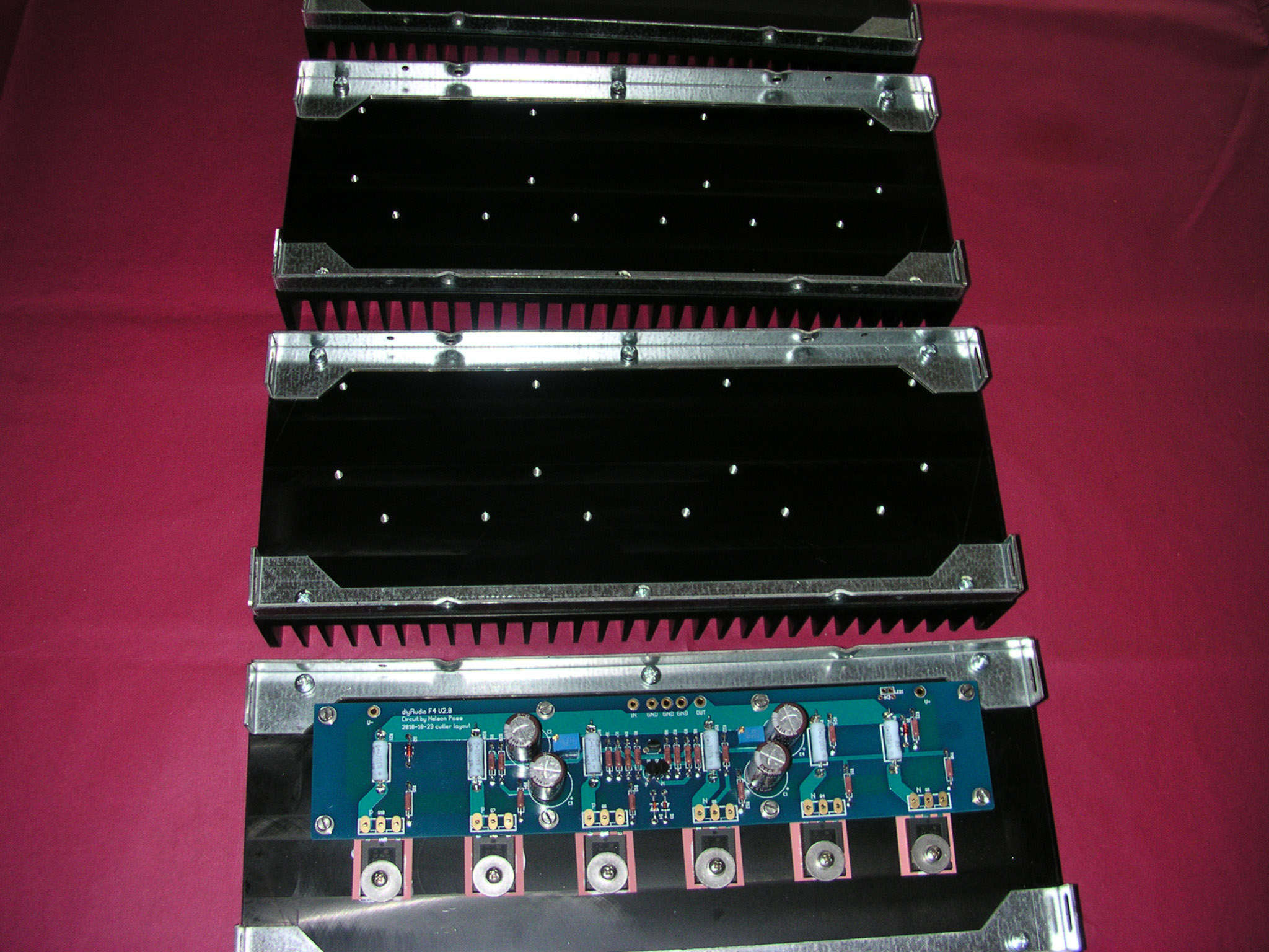

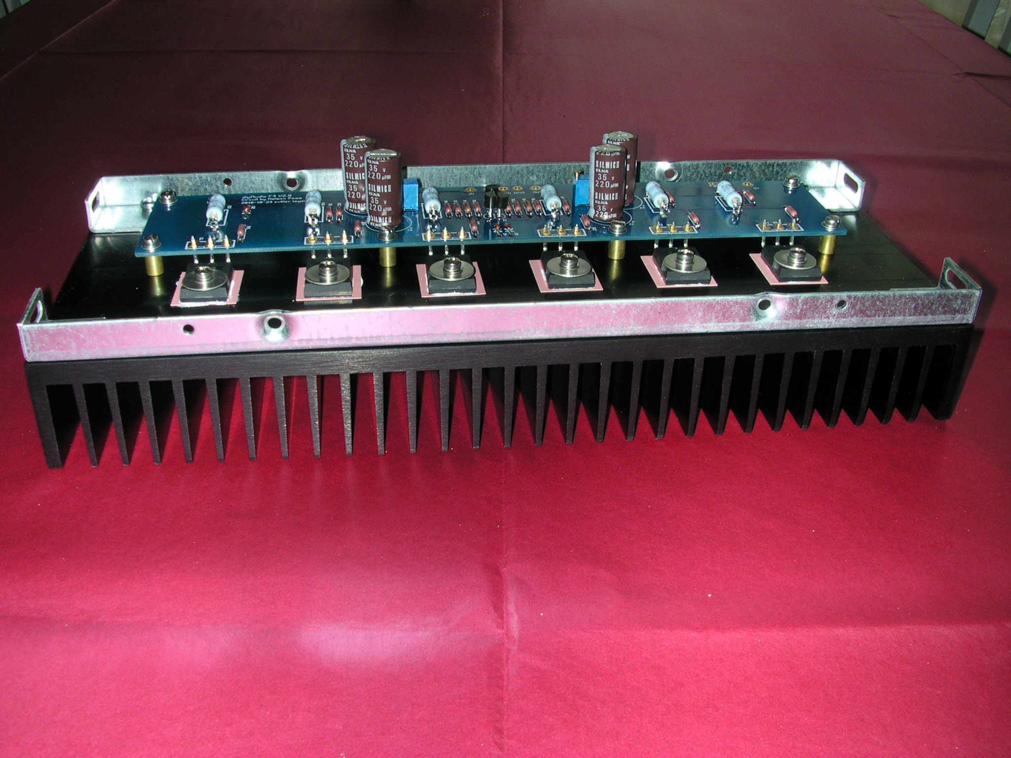

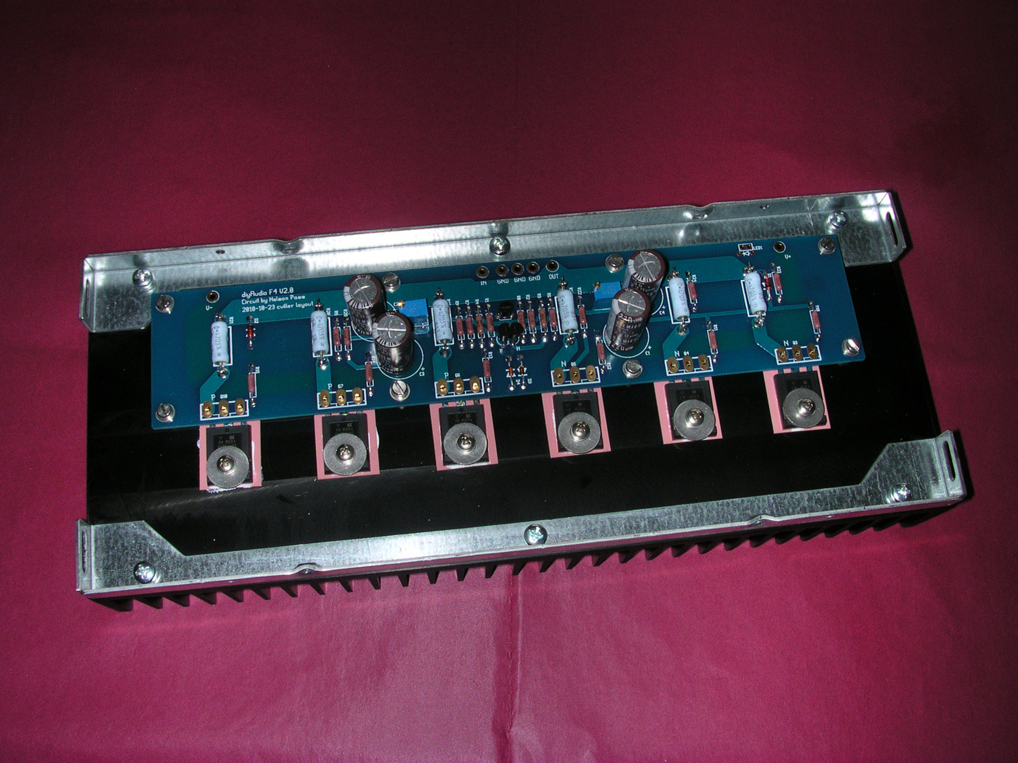

F4 photo's
Quick update on our build. We are using the 3u 300mm all aluminium cases from Hifi2000 in Italy. Jaap has finished drilling, cutting and filing holes in the back covers and has installed the cinch and XLR inputs, the speaker binding posts and the power entry modules. He has done a beautiful job!
BTW I decided to use a power entry modules rather than a separate entry units, switches, mains filters and fuse holders. This unit switches both hot and neutral wires and has an inbuilt (dual) fuse box and mains filter. It is rated 6A, so should be more than adequate.
N.B. The case is straight. It is the lens that makes it look rather curvy
