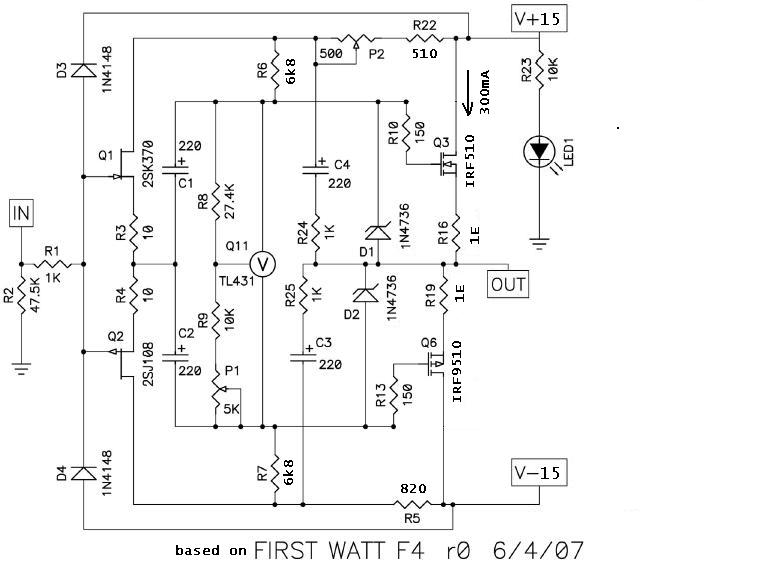

It might be too much effort to make exactly the circuit in post 3019, since this is based on the old version of F4. The boards I have made are based on papa's revised F4. But basic concept is still the same - pull out 2/3 of your mosfets and you'll basically have the same as in 3019.
EDIT: However if you are going to make a "headphone only" F4, then perhaps you should look into some nicer output fets. If you go way back in this thread, you'll see papa saying that the "mosfets are the elephants on the dancefloor".

Well I haven't researched the possibilities, but since you don't need as much current, you can use other parts - could be irf510/9510 or their fairchild counterpart. But don't obsess over this, the irfp240/9240 is great. 😉
You don't need the B1 unless you have a very weak source, long cables or want to avoid creating a low-pass with your attenuator. If you place your pot close to the F4 on the signal path, you should be just fine without the B1.

the new circuit is better as cviller says, Nelson P. comments it has a little bit less distortion and the chance to damage the Input FET´s is reduced. I wanted to show you the possibility to take less MOSFETs. But you know, you have no gain!
Some people even reduce the value of the source resistor, when they reduce the number of mosfets.
Maybe 0,33 Ohm are more suitable (I don´t know if it matters really).

there is already floating , somewhere in this thread - schematic of bastardized F4 for cans ;
as usual - butchered by Modesty ZM

There is one issue to consider when downscaling NP designs such as this. If you look at the capacitance curves of most of the output MOSFETs we use, they really go crazy high at low D-S voltage. That is to say, they are non linear and much greater, below about 20Volts. This is likely true for the smaller FETs we might consider also. If you lower the rail voltages to downscale, you are entering into that difficult non-linear area at lower signal levels also. Keeping the 23V rails and only reducing current, or the number of FETs will avoid this phenomina.

bootstraping parts - whatever ; I think thatwill hardly feel difference
try like this - and put bootstraping caps to output , if you like
No I don't think Pumpkin will feel any difference 😎...but F4 might...the bootstrap will improve PSRR quite a bit 😛
