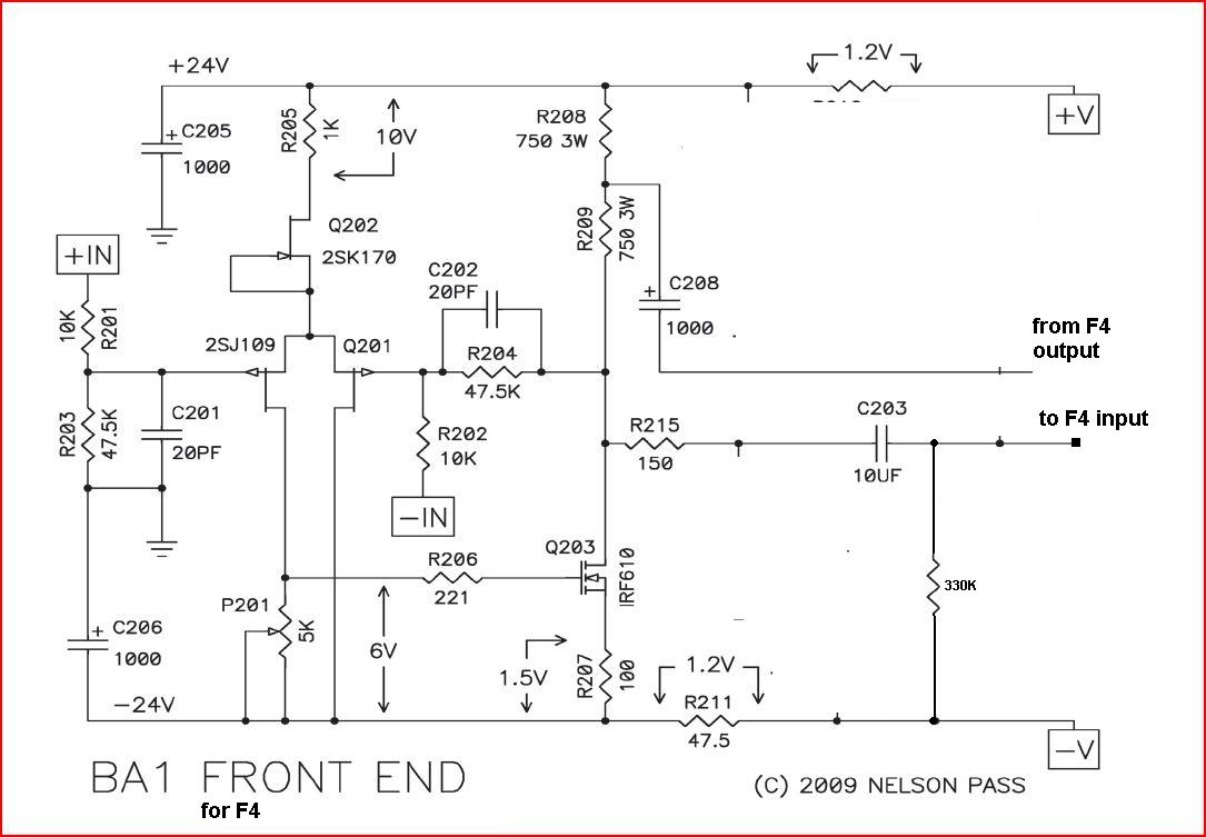

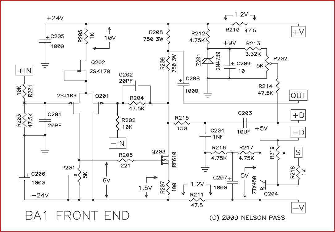

I have been studying the BA1 front end. I have a question...If I wanted to try and breadboard up this front end and use in conjunction with a stock F4 can I omit the + and - bias circuitry and simply use +D as my output?
Basically, RCA in => BA1 +IN => +D => F4 IN.
If I were to omit the bootstrap section would there be any need for R208 & R209 or would this be worth implementing?

try like this
leave bootstrap as is
Thank you Zen Mod! So I was "barking up the right tree" then...I was thinking that since the F4 already has provision for bias and DC Offset that this was the case.
