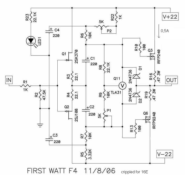

F4 as a headphone amplifier
Hello
I have started building my second pair of F4 on Villers PCB. This time I intend to try out how it will work as a headphone amplifier for my AKG K701.
I do need some adwises form someone with a better electronic understanding than myself about (still running in classe A):
Power voltage (lower than +/- 23 V if possible) and bias per device.
Preamp will be B1
Specifications AKG K 701
Type: Circumaural, open back headphones
Efficiency: 105 dB SPL /V
Maximum input power: 200 mW
Impedance: 62 Ohms
I have a lot of 220uF/16 V cond. Can I use them as C1/C2.
What about C3/C4?
Sincerely
Eivind Stillingen
You can run the amp at lower bias when your load is 62 ohm - but sounds like you already know that.
You can use the 16V caps on C1 and C2, but it might be a good idea to lower the voltage too. C3 and C4 will see a higher voltage, so you need to be careful with those. If you don't plan on using any gain, then you can lower the voltage quite a bit and still have plenty of swing without clipping.

F4 as headphone amplifier
generg
You wrote:
".... do you know this version of F4?
Could be enough for your headphone".
Do you mean that this can do the job alone, without B1 as "pre"?
How do I fix a volumecontrol?
The PCB I use is from cviller. Here is the schema he use:
http://www.diyaudio.com/forums/blogs/cviller/198-my-f4-guide.html
As you can see, it is a little bit different from the version you show me. If I go for that version, as far as I can see, I have to keep Q3 and Q6 on cvillers PCB board and skip out the rest of IRF240/IRFP 9240? Will it be nessecary take away all 0,47/100 ohm resistors or can they stay (that will be the easiest way)??
D3/D4 out?
What about P2: 500 ohm versus 5 Kohm
R5: 1Kohm versus 3,32 Kohm
R22: 750 ohm versus 1 Kohm
