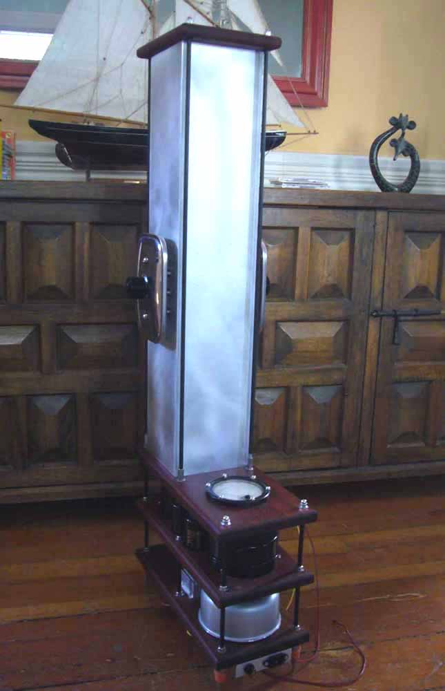

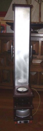

OK It isn't fired up yet in this rebuilt version, but it HAS been fired at Burning Amp so I doubt there are major complications.
I was striving for the "mad scientist" look something that might have been in a lab many years ago..
The lowest level has the toroid ransformer in the silver can , and the small heatsink has the diode bridges ( IXSS)
On the second level the black cans are chokes, so it has a pi supply: Caps-chokes-caps. The actual amp circuitry is under the side covers of the the "stack" The stack is 6"x6"x 3/16" aluminum tubing. In some photos you can see 3 of the 6 MOSFET's per channel
Total height is 44" (115cm) tall . A lot of amps end up on the floor, why not make 'em tall with a smaller footprint?
Anyway, just a bit more to go- (such as move the power cord to the rear) and neaten up the wiring so it will last...
Mark
Mark
Variac said:mad scientist
Nemo would have been proud.
Thanks guys! I will post a couple more photos taken outside so there is more light, and some close-ups, when they are finished.
