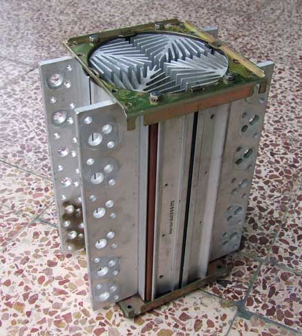

nope ....... I'm in small league ;
I have just this one :
