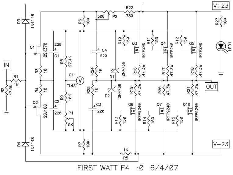

Folks, I seem to have a hard time finding the 22.1 ohm resistor. I've searched around in the forum, and found a thread which taugth me that these "strange" values are there just to remind you about the needed precision (hope I got it right).
Anyway, I can't even find 20 ohm resistors. I found some nice parts rated at 10 ohm, 0.1%... Well, I was wondering if I can put two of those in series, to satisfy that R8 value.

giacomo_pagani said:I seem to have a hard time finding the 22.1 ohm resistor.
10x 221 1% in parallel gives 22.1 ohms 1%.

Hi Giacomo
There has been a lot of discussion in the past about versions of the circuit that different people have used.
I believe the latest was the one marked r0 6/4/07. Thats certainly the one that I used and if I remember correctly there were no 22R1 on that circuit. Maybe why Jacco is questioning R8.

Uh... I'm referring to the R8 which is shown in the actual PDF on www.firstwatt.com
I downloaded it again a few days ago... What am I missing?

Ops, the 22.1 ohm resistors are R4 and R3, not R8, sorry.
Luckily, Jacco has been very kind and the problem is solved... Thank you, mate.

Looks like the earlier (11/08/06) version has snuck back up on www.firstwatt.com.
The latest version was referred to as R0 and dated 6/4/07

OK, I searched and found that this last version is better, period (being recommended by Nelson, and being the one on Peter Daniel's boards).
And I'm lucky with parts, too (except for the 750 ohm resistor, but I'll stick with two 1.5 kohm in parallel).
