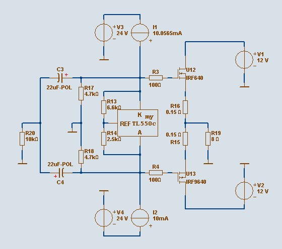

Nelson Pass said:
From the Texas TL431 datasheet
This device contains 12 active transistors.
Which makes one original F4 amplifier have:
- 2 JFET, for input
- 12, mostly bipolar, transistors for Vbe multiplier control
- 6 HEXFET for output
My attachment is one of my testvariants of F4 setup. Simulation data are good! 😎
The TL550C, is my own working clone spice model of TL431.
Done with discrete BC550C + BC560C.
My clone uses 11 transistors. The 12th they mention, I do not know about ....
Anyway, my TL550C works. Regarding setting keeping precise voltage.
In reality it wouldn't. Because the bandgap is set up to fit IC chips transistors.
Not BC550C / BC560. There would be a temperature drift.
In this picture I used IRF640/9640, '
but of course we should use something more heavy:
The original IRFP240/9240 should be our first option!
🙂 My circuit uses 2 current sources, at 10 mA. (Could be raised a bit).
The upper CCS is adjustable for DC-offset trimming.
🙂 I also very much prefer separate voltage supply. for input / output.
This is an option many forget .. because commecial amplifiers reduce production cost (for maxmial profit)
by ONLY put in 1 Transformer.
A little transformer with, say 5-10, higher voltage, say 10 VA is a small cost.
This is to minimize un-wanted 'feedback' distrubance in power supply rails.
From output to input side ..
also of course we can use a very precise regulated input supply.
We also may have a better pwerformance before output does clipping.
Regards
lineup 🙂 just another of all doing clones from Master Nelson stuff 😀

when i started my F4 for the first time i could only adjust the left channel to 250mv the right channel i could adjust to 300+-so i set both at 250mv and set the offset,when the amp warmed up i could get 300+ out of the left so i reset both to 300mv and reset the offset then ran it for 6 hours--when i went to shut it off and was by the speakers i noticed a hum from both channels--i put it back on the bench and the right channel was 450mv!(left had drifted up slightly but not like right) and the offset on both channels was off.i left it off for a couple days and started over today-could only get 250mv out of the left again-i let it warm up and they have drifted up to 275mv and the right offset had to be reset 2 turns-but what gets me is that there was no hum when cold and now that it has warmed up it hums again-would someone please give me some advice!!!-mark
The FW version is set at a cold bias of 300 mV and over the course of
an hour or so it drifts up to about 400, at which time the bias and
offset are trimmed. Then it is checked again after a day or so.
Your results will vary depending on the effectiveness of your cooling.
thanks nelson!! hum is slight but i was wrong it is there when cold-just couldn't hear it over the buzz of the fluorescent lights in shop. got the big conrad heatsinks-it takes several hours to come up to 105F. i assume the hotter the heatsinks run the more the bias will drift up?
