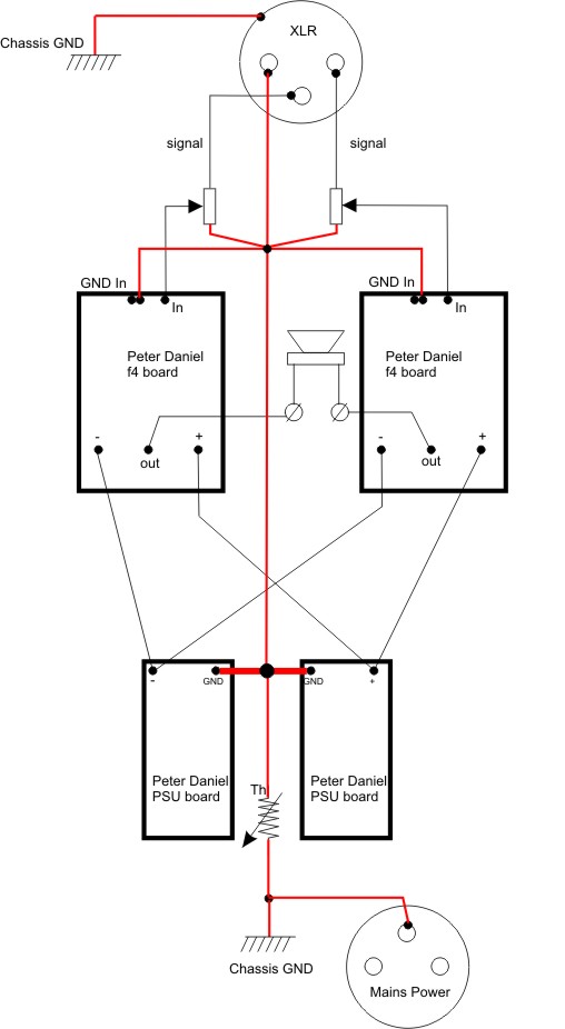

Hello,
I would like to share grounding idea of my ballanced f4. Peter Daniel helped me, thank you very much, Peter, so I hope attached drawing will help some of novices too.
Wishing Nelson quick and full recovery,
Andrzej

looks good. What are the things that look like pots in the diagram on the input?
why does the case of the xlr go directly to chassis ground and not through the thermistor ? and don't some xlr connectors have the xlr case grounded to pin 1 internally?
The thermistor isolated chassis ground from mains ground, unless there is a short. You want the signal ground connected to the star ground and only one connection to mains ground.
You really do not want the XLR case connected directly to the signal ground. This could cause a ground loop.
