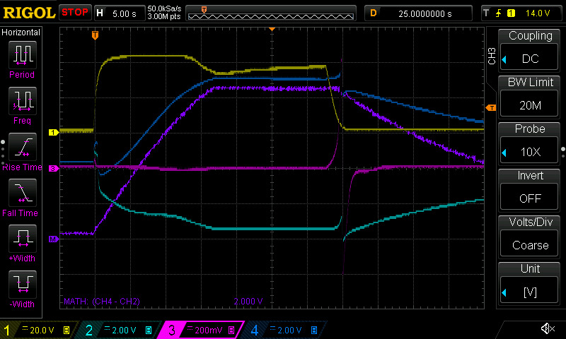

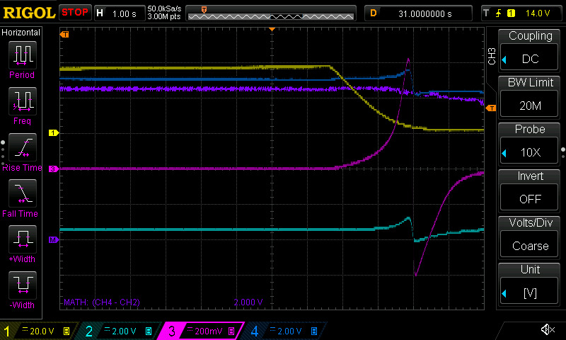

ZD25 power-up power-down waveforms
Today I made some measurements of my ZD25, which is similar to the XA25. The measurements were:
  • CH1 (yellow): VF+
  • CH4 Violet: Drive+
  • CH2 Cyan: Drive-
  • CH3 Pink: Vout
  • CH4-CH2 Blue: Drive+ - Drive-
The Rigol scope screen dumps are as follows, left to right:
  • Complete power-up and power-down sequence at 5 secs/div
  • Power-up pulse at 0.5 secs/div
  • Power-down pulse at 1 secs/div.
I have not yet attempted to look at this behavior in LTSpice.
The start-up pulses shown in my previous post will not cause a speaker thump because the output FETs do not start conducting until about 13 seconds after power is applied, when VF+ (the yellow trace) declines about 6V.
This behavior must be considered when evaluating the servo designs.
