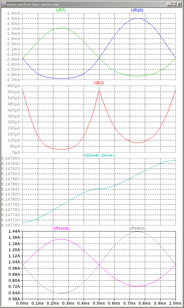

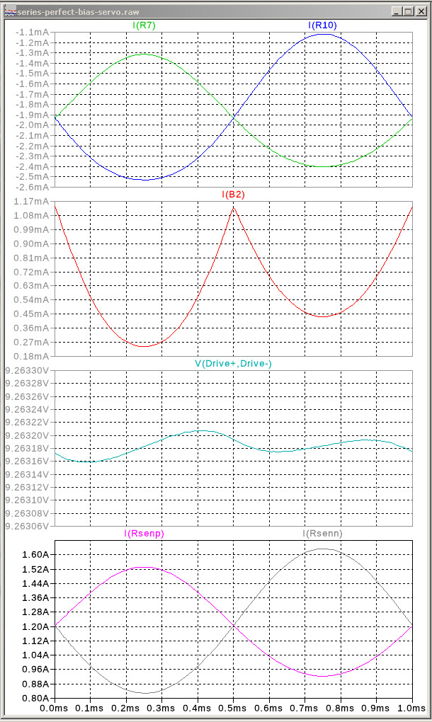

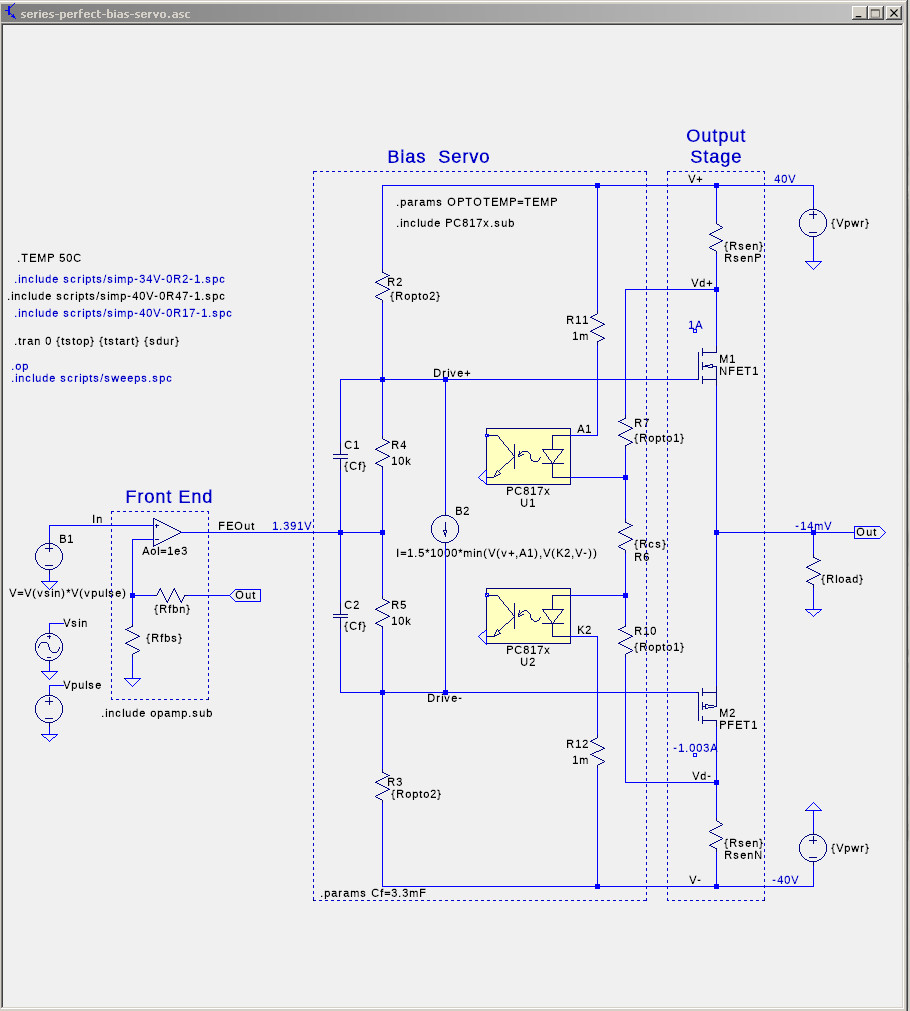

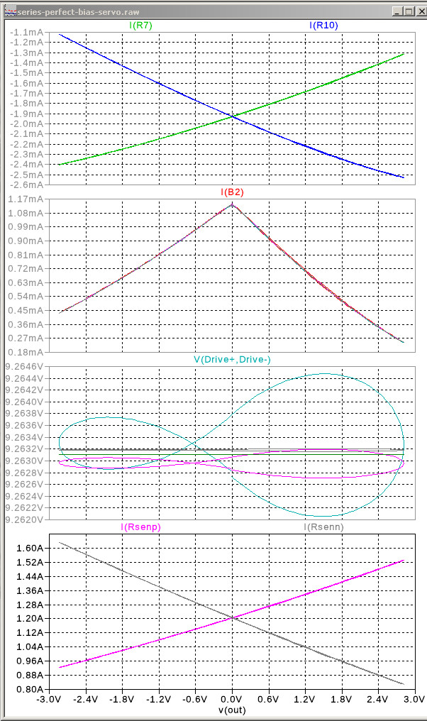

Here is a simulation where a "perfect" arbitrary current source replaces the series opto outputs. Because of SPICE limitations, a compute the LED currents from the voltage across 1m resistors connected to the rails.
The plots are:
- waveforms vs. time of a 1kHz 1W signal into 4R from 0 secs to 3 secs.
- 1 cycle of waveforms vs. time of a 1kHz 1W signal into 4R at 0 secs.
- 1 cycle of waveforms vs. time of a 1kHz 1W signal into 4R at 3 secs.
- 1 cycle of waveforms at vs.V(out) at 3 secs of a 1kHz signal in to 4R at 1W, 5W and 25W.
- 1 cycle of waveforms at vs.V(out) at 3 secs of a 1W signal in to 4R at 20Hz, 100Hz, 1kHz, and 10kHz.

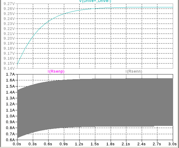

Isn’t the “big jump in bias current” at startup the result of C1 and C2 being charged by R2 and R3 respectively? I can see the caps are large values but I don’t know the resistor values so cannot determine the time constant.
Another observation is that this kind of bias circuit produces its “output” as a current whereas ideally the bias generator would provide a constant voltage, i.e. at low impedance. Not sure whether this is a problem though given the presence of the two capacitors.
No, SPICE computes the initial DC state, which includes the correct voltages across C1 and C2, before starting the transient waveform computation.

If that is the case, doesn't it suggest a problem with the steady state, I.e the output FETs are not conducting equally?

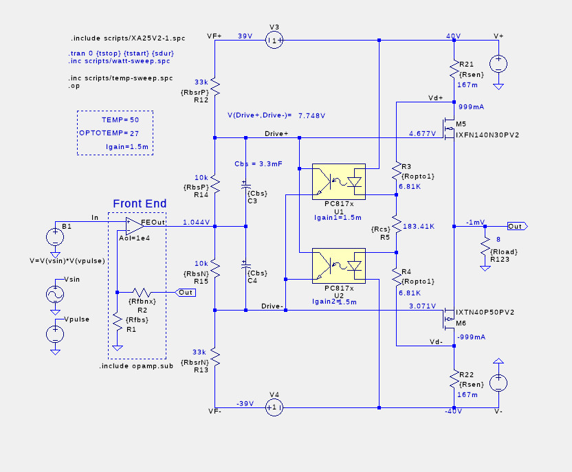

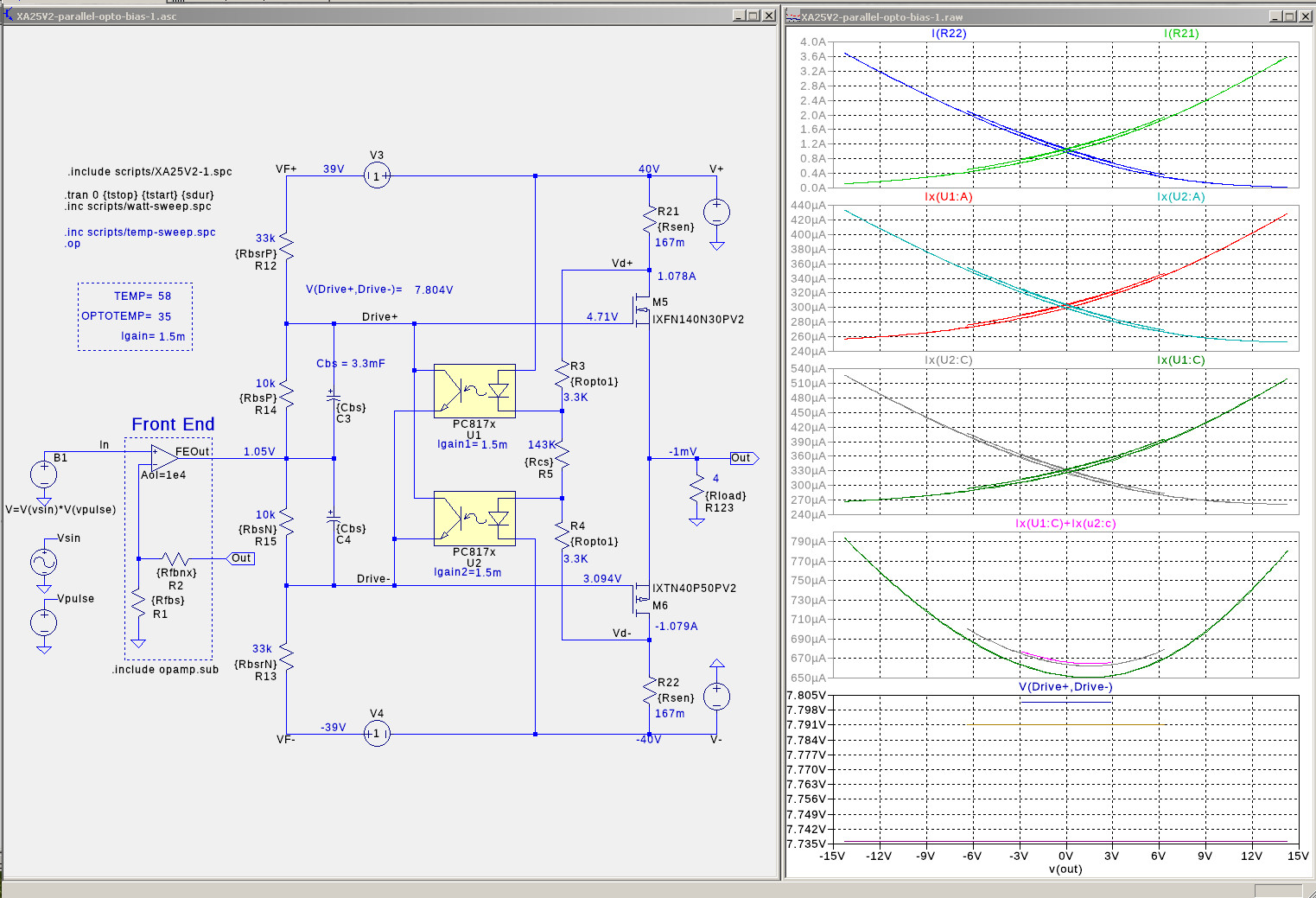

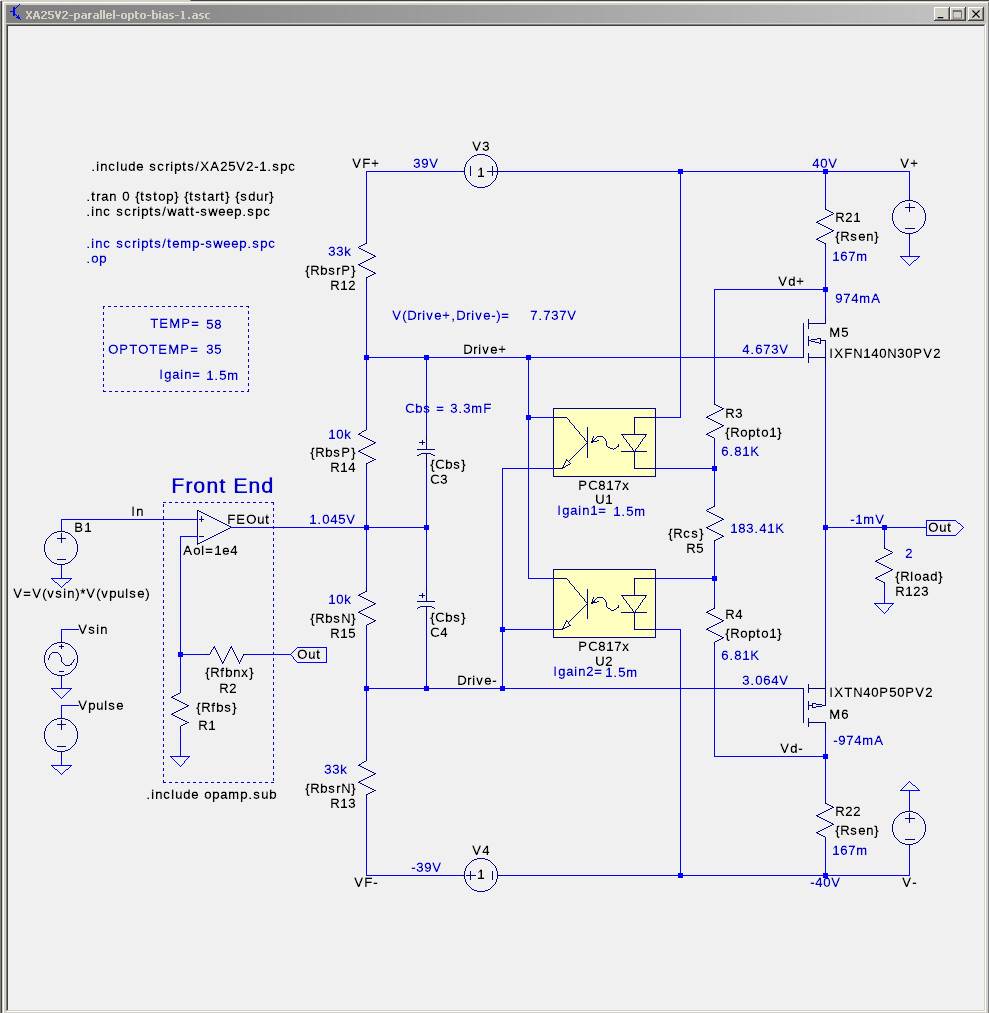

parallel optocoupler output bias circuits 1st try
Switch just two wires in the series opto output circuit and you get the parallel opto output circuit. Here is a first attemp using resistor values similar to those in the series opto circuit. The first plots (2nd image) show the waveforms vs Vout for 20Hz, 100Hz, 1kHz, and 10kHz. Wow, this looks pretty good until you look at the last image showing the 1kHz waveforms at 1W, 5W, and 25W. The bias levels decrease significantly with wattage increase.

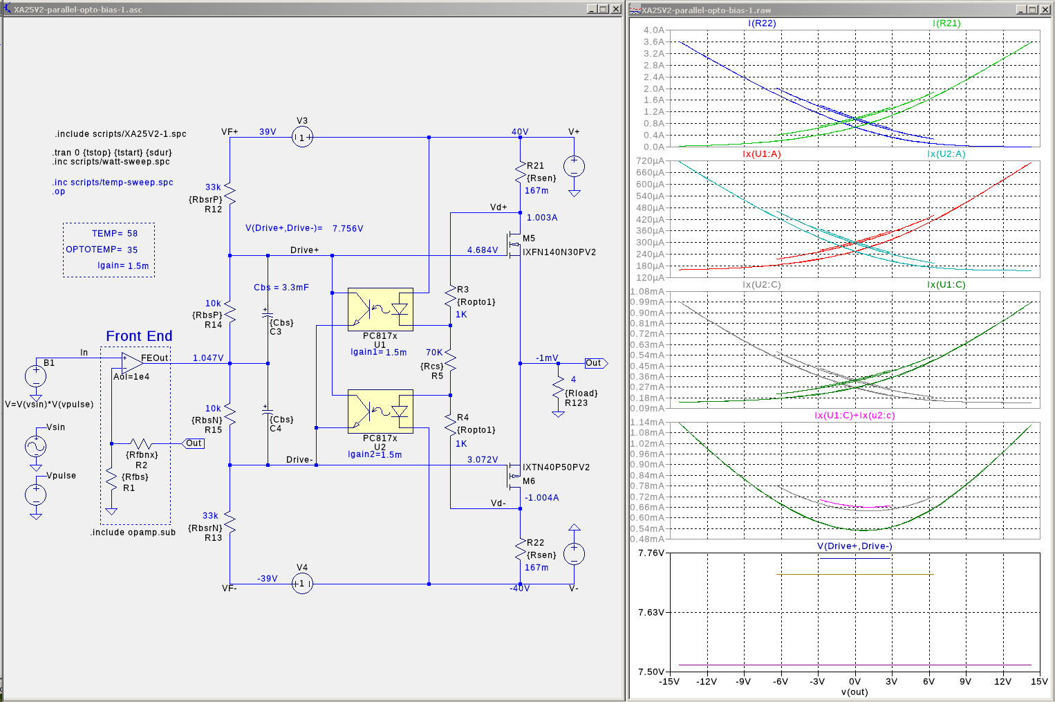

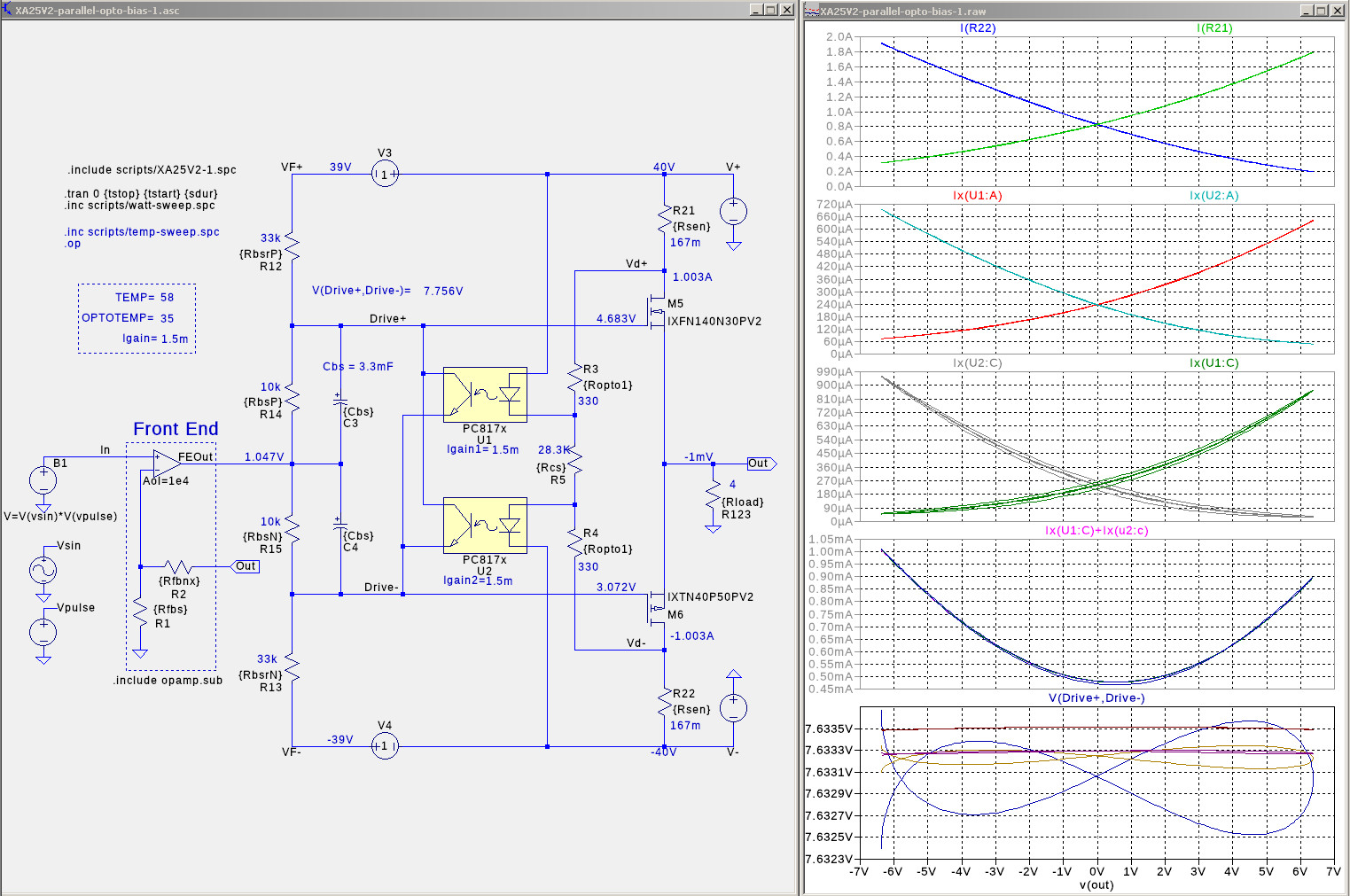

parallel optocoupler output bias circuits 2nd try
After increasing the resistor values significantly the sensitive to wattage is reduced, but not eliminated. The sensitivity to frequency (not shown) is not noticeably changed.

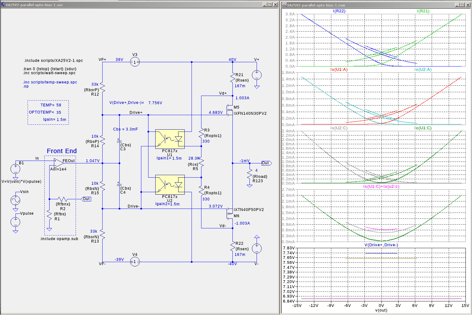

parallel optocoupler output bias circuits WOW!
After considerable experimentation I arrived at values the significantly reduces the sensitivity to wattage.

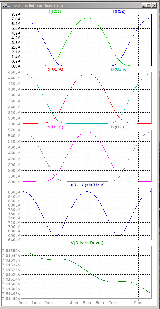

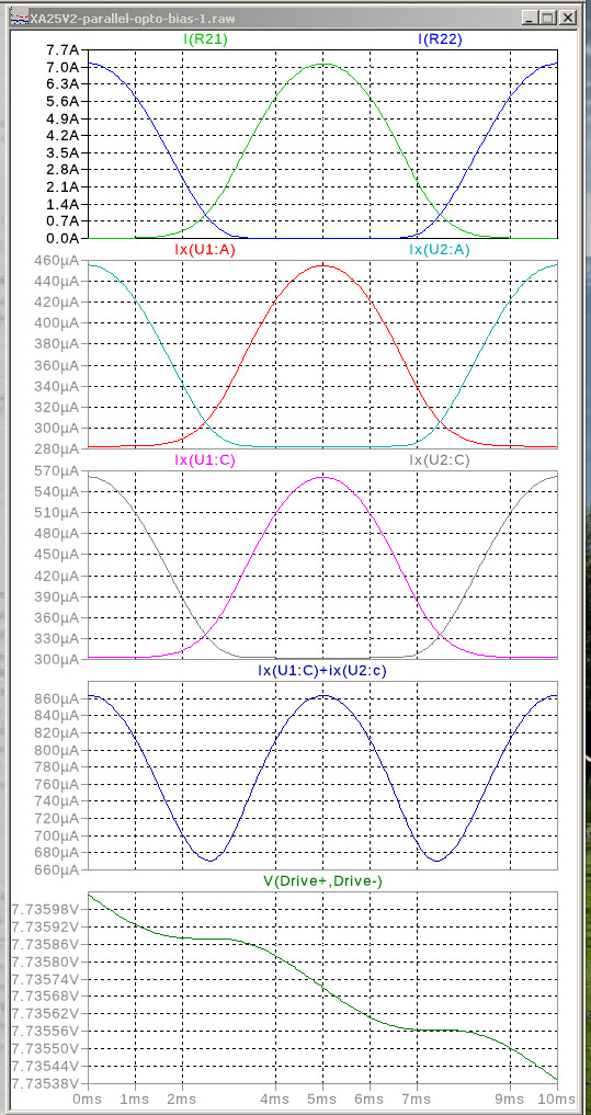

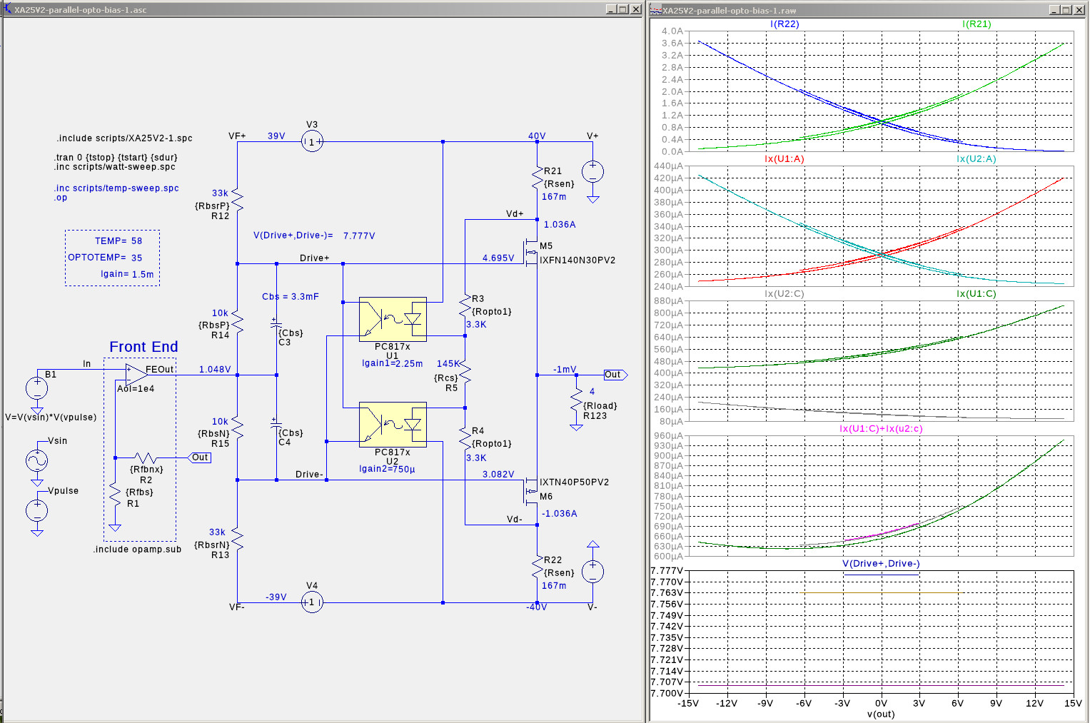

parallel optocoupler output bias circuits opto CTR mismatch
Here is something I did not expect. The parallel opto output circuit is rather insensitive to current-transfer-ratio (CTR) mismatch. Show are the waveforms optos whose CTRs differ by 3:1, but have the same CTR sum. If the sum is not the same, the Rcs resistor, which should really be a pot, must be adjusted.
You can see that the Ix(U1:C) and Ix(U2:C) transistor collector currents are now very different, and the Ix(U1:C)+Ix(U2:C) waveform is somewhat hifted to the left, but otherwise the waveforms are about the same as with matched CTRs. I did not expect this result.

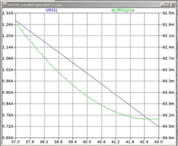

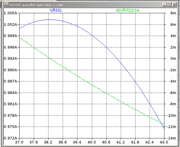

parallel optocoupler output bias circuits Rail voltage sensitivity
Here are some plots of bias current vs. rail voltage and its derivitive (dI/dV). The first plot corresponds to the "1st try" circuit values whose bias current vs. Watts was quite bad. The 2nd plot was for the "2nd try" circuit. You can see that the higher resistor values decrease dI/dV (magnitude).

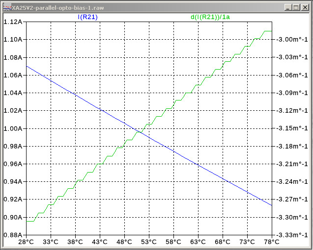

parallel optocoupler Rail voltage and temperature sensitivity - WOW!
And here the rail voltage sensitivity is nearly zero. And the final plot is the temperature sensitivity of the same circuit.
How believable are these simulations? The models used for the FETs and optocouplers are only approximations. The relationships between FET junction temperatures and optocoupler temperatures best guesses and are dependent on packaging, ventilation, and the phase of the moon. The values of Ropto1 and Rcs are the only adjustments available, but they should get close the the "optimal" results.
Well, you have certainly given us plenty to think about!I’ve only had a quick look but I still have many questions. I’ll start with what I see as the key points and follow up on the other points later.
As an aside, this is a very similar circuit to the one I was experimenting with some time ago although I used a current source in place of Rcs (R5).
Increasing the values of Ropto1 decreases the sensitivity of the bias generator to changes in the current flowing through the FET output devices. As you have shown this is beneficial in reducing the sensitivity to changes as more signal related power is delivered to the load. However, I would expect larger values of Ropto1 to also negatively impact sensitivity to changes in the (bias) component of the output current that we are interested in keeping constant. Curiously your results of change in output current with varying supply voltage appear to contradict this so maybe I am wrong.
In any case, I anticipate the issue of reducing bias to return if the output power is increased further. Nelson addressed the same issue rather elegantly in the M2 with the addition of the LM385s. Perhaps a similar solution is required here?
Are ypu asking whether increasing the values of the Rcs and Ropto1 resistors results in lowering the negative feedback of the bias servo and if that results in poorer control of the bias?...
