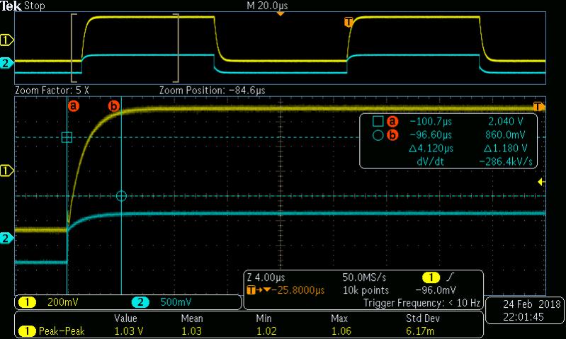

The input capacitance of the OPS is causing the 50 ohm sig gen to slew. Here is a measurement of the rise time portion of a 1kHz square wave. Blue is the sig gen output and yellow is the output of the pucks.

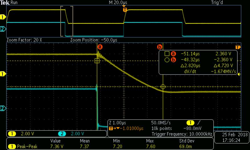

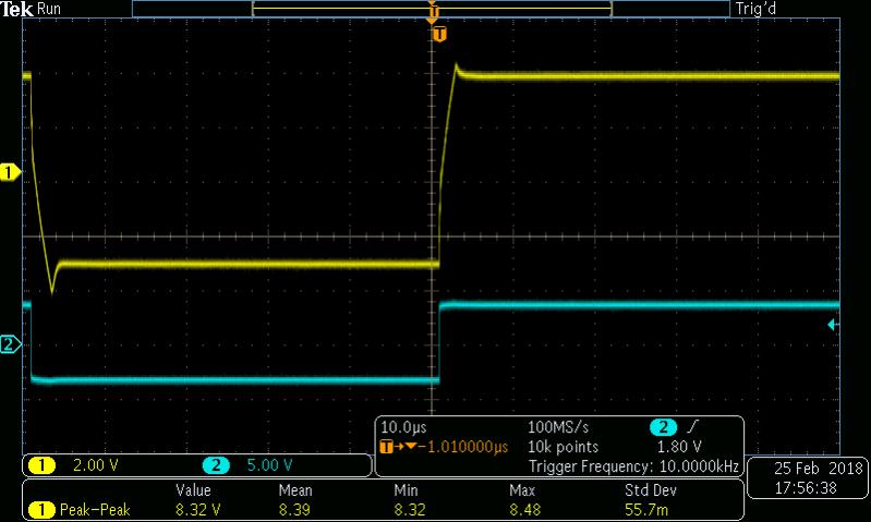

Attached is a capture of the breadboarded F4 passing a 10 kHz sine wave. The load is a 47 ohm power resistor. You can see the output slewing.
The second capture is a zoom-in of the falling edge. There is ringing at the onset of the falling edge. The slew rate is about 1.7 v/ uS.

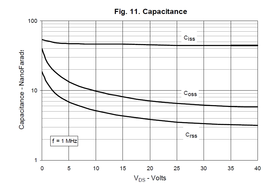

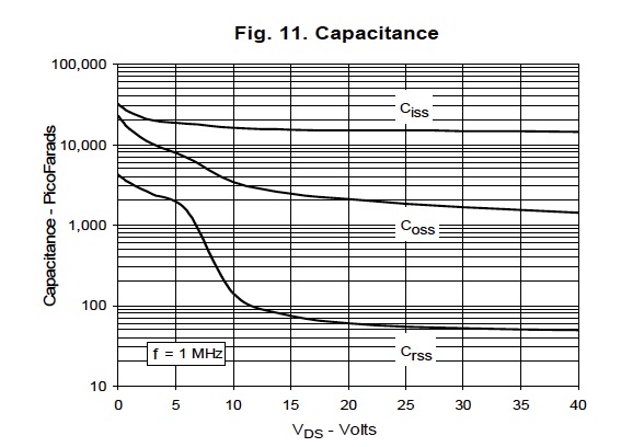

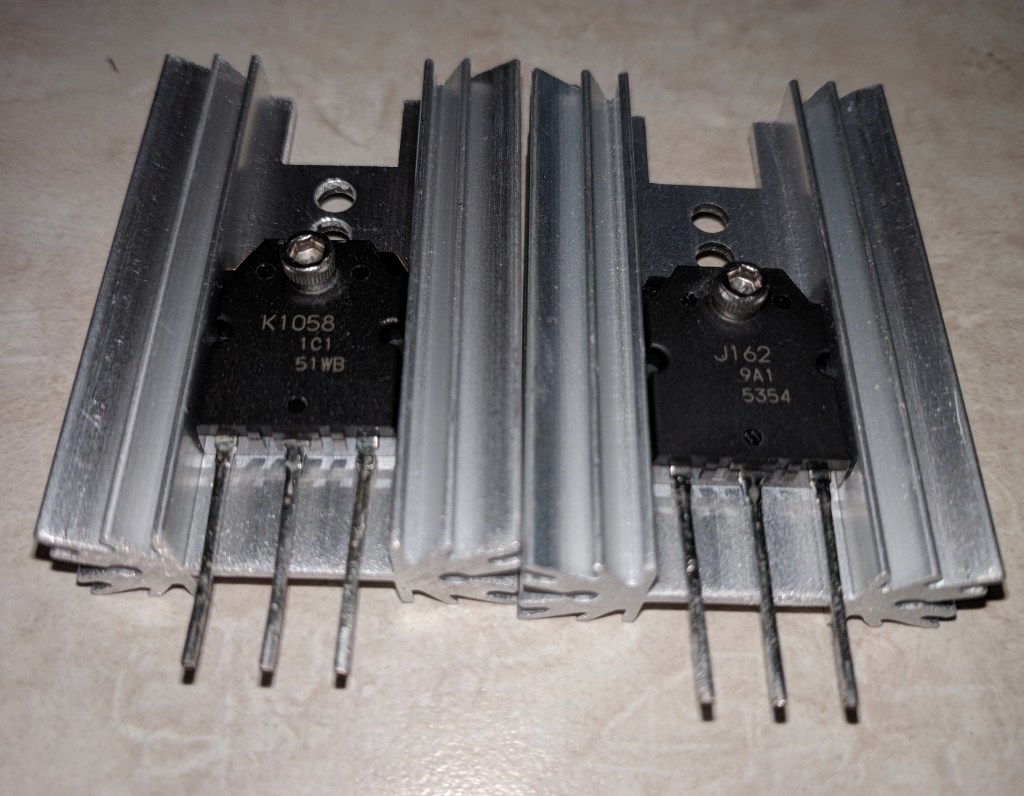

The N-channel puck I chose has a Vds max of 40v. The Ciss is fairly immune to voltage and is a steady 45 nF pe the datasheet.
I will fire up the LCR measurement gear and see what I can measure.
Another thing I can try is to hook up a Crown DC 300A to drive the pucks and see if that produces a better looking square wave.
As far as I know if you build a source follower the Crss is more decisive and and this one changes much with the voltage.
Attached are the curves for the n-channel puck capacitances. Crss is the lowest of the three and at 24v, it is close to its lowest value. It looks like I will have to deal with it as it is. It will get worse if I drop back to 12V. For this application, I do not see running the OPS higher than 15V.

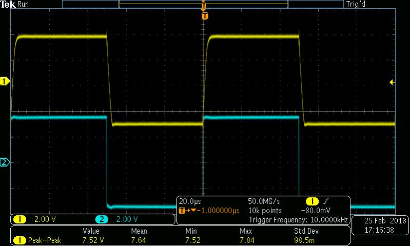

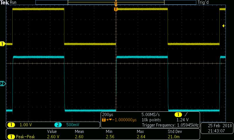

In the attached scope shot, the yellow signal is the scope probe comp signal driving a commercial amp. The commercial amp is driving the F4 beast OPS. The blue signal is the F4 beast OPS output to a 47 ohm resistor. The commercial amp has no problem driving the pucks and the pucks have no problem producing a nice square wave.
It is clear that the JFET 170/74 pair cannot drive these pucks with this topology.
Next stop is a two-stage IPS to drive the pucks.

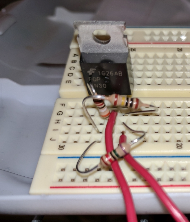

An FQP3N30 will be the bias spreader. I slapped this together and tweaked it for about 7.2V which will bias the hockey pucks into conduction.

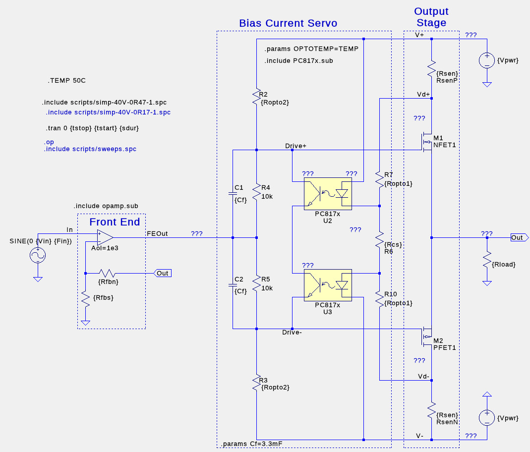

optocoupler bias circuits part 1

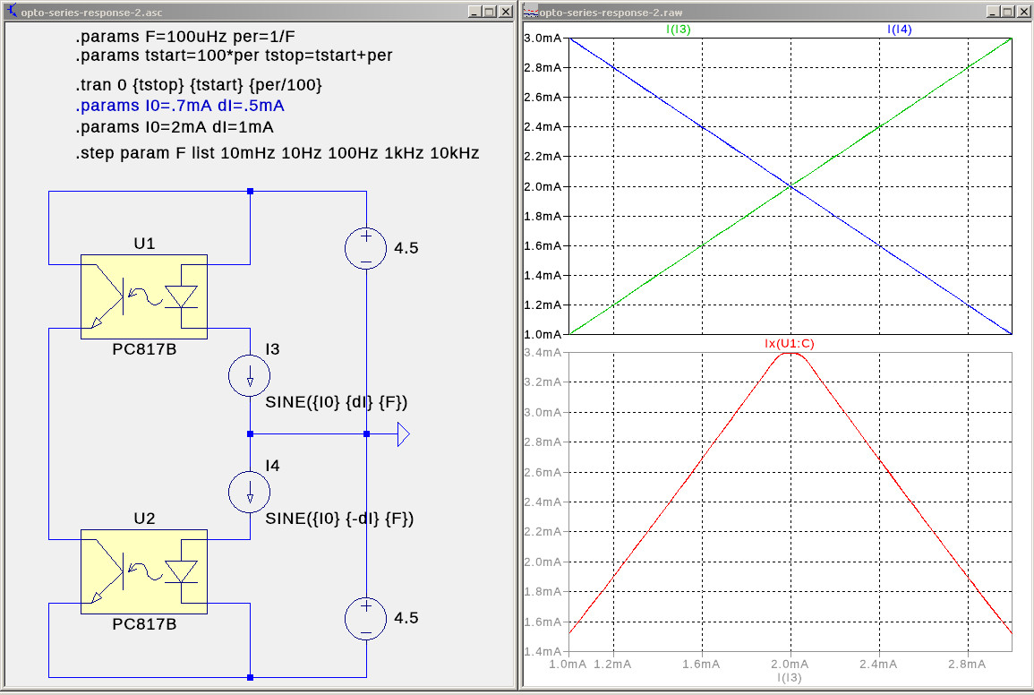

Here is the first installment on a series of posts about the behavior of some optocoupler circuits. My first post is about the behavior of the optocoupler pair with the transistor output connected in series.
The first image below is an example circuit with that topology.
The second image shows the behavior of the series connected optocoupler transistors at very low frequencies. The output current is approximately the minimum of the LED currents.
The third image shows the frequency response behavior at 10Hz, 100Hz, 1kHz, and 10kHz. As can be seen, the optocoupler time constants, mostly due to the output transistors, have a significant effect af the frequency increases.
In following posts I will show how this optocoupler tologoly affects the bias behavior of an amplifier such as the XA25.
