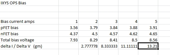

I thought I would share some measurements to show how bias current vs total Vgs works for my pair of hockey pucks.
I set up the normal test for Vgs by strapping gate to drain and then forcing a current through the OPS pair.
This will help when I set bias using the TL431 adjustment pot.
Very interesting results. I had noted in a previous post in this thread that when I had taken my hockey pucks up to a bias of 6A or more the sound changed and the bass became more defined. I think even Nelson made similar comments about the the more bias the better only if your heatsinking and power supply was up to the task. Thank you for taking the time to share your testing but I'm still looking forward to your 200Amp test though!
The pucks definitely have lots more gm at higher bias. If that translates into better sound of some sort, then you could measure the parts before the build and set the bias for the gm desired.

On a mildly more serious note, I don't suppose you've investigated vgs/temp at a particular bias level?
Yes I investigated. Mother nature made me do it.
The first heatsinks I used are CPU coolers that require a fan. The hockey pucks' bias current runs away when the they get hot.
I took the prevailing advice and bought a large, heavy heatsink. This heatsink is a much more satisfying experience. As a practical observation, having run this heatsink to very warm, set the cold bias to 1/2 of what you want at operating temperature and then get the heastsink warm with a sig gen and a load, and then adjust the final bias.
The problem is that if the ambient temperature of your listening room varies widely, the operating bias will probably be different at different room temperatures. I would recommend a torture test to be safe. For my intended ribbon tweeter use, I am not worried about destroying the ribbon if the amplifier causes a problem. I just install a new ribbon and continue.
