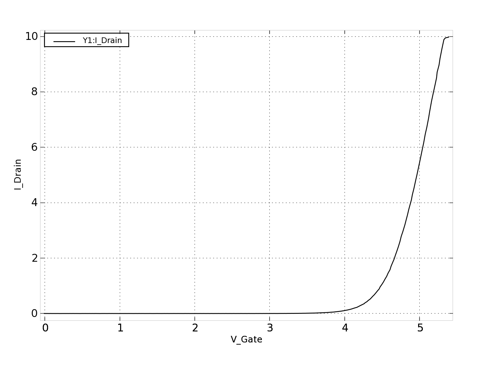

The family of curves is very uninteresting for this transistor since 99% of the usual stuff you see in these curves is well beyond any measurement rig except for one very expensive rig.
That is why I traced the Vgs - Id curve. I can see pretty much all I want to know with this curve and not have to go beyond 10A.

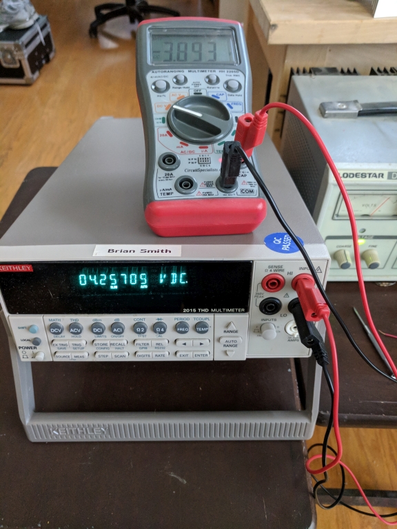

RDSon of the N-FET is about 4.1 milli-ohms.
Test conditions
Vgs = 10V applied
Ids = 1.0A applied
Vds measured = 4.06 millivolts
This measurement includes all of the FET drain and source lead lengths and a few millimeters of copper wire soldered to the FET to mount the FET in a banana plug with drain and source fastened into the banana plug. The banana plug was inserted into a DMM to take the Vds voltage measurement.
This measurement would be easily repeated by others using a DMM, two channels of power supply and one power resistor to set 1A through drain and source.
I happen to have an accurate current source, accurate voltage source and a good benchtop DMM.

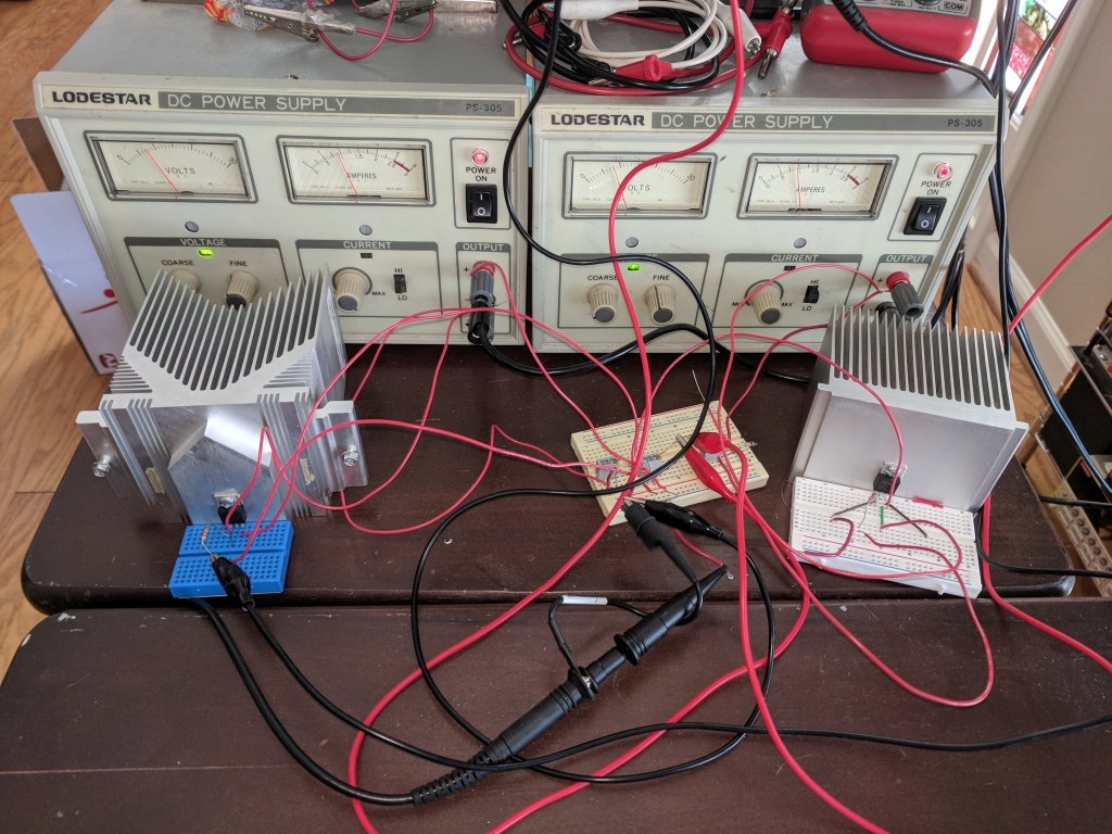

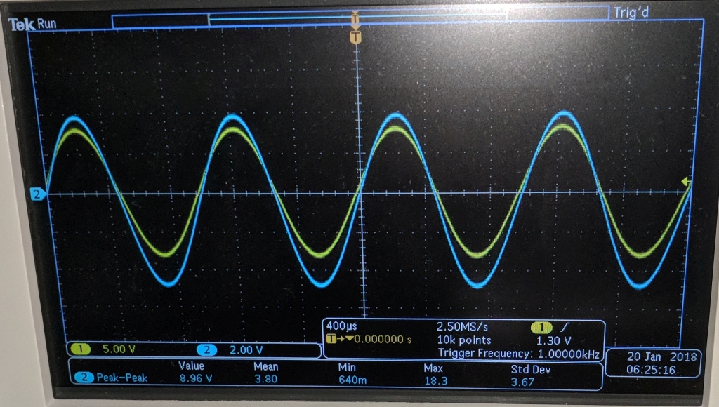

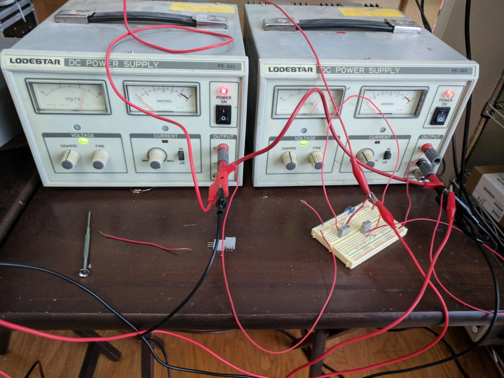

Here is the OPS rats nest. The bias is simply two resistors and two pots. Two adjustable power supplies are used.
The output load is a 1k resistor.
Power supplies were operated between +/- 5v to +/- 6V. In the scope shot, yellow is the input and blue is the output.
Messing with the pots and the power supplies, I did get the offset close to zero eventually.
Time to mount the outputs on heat sinks and break out some perf board.

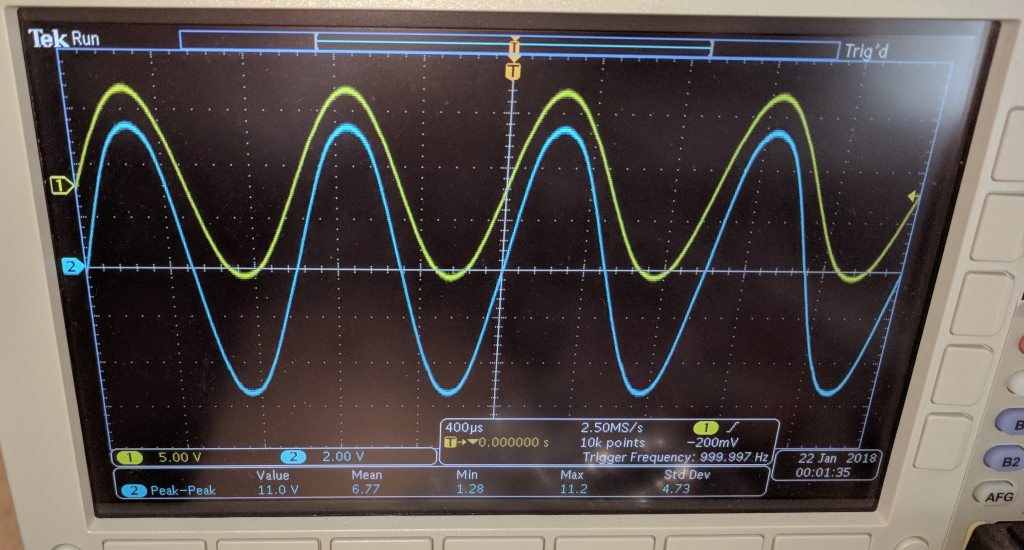

Attached are pictures of the OPS mounted to heat sinks to allow some bias current to flow.
These FETs do not like to be at + - 5V with the bias resistors on the same +/-5V. The Vgs_on of the NFET is 3.8-ish and that places the gate too near Vcc to have any meaningful voltage swing.
I changed the rails to +/- 8V and that allows the NFET to produce some output.
The sig gen craps out at 20V p-p so I cannot drive the output stage to clipping.
Looks good enough to build the rest of the amp and get it all running together.

Here is the gain curve for an IXTN660N04T4 which is a hockey puck . At 5v Vgs, the trans-conductance is 12-ish.
I have some p-channel hockey pucks on the way, IXTN210P10T. I will post the gain curve of that part as well as its trans-conductance.

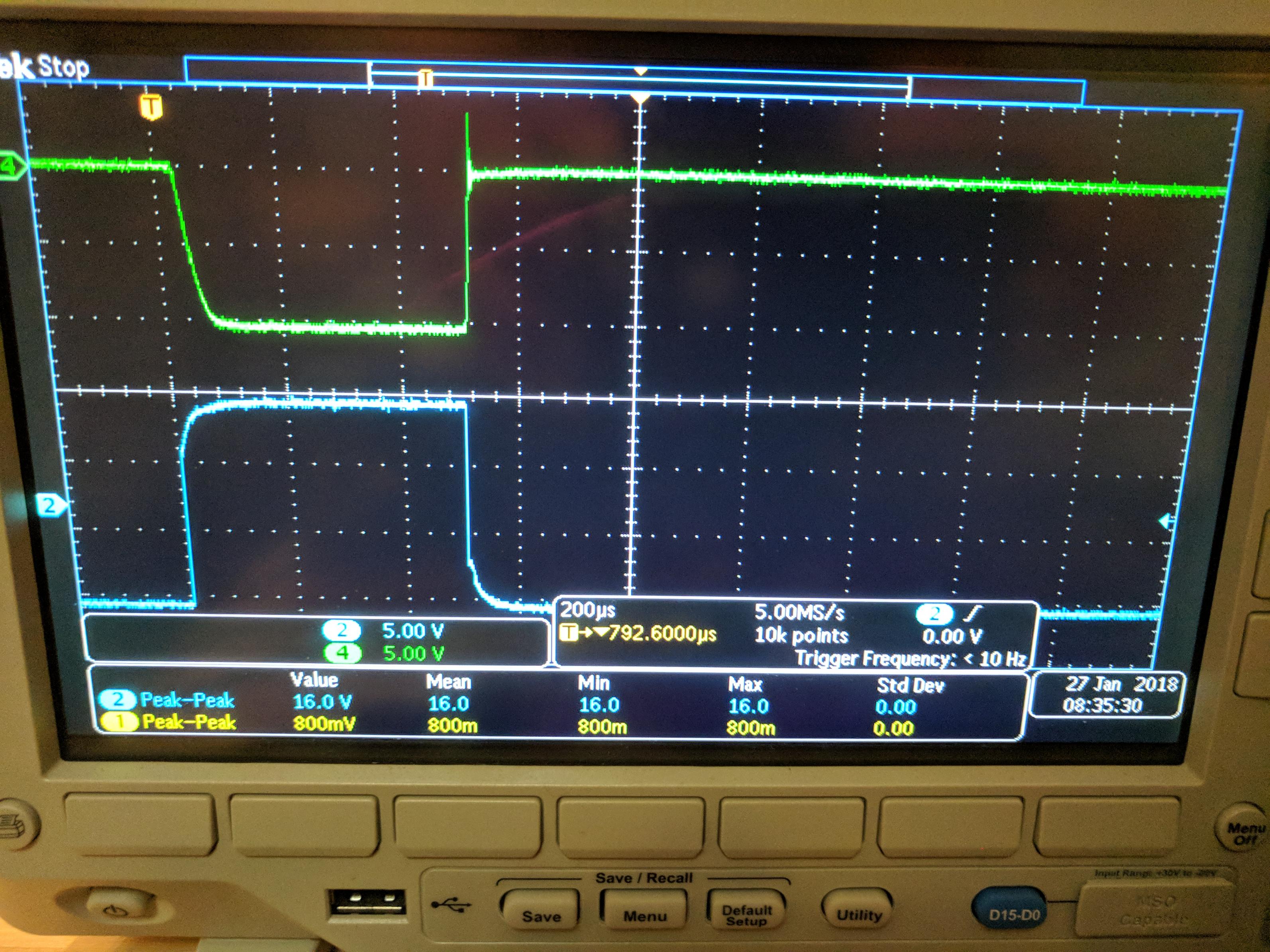

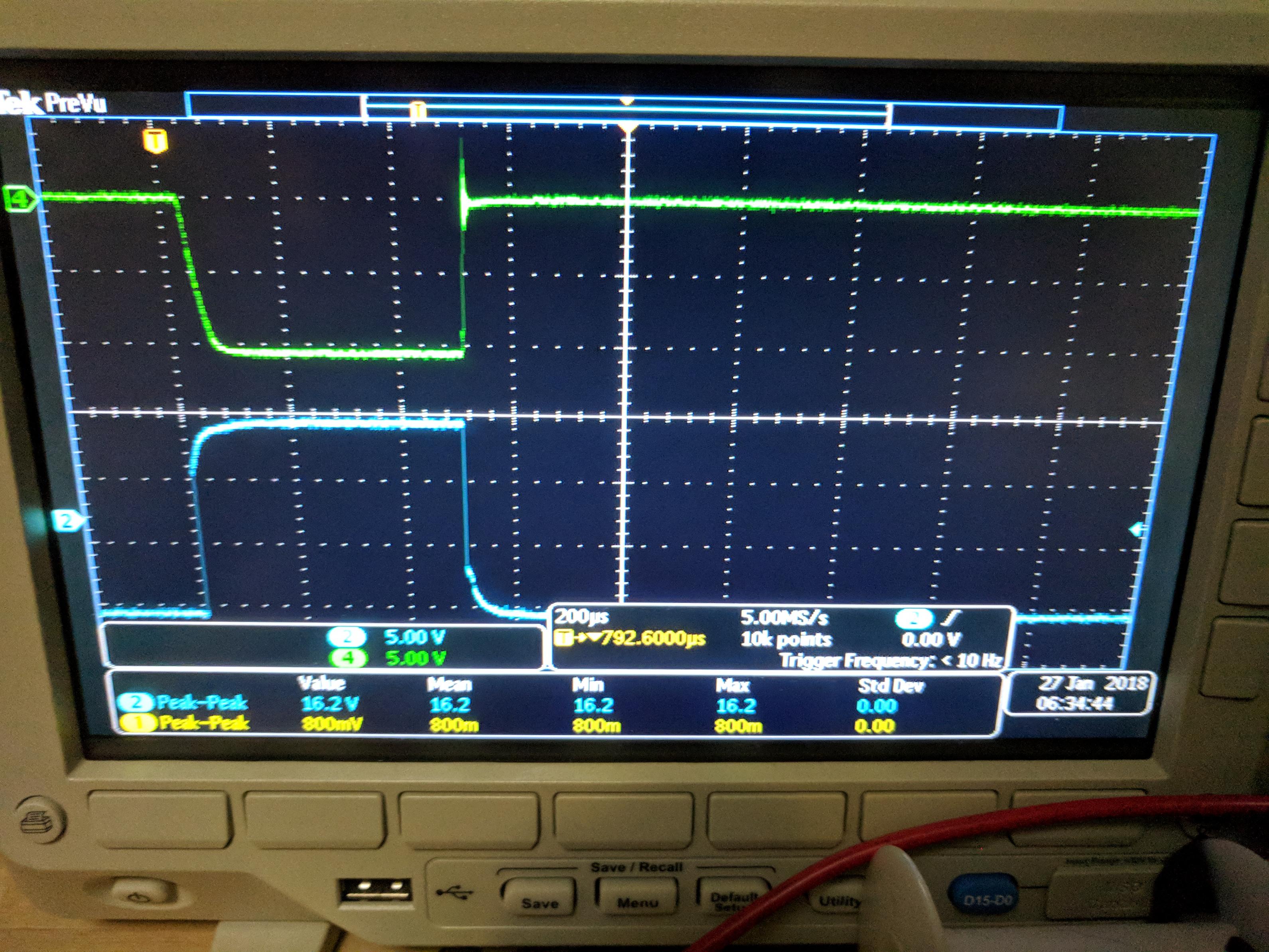

Here is the N-channel FET in a test of high current. The FET is simply used in class B mode. The gate is driven by a 15V pulse. The blue trace is the 15V, 500 uS gate pulse. The green trace is the voltage across a 0.1 ohm resistor that is connected from the FET source to the power supply negative. I measured from the Fet source to power supply negative because I lack a differential probe to lmeasure the voltage across a resistor from drain to power supply positive.
So, a tiny bit more than 100A flowing through the FET.
I want to call this amp "The beast with a hundred amps (Amperes)". Has this name already been trademarked here?
Next I will start to characterize all of the output FETs and look for the closest match for transconductance curves, etc.

Well done Woofertester this is the kind of stuff I like to see real world measurements.
I'm surprised at the delay in the rising edge of the input pulse and the slope not as fast as I thought it would be. Secondly the overshoot and ringing at the end is this due to the power supply recovering?
I believe the delay of the rising edge is because the FET is not biased. The 15V pulse must rise above Vgs_on (4.5-ish volts) before the FET turns on.

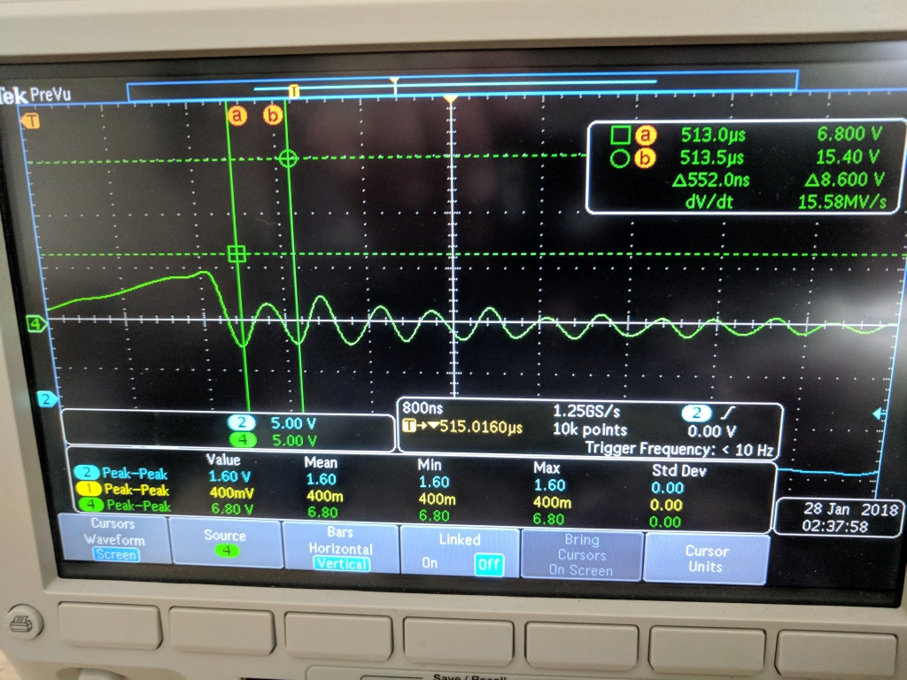

The ringing at the end of the pulse is, I believe, a device phenomena. The cure may be a series RC zobel across gate and drain.

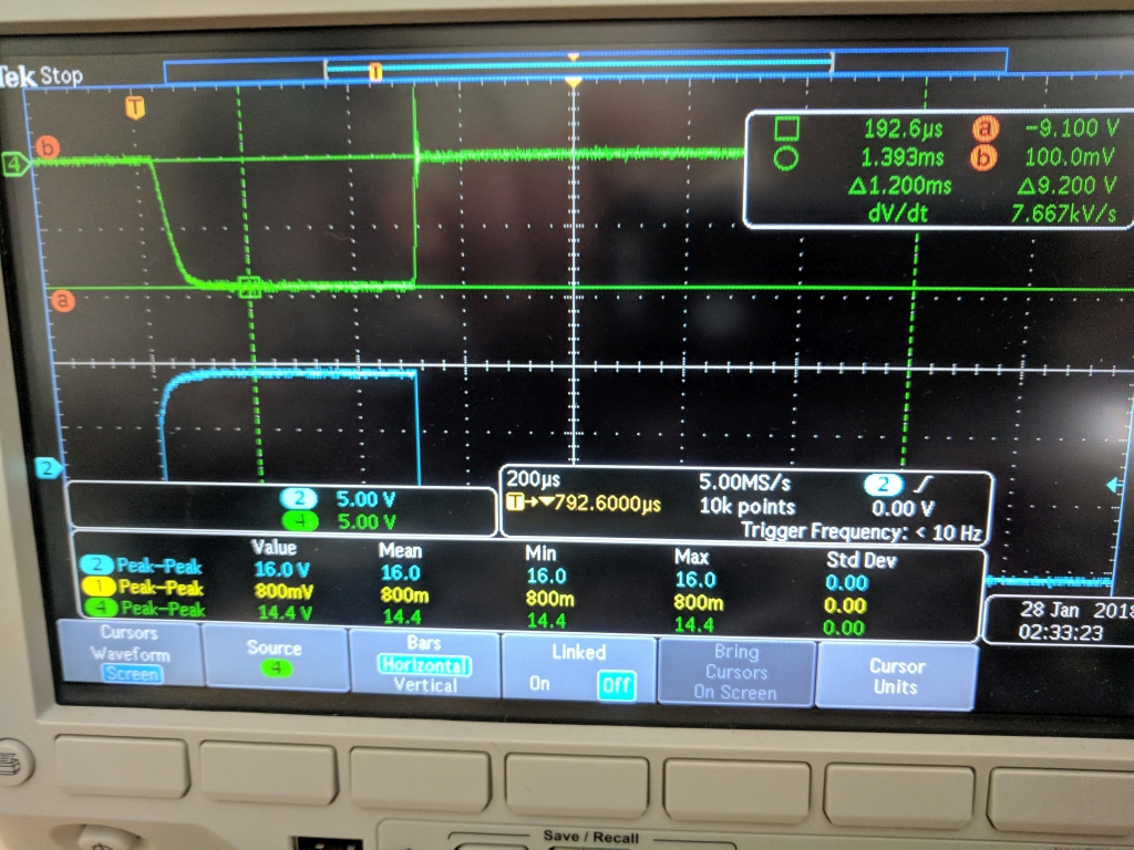

9.2v pk across 0.05 ohms, 184 Amperes. The datasheet for the N-channel part states that 200A is the max that can go through the package wiring. So we stop here looking for more current.
Next is the ringing upon turn off. The frequency of oscillation is about 1.8 MHz. I will try various gate stop resistances and RC snubbers across the drain and source.

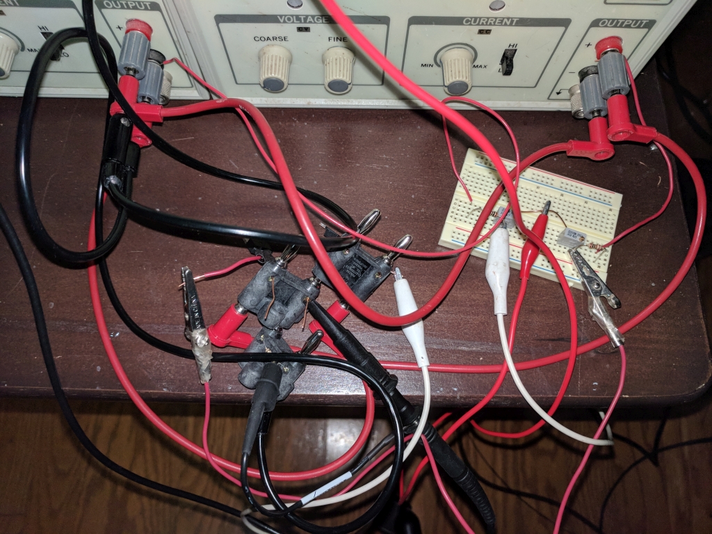

The bias circuit is powered by + / - 24V. The bias circuit is two resistors of 3.3k ohms each and and two 1k ohm pots.
The intent is for the entire front end to run at + / - 24V.
The next step is to see if the OPS can pass a sine wave, square, triangle.
