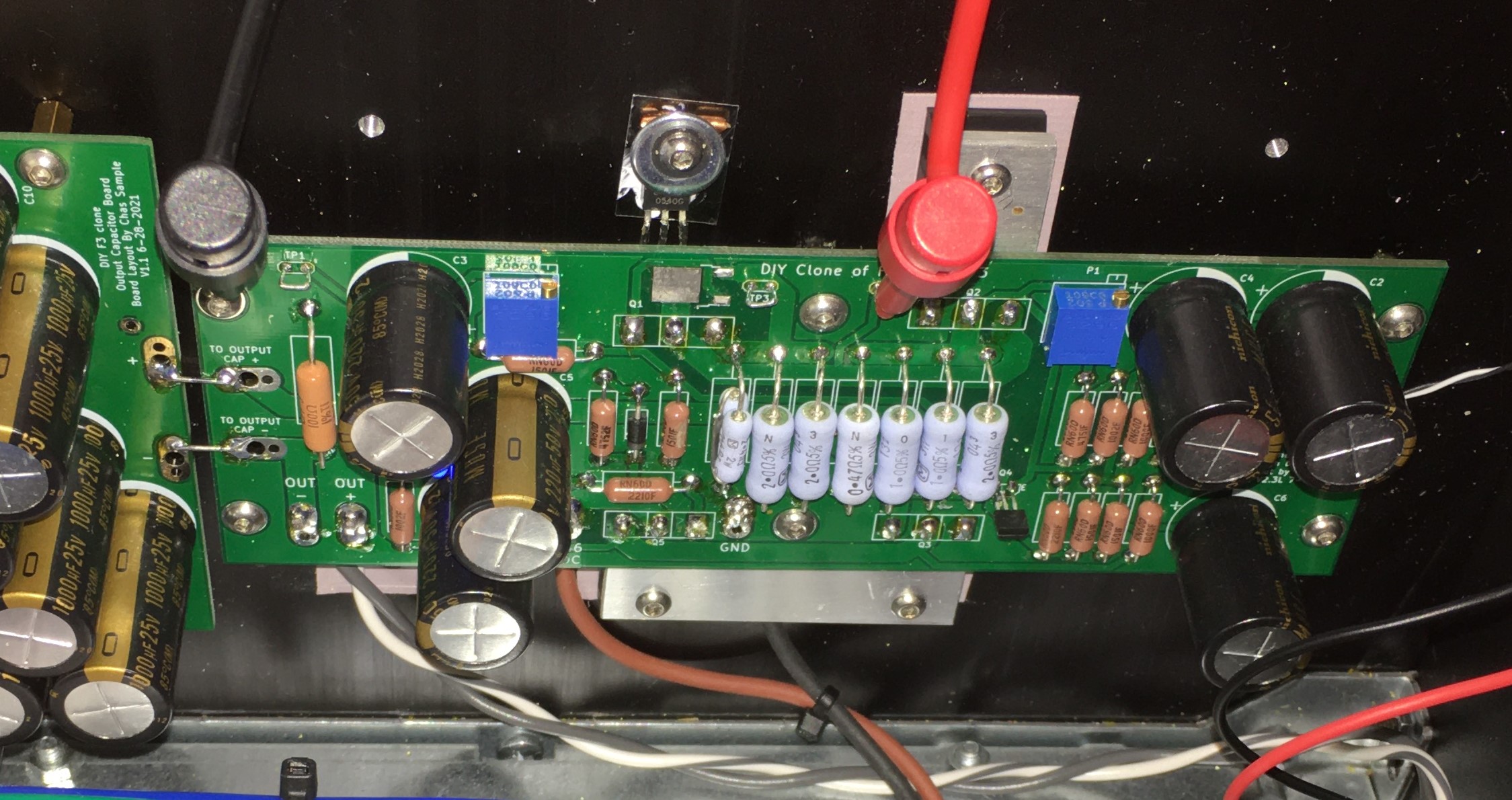

Figuring out a BOM and have questions on C1, C8, C10.
I'm planning on using the outboard PCB for 15 1000uf caps for C1. Which means the 1uf C8 on the backside of the board is not populated, correct?
What about C10- 220uf on the schematic? Not populated and covered by my C1 caps? Thanks.
Yes, you are right. If you use the 15x 1000uF caps of higher quality to replace C1, the bypass caps C8 and C10 are not used.

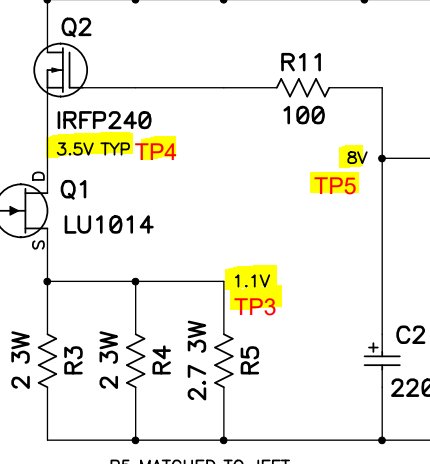

Test Points
I don't think I mentioned it, but there are test points on the amp boards that correspond the locations on the Firstwatt schematic with indicated voltages. There are two holes at each test point to solder in a "U" shaped lead for easy clip attachment when making adjustments to the board. Most are located at the top of the board for easy access.

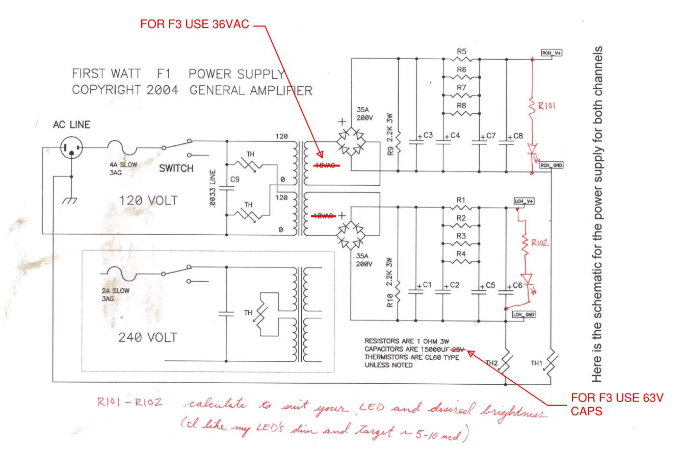

Hi Chas,
PSU schemathics seems the same as 2X24VDC for F1/F1J: as 46DC are needed, I think that it is necessary to put secondaries in series (not one for channel) or to have a donut with 2X36VAC secondaries....
Thanks for pointing that out, I missed updating the AC voltage into the rectifiers.
Thanks Chas
Is 400VA enough?

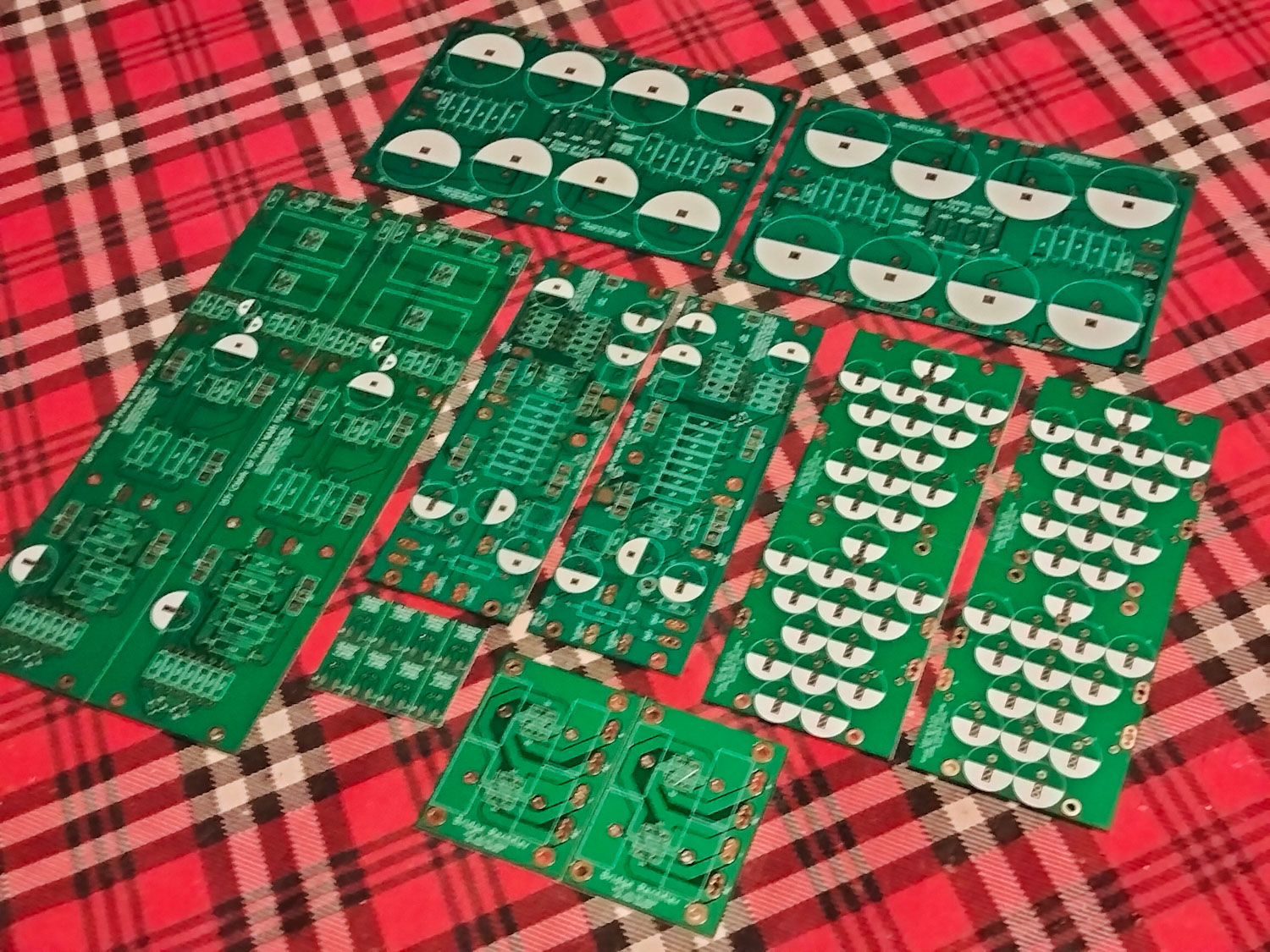

Nice big order.
The PCBs on the left side are for a different project? I don’t recognized the PCBs.
Looking forward to seeing your build.
BR
Eric
