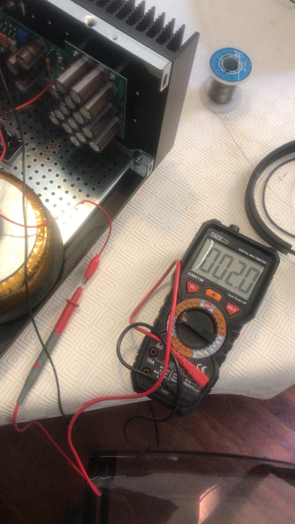

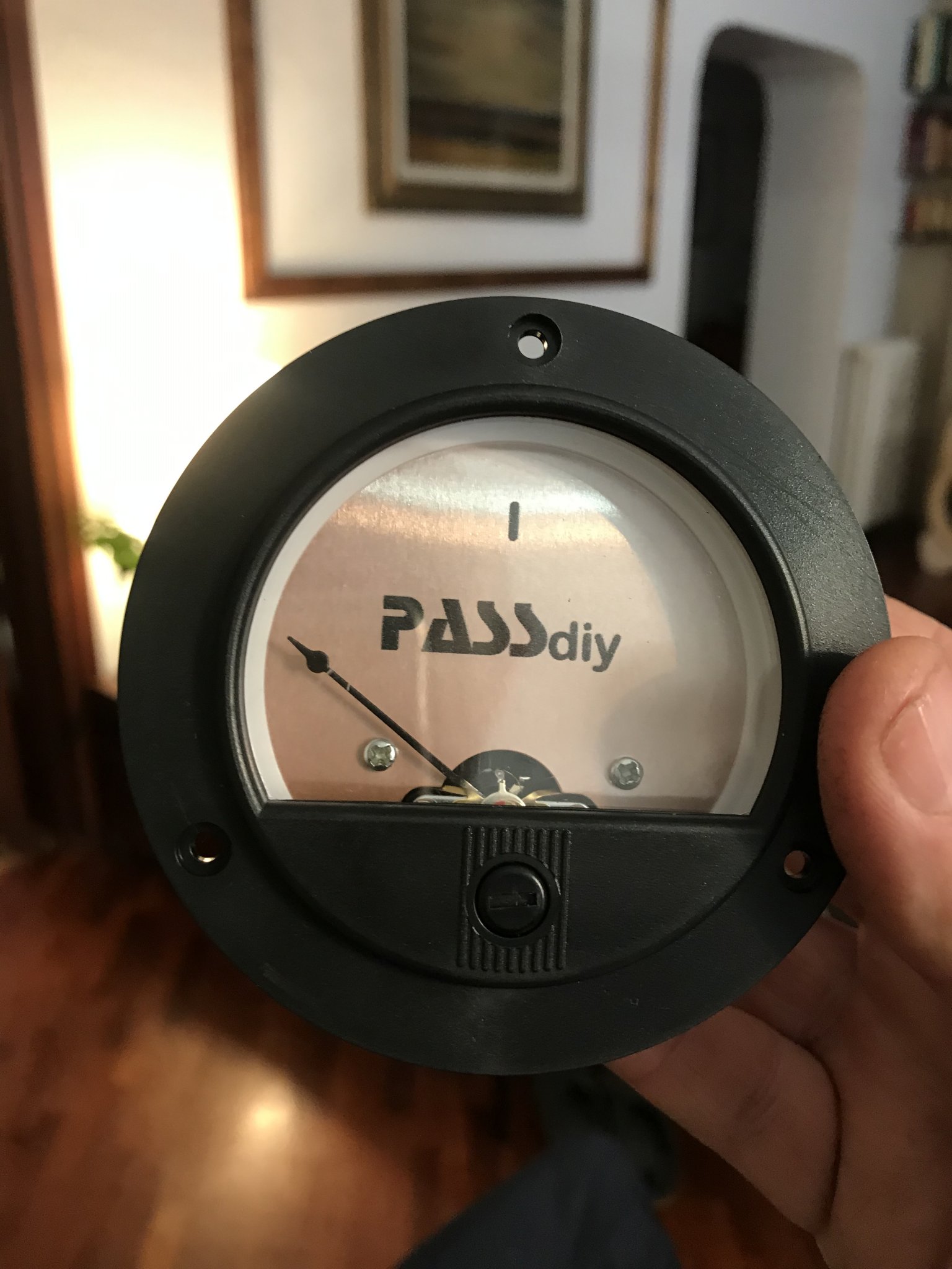

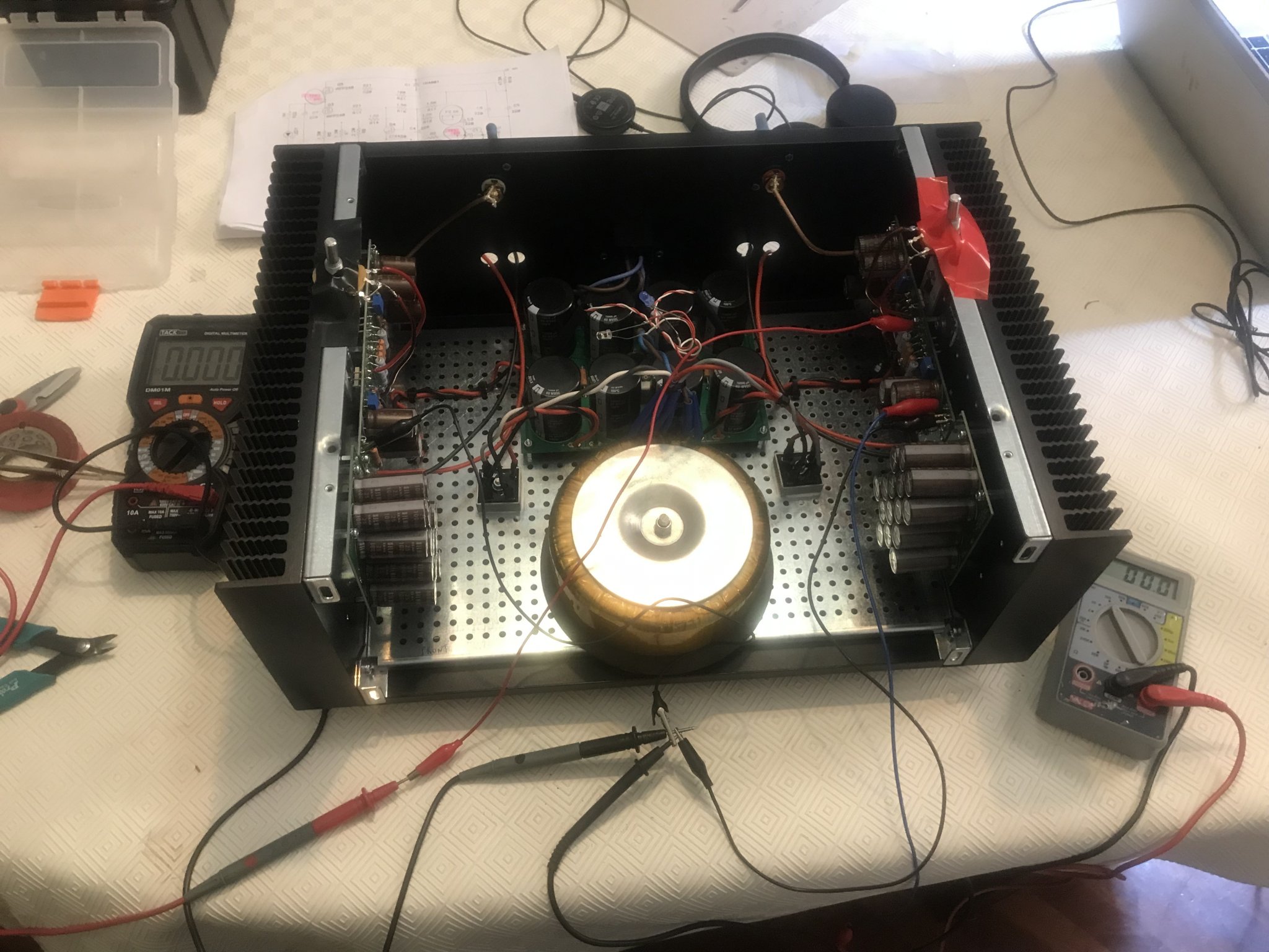

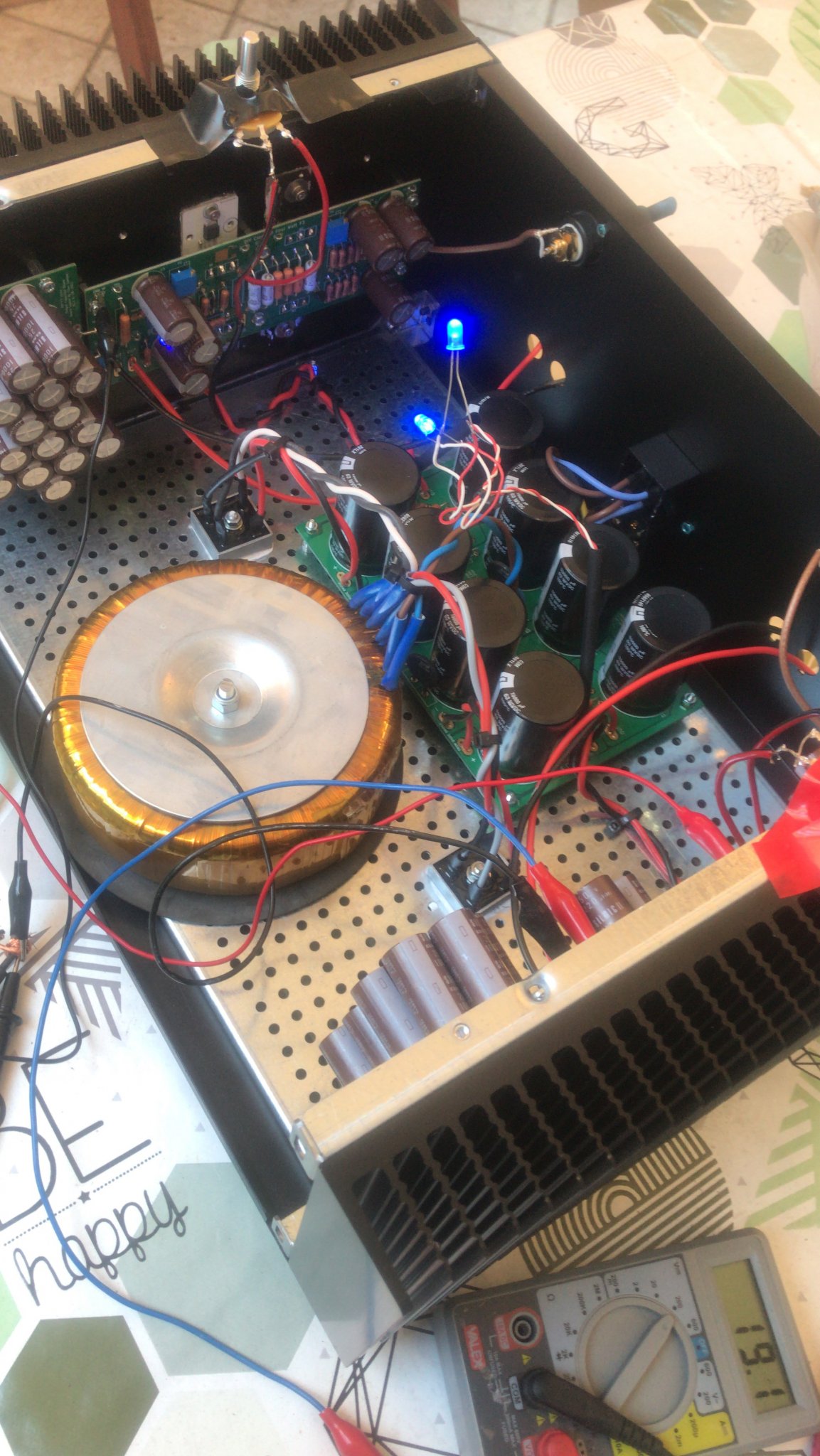

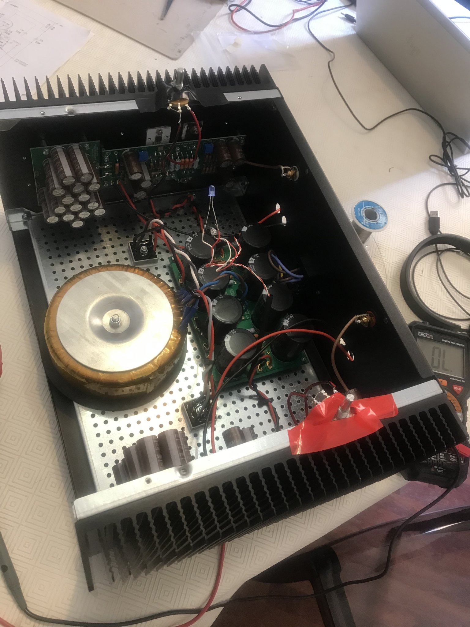

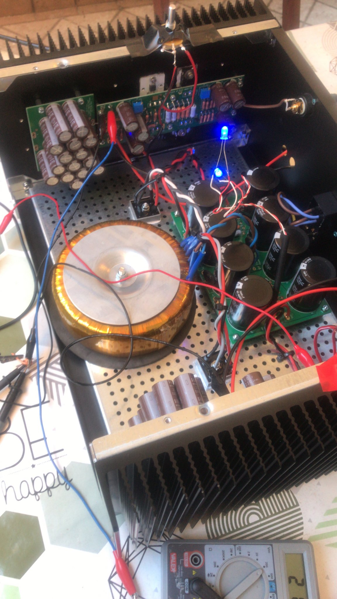

my F3 is taking shape

Hory Clap!!! That looks fantastic, can’t wait to see it all together with that meter! How is it biasing up? Bubba

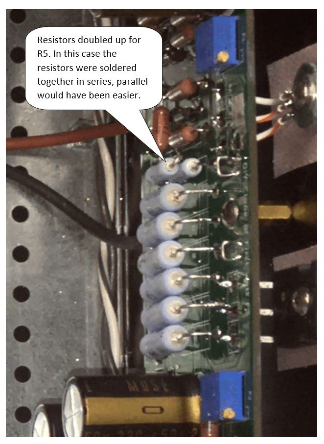

Powered up the right channel board yesterday and all went well. I will make a couple small updates to the boards (correct a silk screen mistake and add 2nd resistor location for R5 to make it easier to parallel resistors to create the desired resistance to match a particular Q1). Due to a lack of time on my part and a lack of general interest I will not be making the second power supply board option for this group buy. Please update your desired quantities by 8/29 and I will place the order on 8/30.
Was the 2nd resistor location to fine tune R5 implemented ?
I looked briefly at my PCBs and couldn’t see it. If it’s not there I will unsolder R5 and temporarily replace it with a 5-10W pot until I find the precise value based on Q1.
Eric
Sorry, for the immensely late response, I needed a break after the group buy wrapped up. I tried to add a second resistor location for R5 and decided that it was not worth the effort to rework the board. For my build I used the potentiometer to determine the required value, and soldered together a set of resistors and placed the set in the R5 location.Hi
