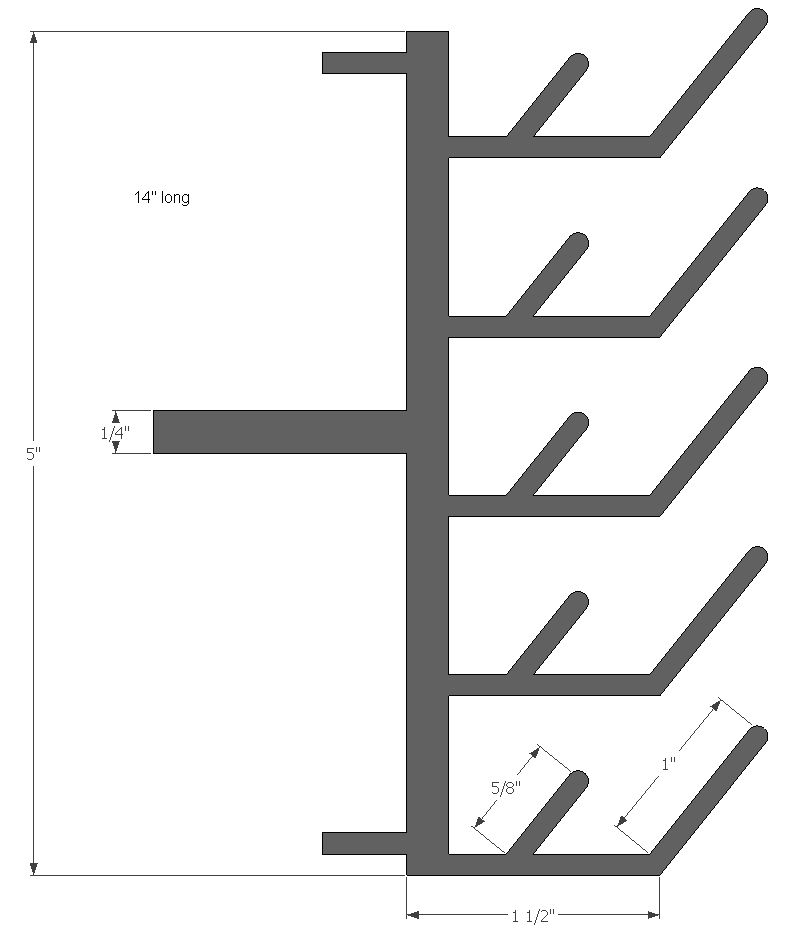

grubyhalo said:Is this heat-sink available anywhere?
It is my proprietary extrusion.
Case and Heat Sinks
I was in a group buy for case and heat sinks for my future F3 and it crashed and burned. Now I am starting from scratch.
Any Suggestions?
Any Suggestions?
Re: Case and Heat Sinks
That doesn't sound suprising.
I normally get aluminum sheet in 24" and 48" lengths and cut it to length with a non-ferrous table-saw blade.
With the F3, I am having speedymetals.com do the cutting, since I can't seem to cut a strait line that good.
Using PD boards with Fets directly attached to a Conrad heatsink, the fets run 65C and I dont want that to go too much higher.
I have used Barred Boss ebay Heatsinks, previously, and find them to dissapate heat well. Other than that, I go surplus.
