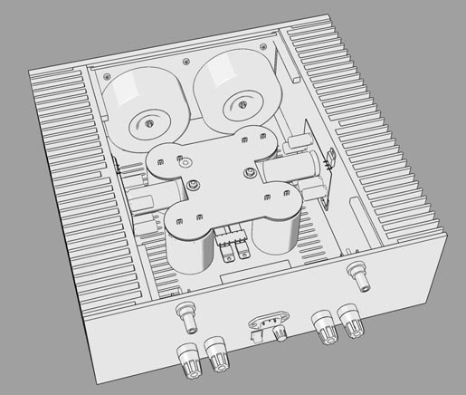

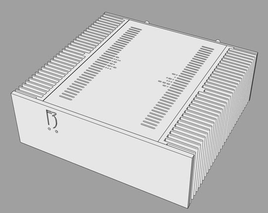

Well this is the one of the many good things about this forum...taking into account Telstar's feedback i decided to review my layout using AAvid Thermalloy OD452 heatsink ( 402 x 79,5 x 150 rated at 0,15ºC/W ).
So box gains 10 cm in depth and some decent breathing room.
All in all much better.

It looks very good 🙂
I cannot ind that Aavid part number, though.
Ah CeeVee,
There's plenty o' room there for a nice buffer and maybe a Lightspeed vol control to complete the package!
And with all that extra *C/Wto spare, you could go all the way with a rather good shunt reg to replace the Cmultiplier!
