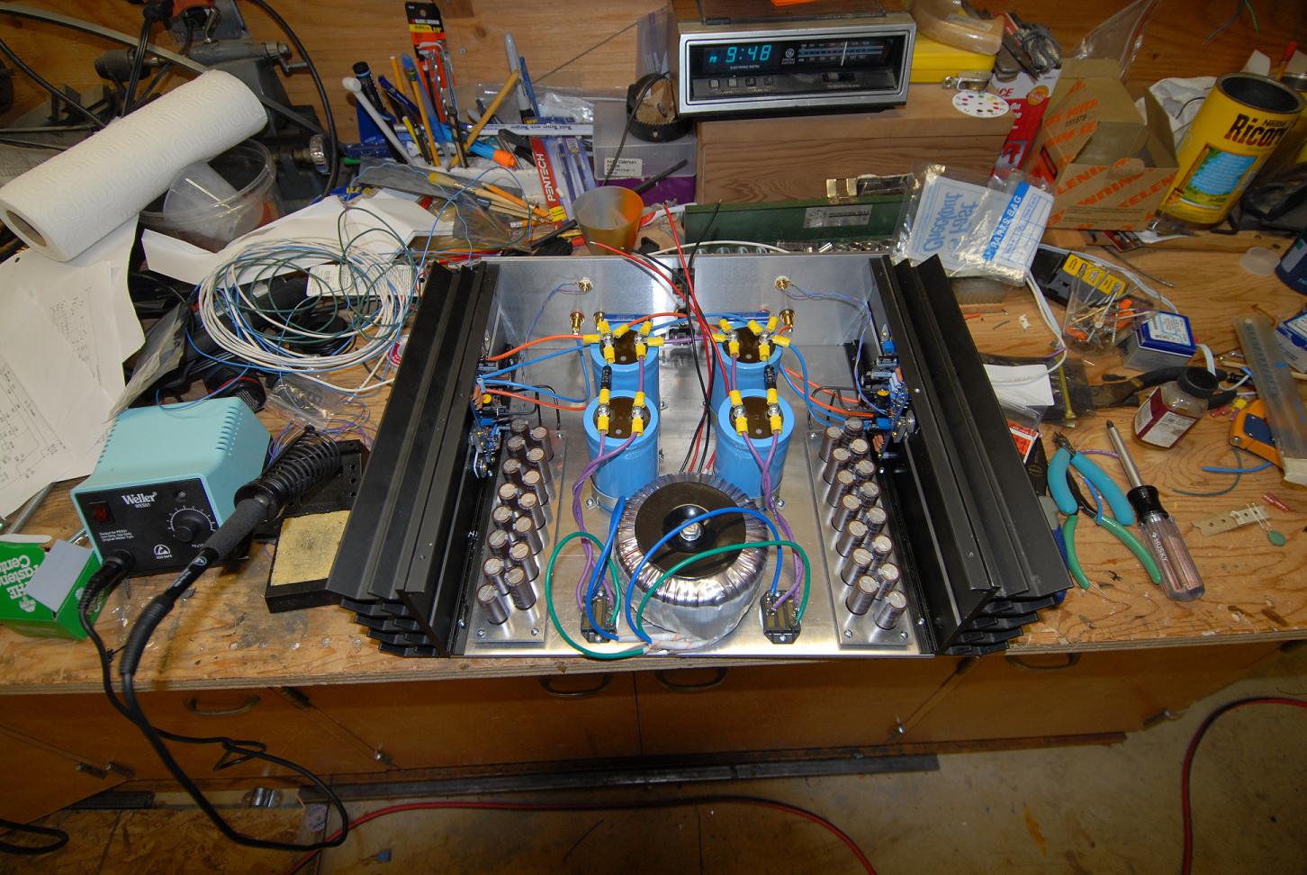

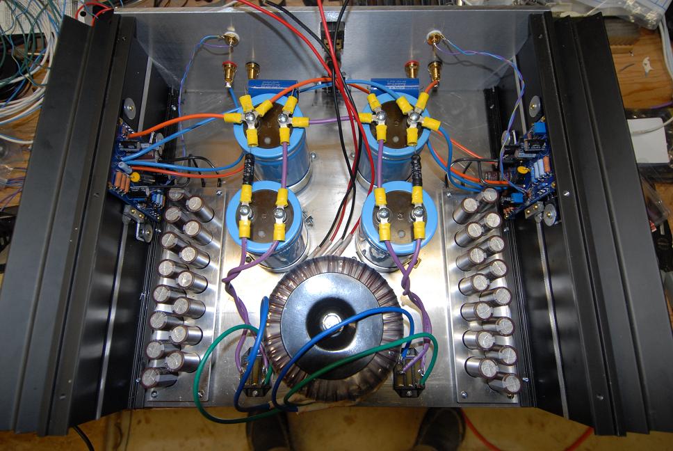

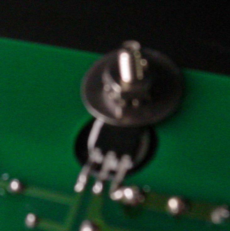

I mutilated the little Lovell while trying to desolder - sorry buddy. Now I am waiting for some more coming in from Jack. Can I mount these guys off the board and use 20 gauge wires to solder to the board?
I replaced all the 220uf caps with Panasonic FC's, turned the P2's to minimum and mounted the lovol's to the heatsinks and it sounds so much better. I have been listening all day and it is indeed much sweeter sounding than the F5 now. I am still waiting for a couple of Mundorff's to replace the C1's.

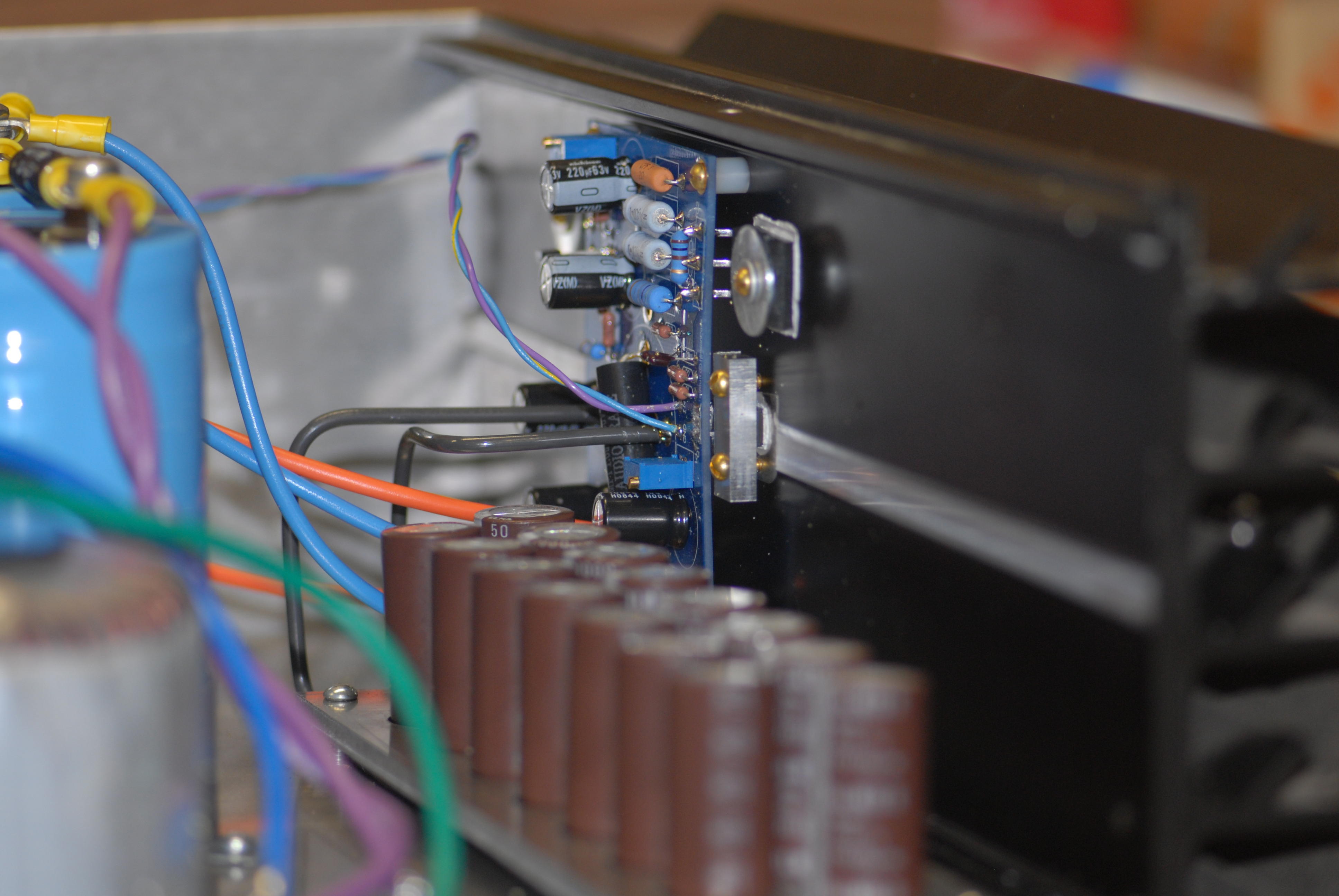

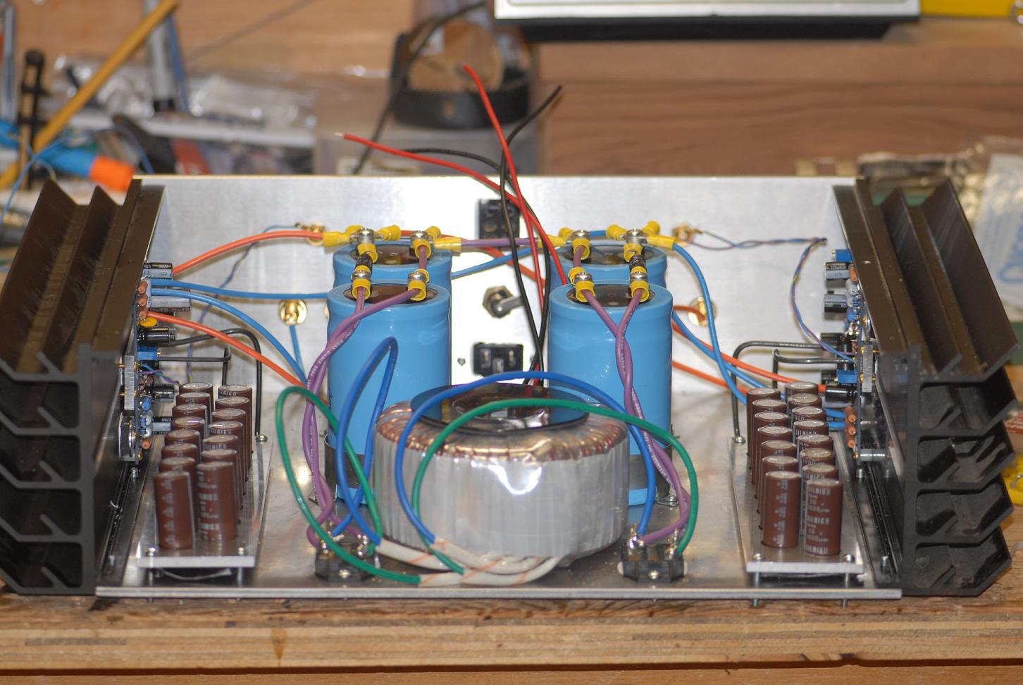

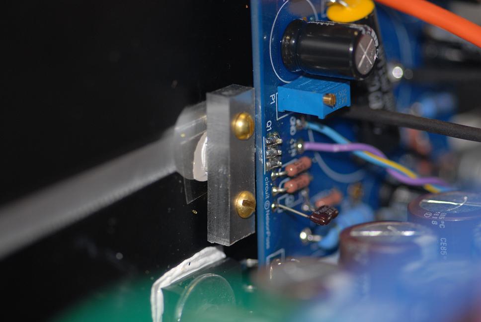

Since I am close to having a working amp (and I need a bit of help) I have decided to post a few pictures. A lot of this got done yesterday and I have been dying to complete the rest but inevitably I have forgotten a part. The thermistors are that one thing.
I have some unknown thermistors, only two, but more testing will have to be done to decide their suitability.
The first third and fifth pictures are overviews.
The second picture shows how I mounted Q1.
It is a sandwich: heatsink, grease, mica, grease, FET, aluminum, screws. The legs are insulated as well.
Ah yes, the output caps. I used 15x1000uf silmics
For fun I added a mounting bracket, you can see the connections in the fourth picture (black wires)
