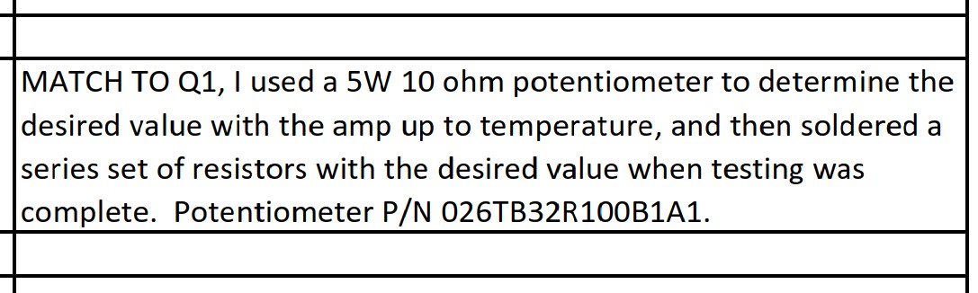

I'm about to finish my F3 and have taken the advice that Chas provided about adjusting R5 using a 10ohm 10w variable pot to get 3.5v from the LU1014. Is there any reason that I need to remove the pot from the amp once it is set? I know that I would need to secure the pot.
I built up the amp, and put a 10ohm 5W potentiometer in place of R5 with the initial resistance set per Vgs and the chart below. P1 and P2 set to mid position by counting turns. After approximately 5 minutes after power up begin to periodically adjust P1 and the "R5" potentiometer as the amp warms up to keep the voltages at Q1 drain and R9-C1 junction at the values on the F3 schematic (3.5V and 21V respectively). Let the amp run for 1 hour make final adjustments. Remove "R5" potentiometer and measure resistance. Solder in real resistor for R5 of closest value I could make up from resistors on hand.
Just a pair of questions, Chas: did you add the pot with the 1 Ohm resistor in parallel? could you pkease link a proper 5W potentiometer? Thanks :cheers:
I’m getting closer to finishing my F3. One channel is operational and the second one is in place a wired. I just need to fire it up and adjust it. The 10ohm pot works very well, and I’m not sure if I will remove it. My only concern is that it is just being held in place with the wires. I would want to secure it better if I leave it in.

This is the 5w pot listed for R5 adjustments:
026TB32R100B1A1 CTS Electronic Components | Mouser
Ops, didn't read the note on BOM! thanks, Vunce!

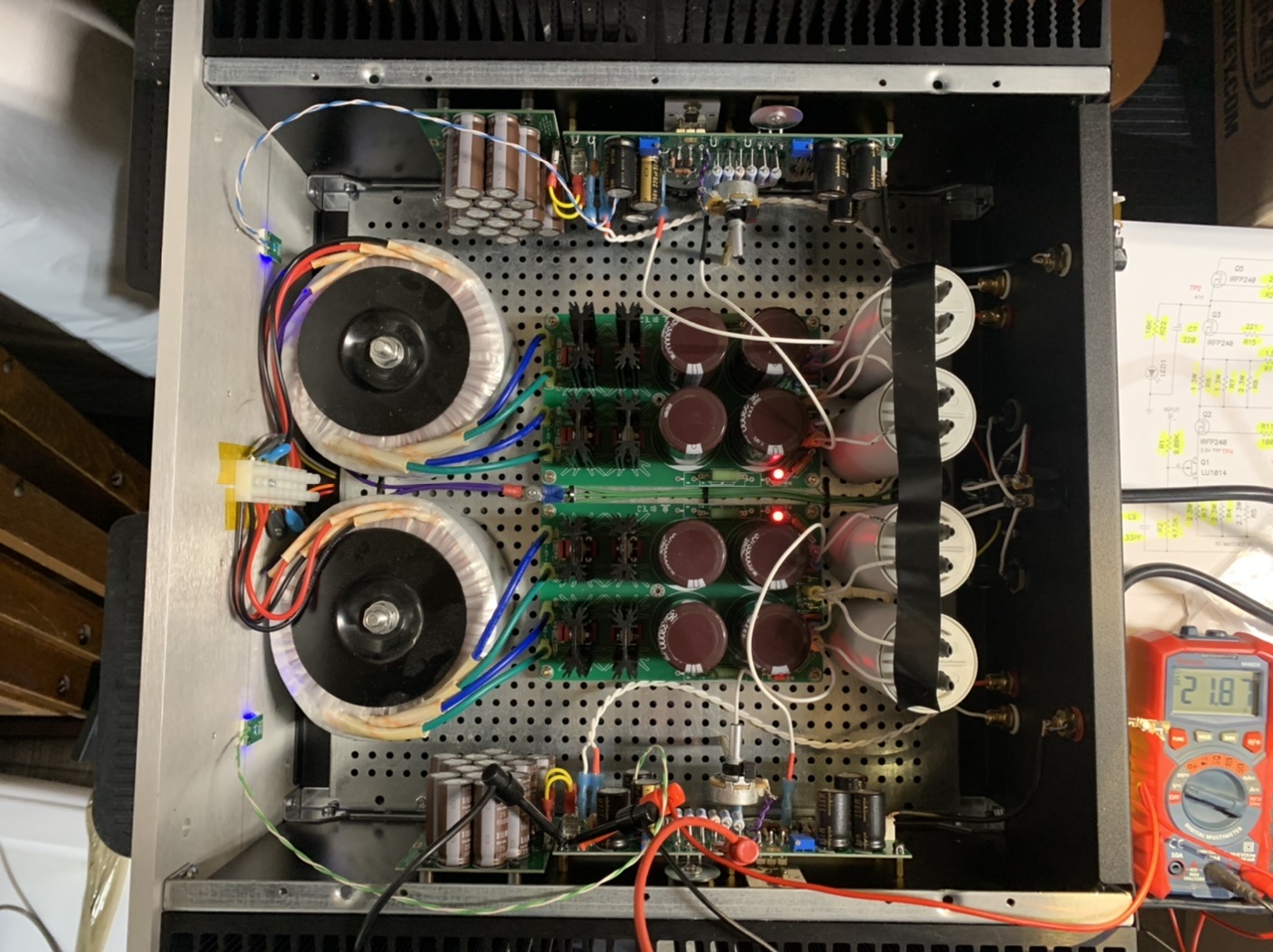

I finally finished my F3. I left the pots in. I did not see a reason to remove them. It took the right channel awhile to settle and get 3.5v. I only did a quick listen on some inexpensive speakers in my work space, but the amp sounded very good. I was feeding the amp from a TB DAC and ACA+ pre. The Test points make measuring so much easier. These are great boards.

Chas,
The holes worked perfectly. The pins on the adapter boards are a little tight, but fit. I was actually dry fitting the boards and had one of them reversed and the mounting holes did not align. It was then that I realized the LU1014 holes on the board were different, so that they would accommodate the adapter boards. Great job on them.
Vince,
I initially used wire (20 gauge solid core) to hold the pots in place, but that is not secure. I used some standoffs from the bottom plate and zip ties to secure them, so now they are nice and stable.
