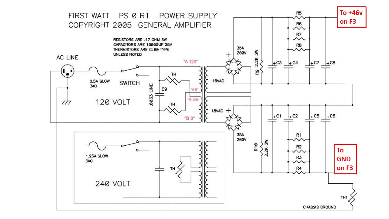

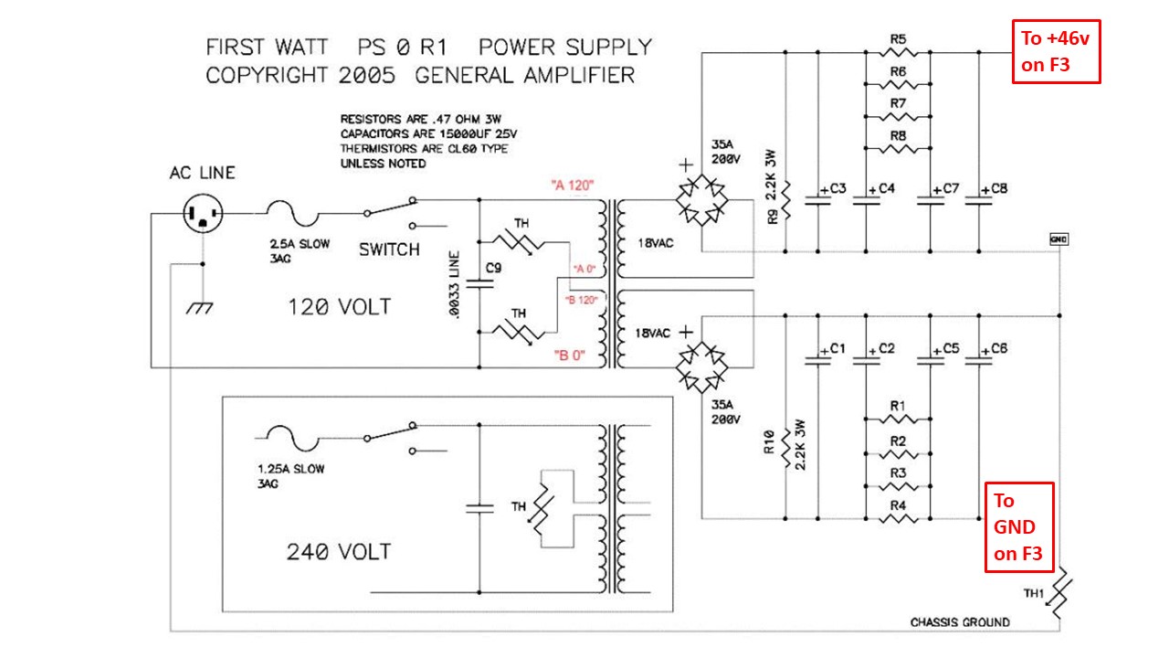

The information that I could find from Firstwatt on the F3 is below. Please note this is not the same as the dual mono power supply used on F1 or F2 and that was supplied in the latest F3 Group Buy. See post 120 of the F3 Clone Board Set Group Buy thread for the schematic of the boards in the group buy.
So, with your PCB, can I go for dual mono 2X36Vac? in your BOM schemathic there are 8x50V 15mF caps but secondaries are marked as 2X18Vac
I want to make sure that this is how to use the bipolar power supply using the 18v transformer to power the F3.

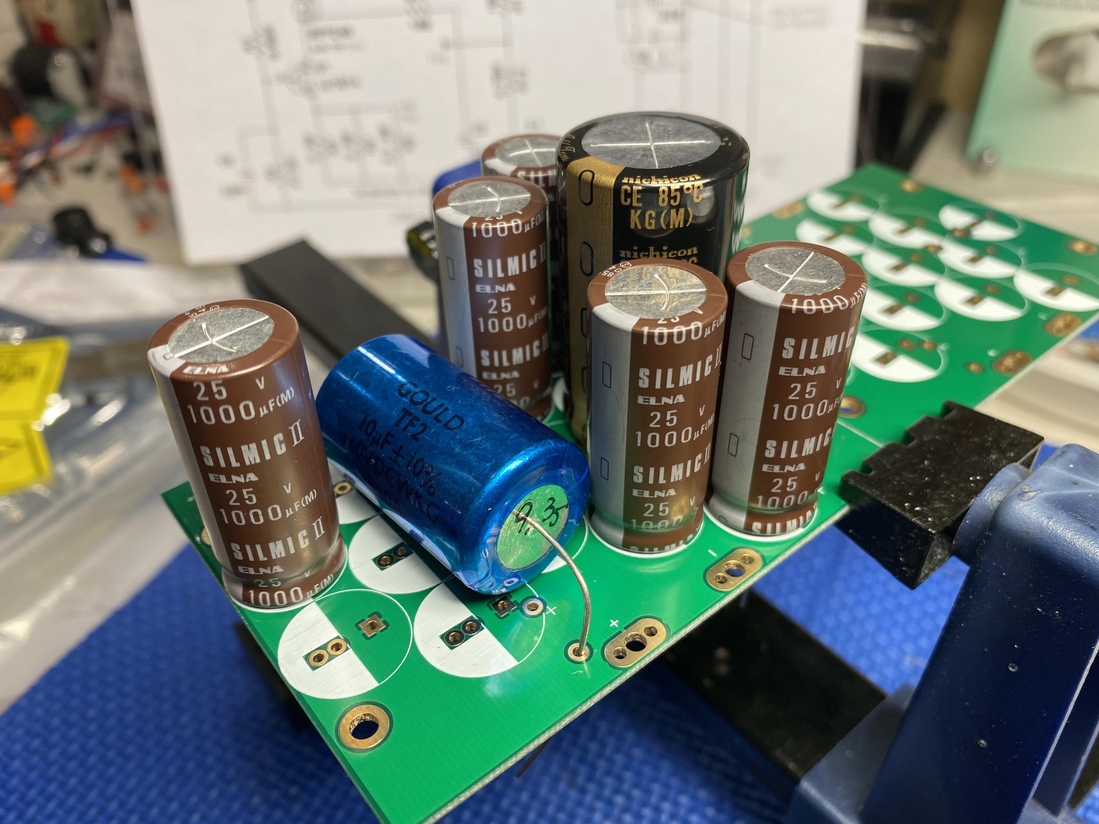

Hey Pepennino,
Cap boards look sweet stuffed with a bunch of Silmics! I’m right behind you 😉
What do you Fellas think of this combo? (Not soldered yet)
Nichicon KG 10,000uF
Elna Silmic 1000uF x5
Polycarbonate Film 10uf

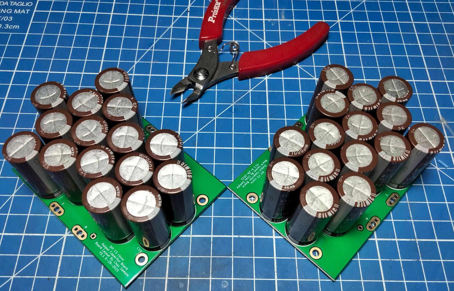

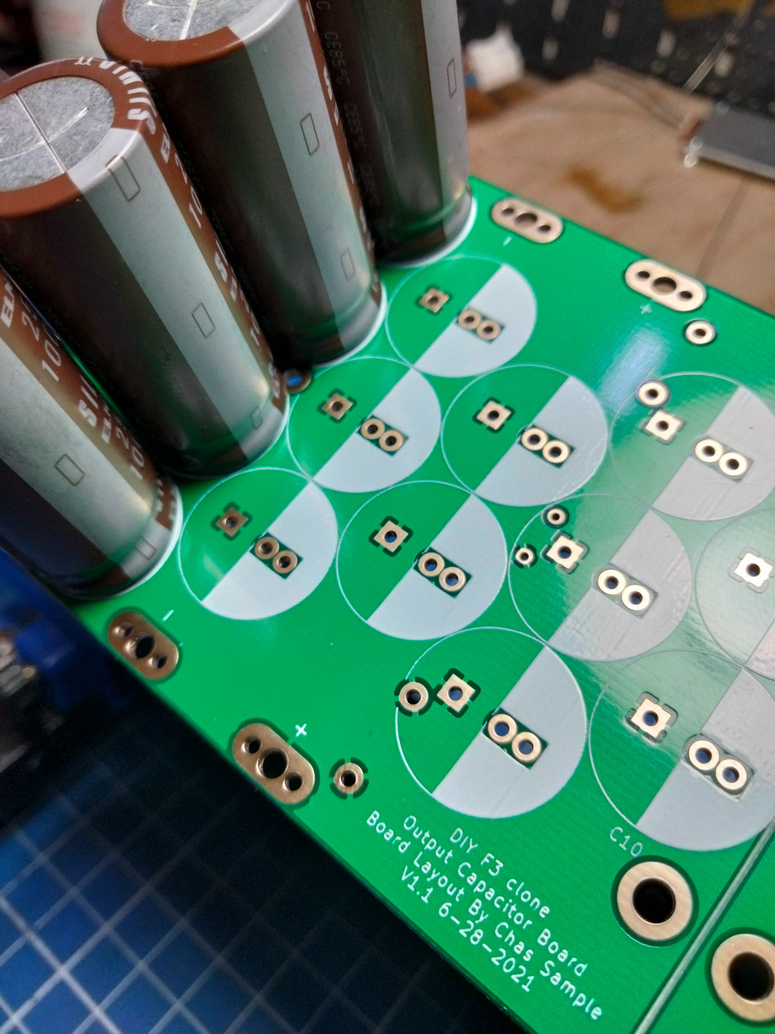

Some F3 assembling progress.
Amp boards just need mosfets, Jfet and R5 installed. I can’t proceed further until I decide on a chassis. I could use a 4U 300mm case if I transplant the amp that currently resides inside…..
Vias for ‘U’ shaped test points are a nice touch Chas!
