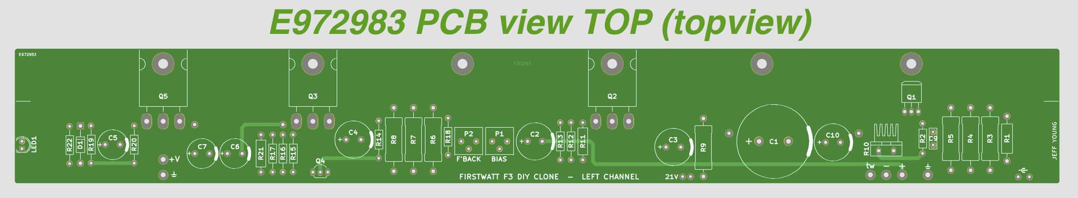

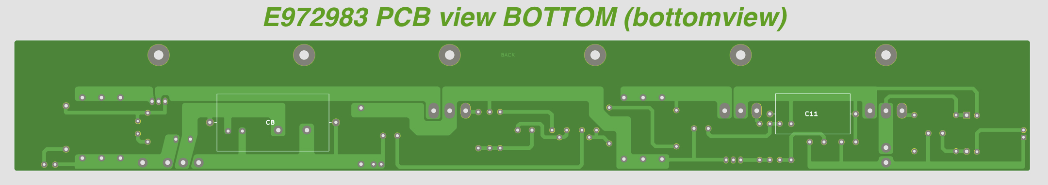

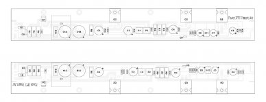

I think (hope?) I'm getting near my final board layout.
I've changed the output caps since the big Panasonics are NLA: I'm using a pair of Wurth 8200uF electrolytics and a Mundorf 8.2uF polypropylene jelly roll.
I've also added a film cap (6.8uF polyester) to the Cmultiplier output.
attachment.php
attachment.php

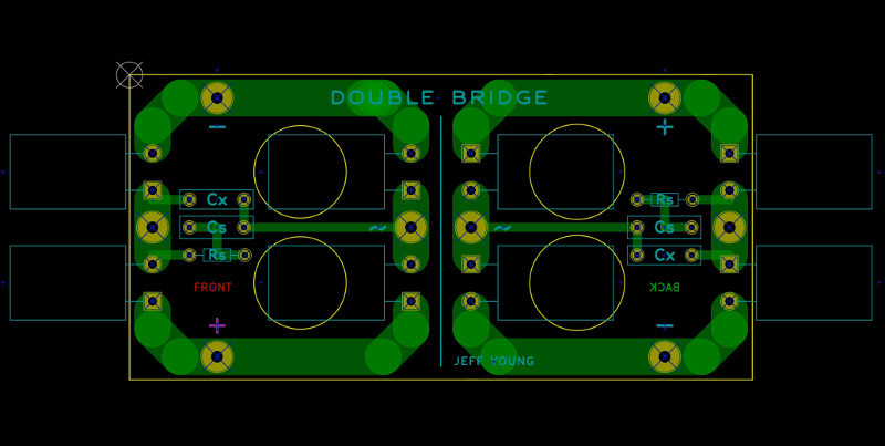

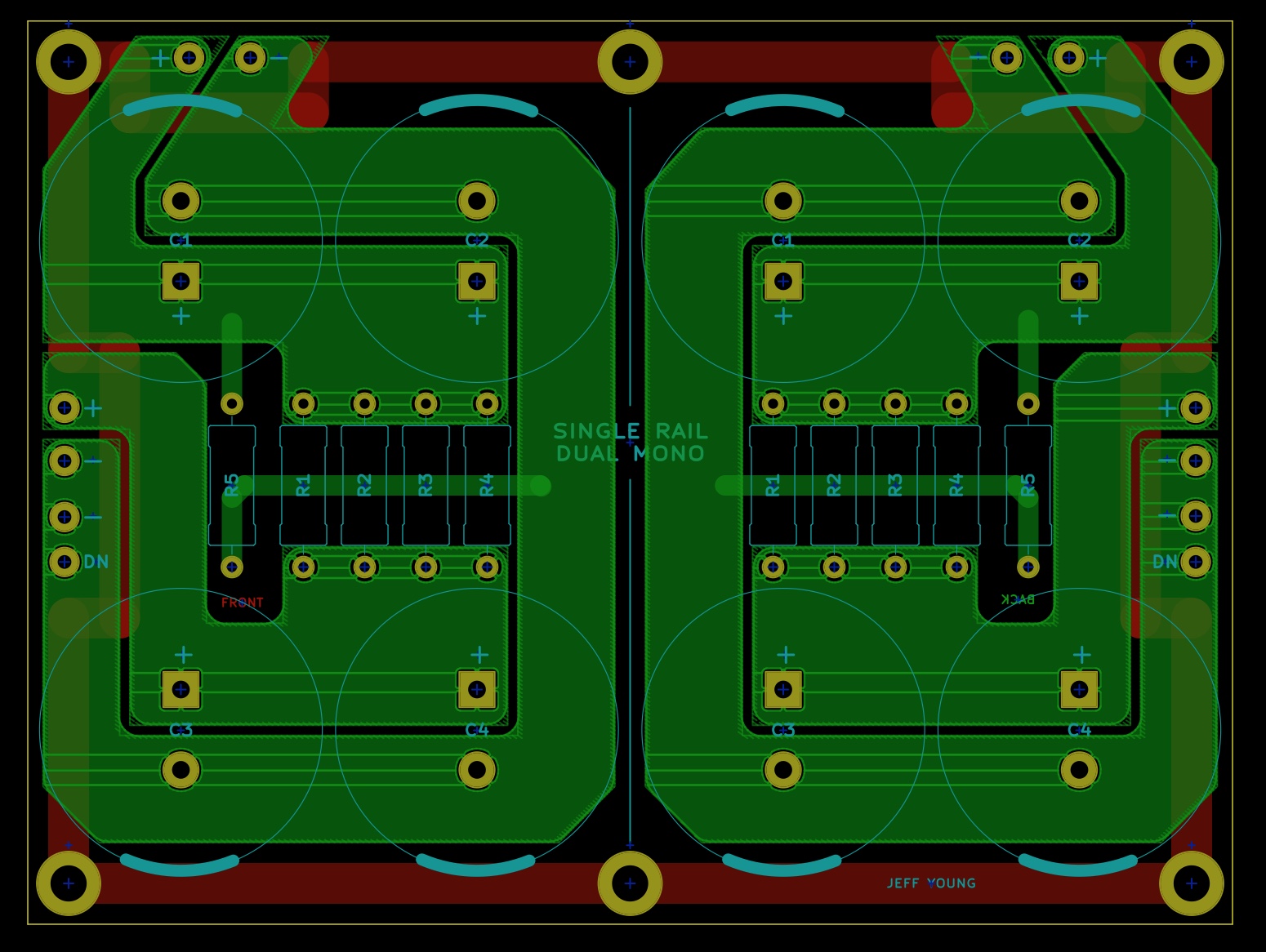

I've been practicing my toner transfer and etching skills. While I've learned a lot, one of the things I've learned is that I don't enjoy toner transfer or etching. :rolleyes:
So it's back to the drawing board to produce Gerbers for a fab house. I did up a board for a pair of bridge rectifiers (with snubbers) that is currently with EuroCircuits, and I have a first draft for a dual mono PSU.
I did both those sans schematic, but KiCAD appears to work more efficiently from a schematic, so I've also done a first-draft schematic for the left channel.
Comments welcome.

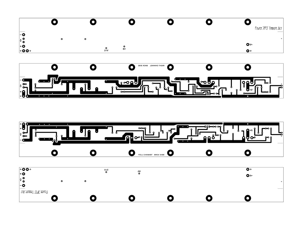

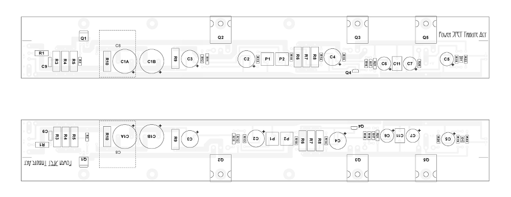

Hi Moppy,
I made 3 sets of my boards, and I only need 2.
There are a few changes from the FirstWatt versions:
1) added an optional film capacitor after the c-multiplier
2) changed C1 to a Mundorf MLytic AG (the Panasonics are no longer available)
3) changed R5 to a TO package
4) added a pre-capacitor tweeter output
5) separated power and signal grounds
6) made room for the larger Elna Silmic IIs for C2, C3, C4 and C10
... but you might want to wait so I can make sure they work first. ;)
Jeff.
