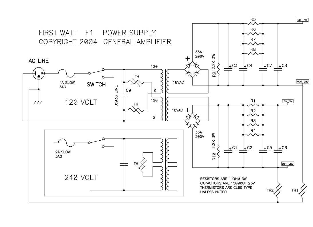

Suppose this is the best place to ask, I am looking for PSU boards or schematic for an F3 build.

PSU the same as for F5 but transformer 2x35VAC (or 2x36VAC) , change capacitors voltage accordingly i.e. 63V.Hi All

I am not quite sure but using the F5 PSU board and rising the xformers to 2x35V you must carefully look where you put your grounding point otherwise you could end with 100V......I am afraid!
or did I misunderstand something?🙂
when you really take two 35V AC windings you had to separate the two branches so that ground is no more in the middle of the arrangement...
difficult to do with an F5 PSU board.....

... but I'm sure.
A transformer with really two separate windings will work, but if the transformer is centertapped you will get twice output voltage if you connect the input to the pre amp or connect the GND of both channels together otherwise - trust me, C7 jumped right into my face!!!

Audio D, in the case you take the F5 PSU to get the 45V you have to use the minus tap as ground. So you have indeed around 45V between the new defined ground (-tap) and the +rail. And of course you let the "old" ground unused!
I did it sometimes but I always was in DANGER to use the ground connections marked on the board and take care if you have a thermistor CL60 or something like this on the pcb from the middle earth to chassis. I your case the thermistor has to be placed otherwise.
As a whole using the F5 PSU board for an F3 demands in my eyes to much attention to make no fault.....🙁

You're absolutely right. I should have mentioned this also. I did PSU board myself.I am not quite sure but using the F5 PSU board and rising the xformers to 2x35V you must carefully look where you put your grounding point otherwise you could end with 100V......I am afraid!
I have had a response from the man himself regarding the F3 power supply and he has advised me to used the information from the ZV9. so I will now need to look for this info or available PCbs

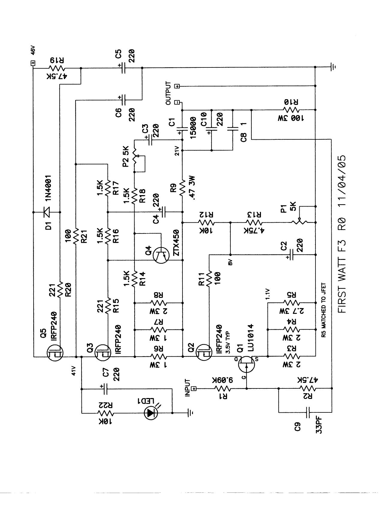

I am really intrigued by modifying the output caps on the F3. In my 3 way system (Seas W26, PHl 1120, Raven 2 I use a Marchand XM46 passive crossover with 12dB at 200Hz and 6dB at 6000Hz. A pair of Crown K1s are on the bottom end, a F3 on the mids and a Aleph 30 on the Ravens. I would really appreciate suggestions on possible caps to use in modifying the F3s output.

I think NP suggested a bank of 1,000uF Elna Silmic caps several years ago. Nichicon KG is of course an option.
Hi Bob,
it depends on your speakers Z, 4R or 8R or perhaps 16R
You can calculate by yourself with Fg = 1 / (2 * Pi * Z * C) [ Z is speakers Z]
The best performance of the F3 is with the tweeter. But above 200Hz it would also be very OK!
Using high grade Audio caps as Elna Silmic II RFS or Nichicon is highly recommended.
I would stay with C10 at 220µF and C8 at 1µF KP cap and only change C1 from 15.000 to perhaps 470µF.

I know I am pushing the PHL 1120s with the 200 to 6000 range but I have it in my head ( not necessarily the best source ) that is roughly what Nelson did with the Rushmores. I do like the Aleph on the Ravens but I am always open to experimenting once again
The "best" mids from an F3 is via a BHC cap, especially the slit foils, but don't think they make anything like the values you're looking for - next possibility would be the Rifa peg124 (125?) and these are around (RS, etc) - to get the extra clarity for your PHLs (and the Ravens) you might consider changing the C3 to a 40 -> 50uF film cap (Sonicaps, okay) altho a bit of a squeeze. I haven't tried the Polymers - a better fit.

The only slit foils I have found are the 10000µF units. I only need according to my calcs 500µF if I set it up just for the PHLs
I did find some Rifa 124s and I have the necessary Elnas
Re C3 Obbligatos, Solen????
