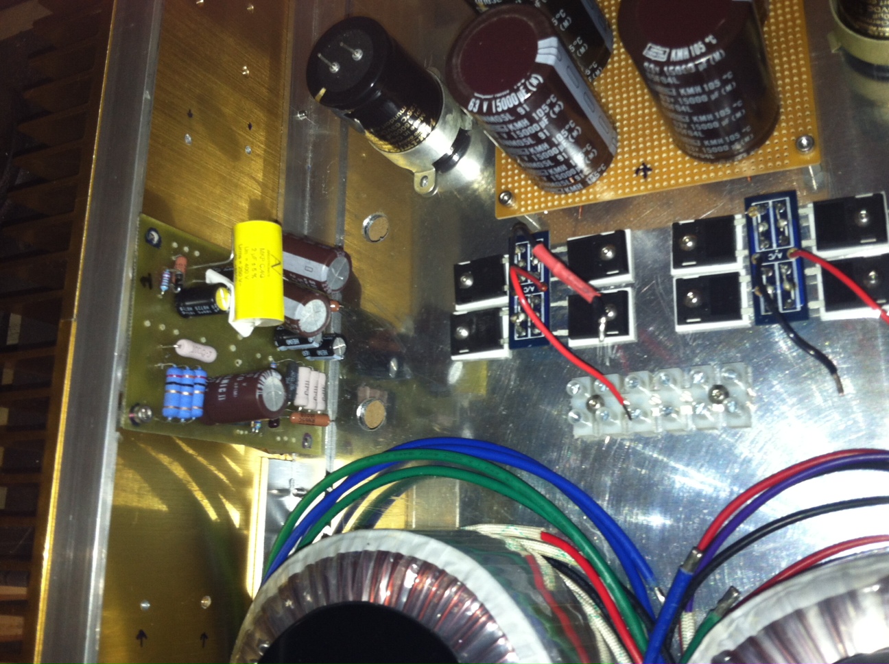

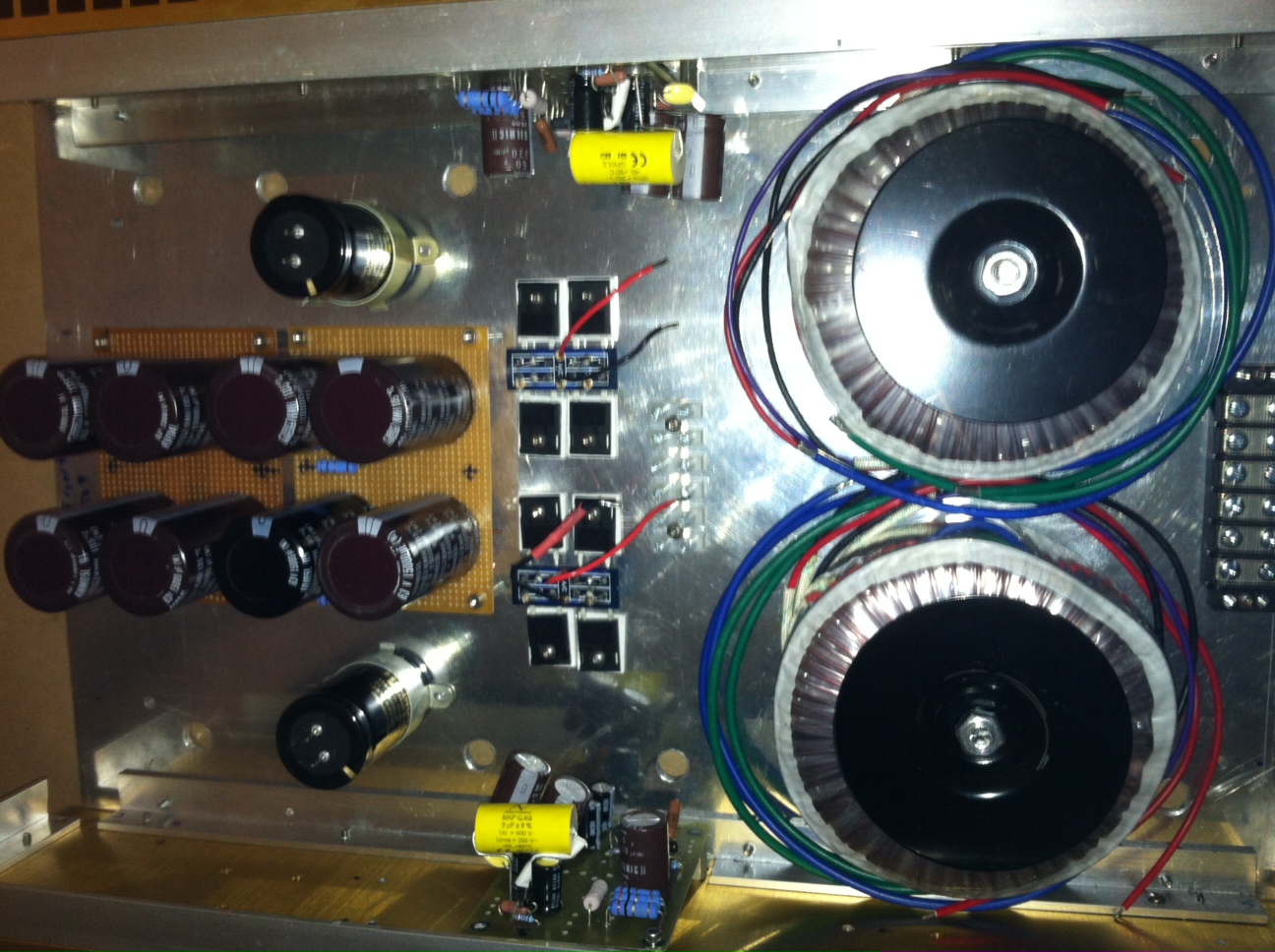

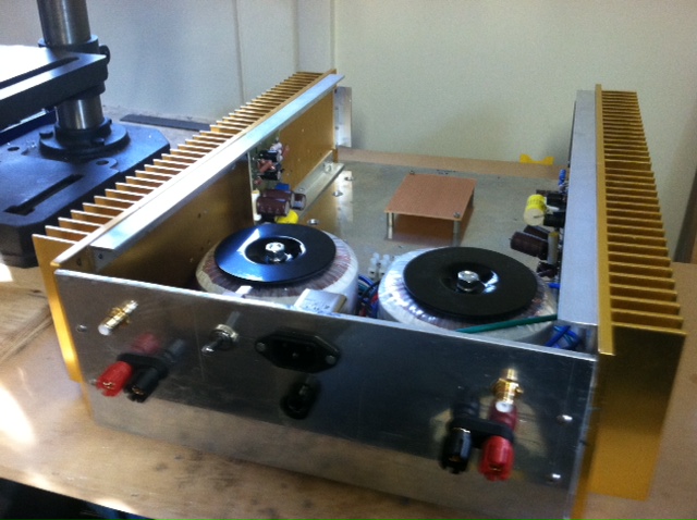

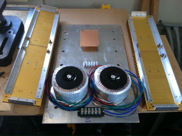

here is a pic of my work:
attachment.php
it is only a 2HE case but coupling inner and outer heatsinks works well.
Temparature is arround 45°C at the inner HS, outer 3-4 K less - sometimes it is not too bad to live in cold germany😉

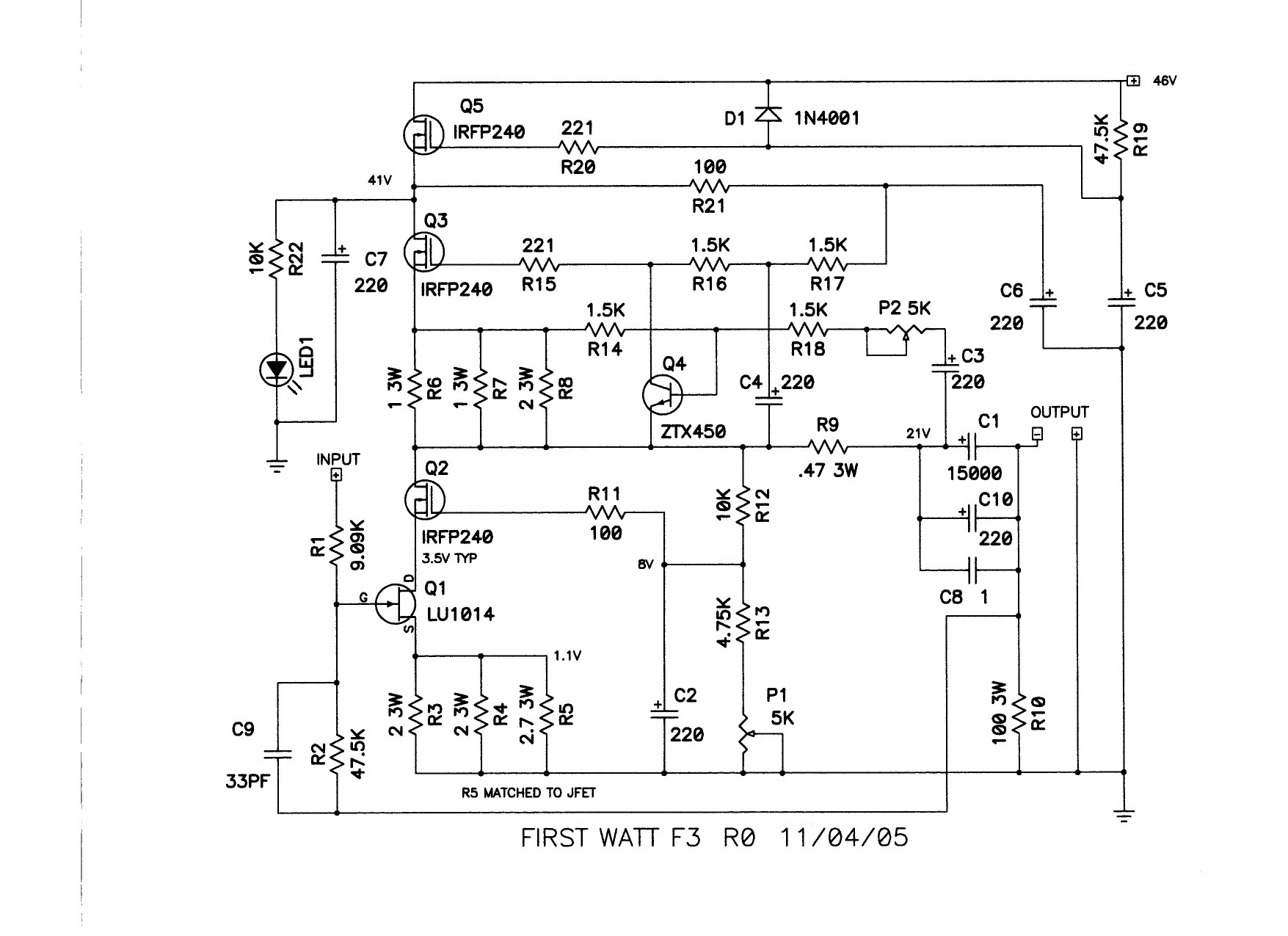

Here is the schematic I used:
attachment.php

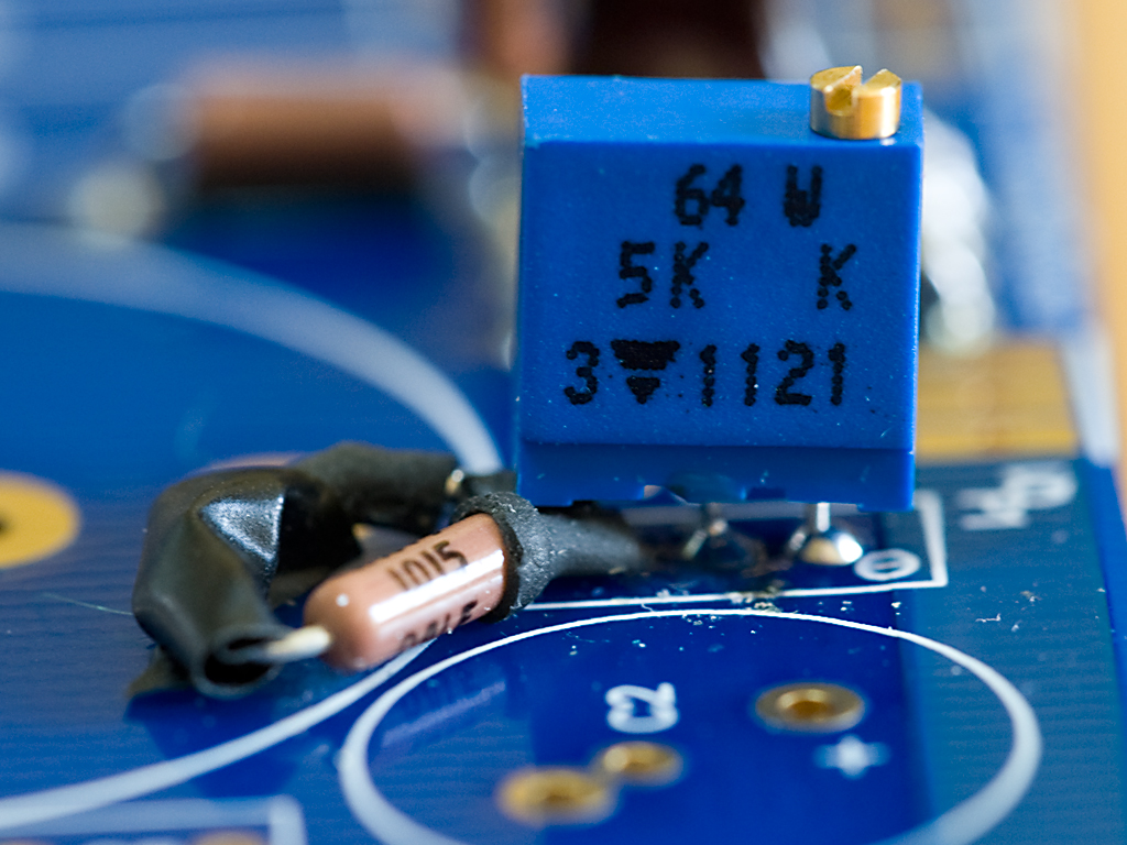

just have a look to your boards.
On my boards there was no space for R13 (4k75 pre res for P1) and R22 (LED). If on your boards also R13 is missing you should better use a 10k trimmer for P1 instead of 5k.
R22 I attached direct to the LED in the front or rear panel.
HTH & cheers
Thorsten

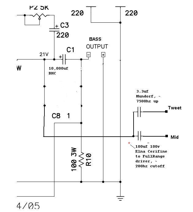

I'm considering aaditional capacitor at the output to feed tweeter speaker in two way system, like Peter Daniel suggested.
I've got battery of 16 ELNA simlic cap (15x1000UF+220uF) at the output already. And hesitate to do that because of voltage-current phase shift
which was decribed by Vladimirk (above). Does that mean instead of one 1.5uF cap for tweeter I should also use 15x0.1uF to maintain
the same or similar dielectric losses angle ?
