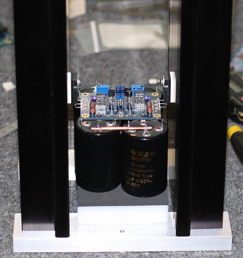

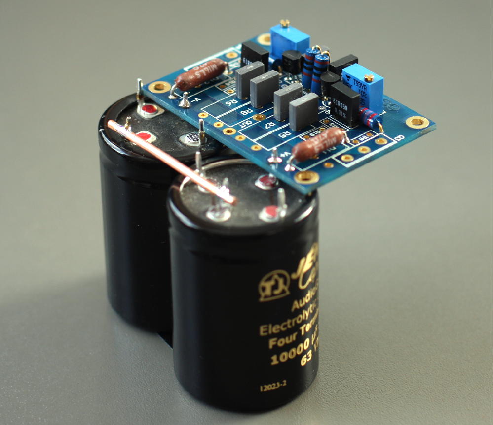

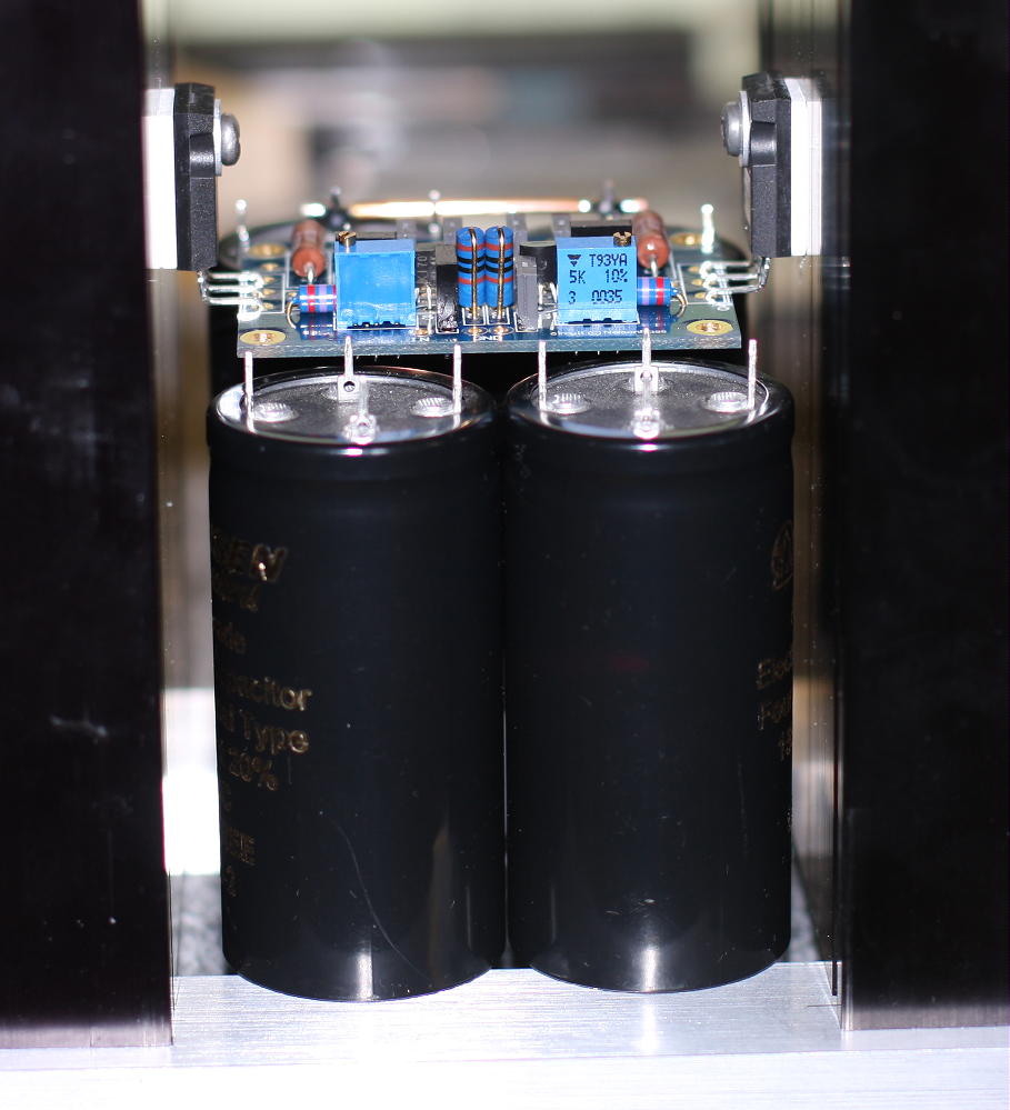

Indeed, there are no small caps on the amp board, and I don't see a need for any additional bypasses, but I mount my electrolytics directly on amp board 😉
The picture also shows what resistors I'm presently using.
Peter,
So two capacitors per channel - what look like Caddocks, Mills and Rikens resistors, but.... how do you attach the output devices to the heatsink - it seems that they must be mounted near the edge of the heatsink.?
So is there anything left on the capacitor board?
Would you be using the copper bar then as your star-ground?
