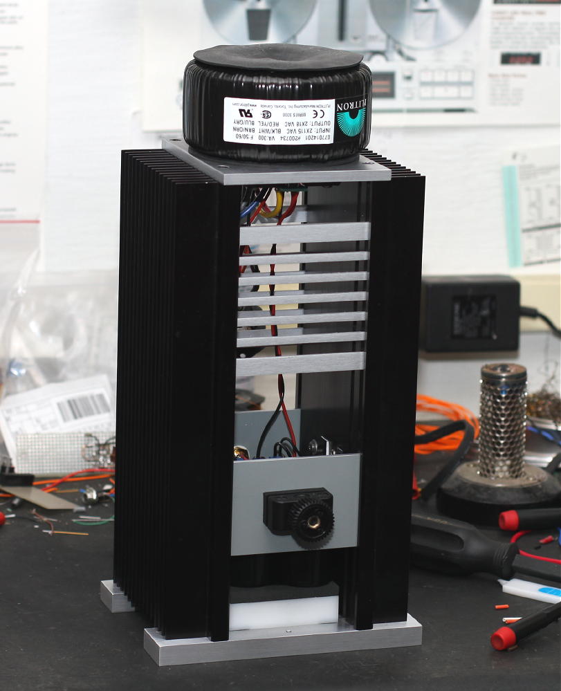

That amp would lok pretty good if it wasn't for the transformer on top 😉 I might do something about it later, but for now I didn't have much time.
As usual, magnificent execution
My imagination cannot conceive of a better way to package an amplifier. Of course, my imagination would have never come up with THAT, but once seen one knows that THIS is how it should be done if only one had the skills.
Mr. Pass has an unique understanding of electronic circuits but Peter Daniel has this same level of conception for execution of the circuit into "productum". I suspect even Mr. Pass took a longing look at your work.
I guess the pads looked like some kind of metal intermediary between
output device and heatsink. Your other photos make this plain to me now. Thanks for the clarification.
Beautiful.
