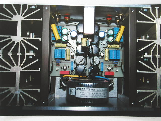

woodturner-fran said:
Peter...... whats your opinion with the gate resistors (R13-14) when using the flying wires? Should I just put in a wire link for R13 and 14 and then mount the resistor right on the gate of the mosfet or leave it as is on the PCB. Wires are about 2-3" long.
Well, I can't be certain, but most likely leaving resistors on a board will work fine. I've built Zen amp with wires to output devices 4-5" and never had a problem.

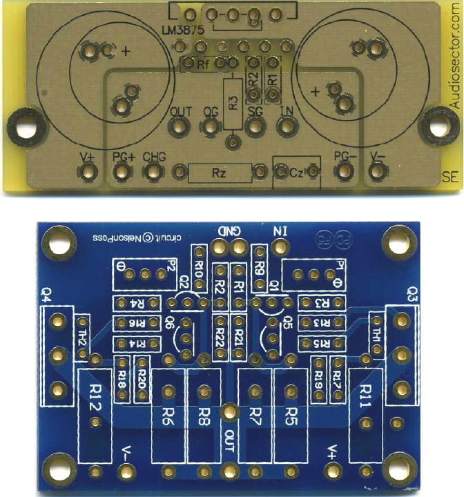

Re: Second set received
AlanElsdon said:
Peter,
Second set of boards received - much faster than the first. They as usual look wonderful.
The F5 amp boards - I take it that I got four channels - I cannot believe that they are that small - almost down to Gainclone / Chip Amp size.
I like some others have ordered the F5 kits from Tech-Diy - I have no problems with vertical mounting of the resistors - what i would ask is why you chose the resistors you did - sound quality or better layout?
Thanks as always Peter - and as with others thanks to Nelson for allowing us to do these group buys.
It looks like small parcel airmail is much faster than letter mail.
Actually, the F5 board is almost the same size as GC board (0.5 sq" difference)
I chose shorter resistors footprint mostly for compact layout, but also with intention to try either Caddocks or Vishays, especially when only few resistors are needed. The miniature resistors are quite popular and cheap, so it shouldn't be a problem sourcing them for that project.
