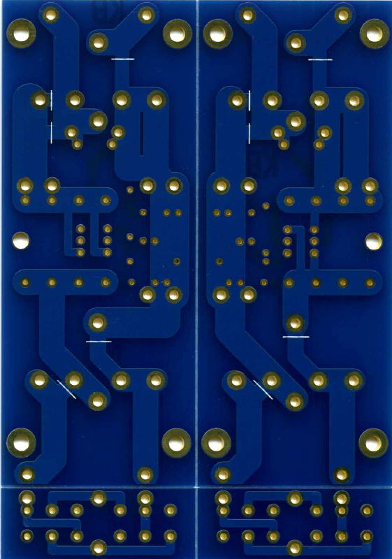

Is there a post somewhere that discusses the power supply capacitor and resistor options? Is anyone using Jensen 4 pole capacitors in the power supply? Is there a picture showing which traces to cut for the Jensens? Just curious. Thanks.
This link show some PS board configuration options: http://www.diyaudio.com/forums/showthread.php?postid=1237660#post1237660
As to Jensen 4 pole, it was explained here: http://www.diyaudio.com/forums/showthread.php?postid=1237678#post1237678
I have those caps and plan to test them against Sikorels I'm using presently.
Percy used to have a special on Nichicon Super Through 15,000uF and this is what I successfuly use in F3.
Any other cap should fit on those boards as well. As to resistors, use either 4 x Panasonic 3W or 2 x Mills 5W as powerwise it should be close. The combined parallel value should be approx 0.1R

Peter, thanks for tolerating my numerous questions. I know you've posted the reference to the diode options three times now. My power supply boards don't have the bottom silk screen showing where to cut for the Jensen capacitors. Can you show where to cut for the other 2 power supply caps at the opposite end of the board (your photo only shows one end). Earlier, someone expressed concern for the Jensen capacitors' getting too warm. Is this a legitimate concern?
It looks like you have also made provisions for Caddock Cool Pak power film resistors on the PS board. True?
Finally, is there a schematic somewhere that you are referencing for the PS board that you are shipping with the F5 board?
Thanks.
Indeed, the first batch didn't have those lines, only the boards made with F5 order, see attachment.
I also read that caps were getting hot, but didn't test it myself, and should be doing it soon.
Those are not for Caddocks, the board is universal and so suitable for other application, like regulated PS for line stages etc: http://www.audiostereo.pl/zalaczniki/1255687_1.jpg
The populated amp PS board will look like this:
The F3 PS board, being not symmetrical, has provison for even larger, screw type capacitors:

I realized that the holes on the PS board that I thought were interchangable for metal tab resistors are actually for regulators after I studied the board more carefully. Brilliant design. Kudos to you. Thanks for the clarification on the board modifications. Nice work. I like the idea of using capacitors with screw posts for repairability, but I will likely stay with through hole mount caps for ease of mounting it all. I may wait until there is more info on the Jensens before pulling the trigger.
