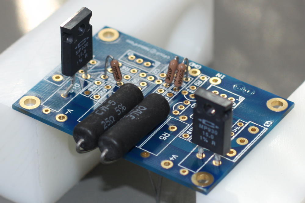

Issues with the Tech-DIY.com parts kit for F5
Peter,
I see where your F5 board has an extra pad for a radial R11 0.47 ohm resistor, but I don't see where the extra pad is for a radial R12 0.47 ohm resistor (see photo).
Next, the two trimmers that I received from Tech-DIY.com have staggered leads, one of which must be bent to fit the current hole pattern on the board. Plus, the axial resistors supplied are very nice Dale pieces, but they must be "stood up" to fit. To me this make it look particularly amateurish. Finally, the Tech-DIY.com F5 kit substitutes 50 ohm Dale resistors for R5&R7 as well as for R6&R8. This huge resistor must also be "stood up" on the board. However its leads are about the same diameter as the holes. The fit is extremely tight. Users may need to drill out the holes to get both leads in the board. Other than that everything is fine--sarcasm.
If you are particular about things like me, do not buy the Tech-DIY.com F5 kit expecting to use it with Peter Daniel's F5 boards. The parts quality is high, but the fit is not so good. I won't use the kit, because I want a better appearance. It's my fault, but maybe others can learn from my mistake.
orthoefer: See my post back up a little. I bought those same CMF55 size resistors but directly from mouser, not through tech-diy. You can make them look a little neater (well in my opinion anyway) if you stand them straight up like in my pic above.
You could also mount the bigger 50R ones in a similar way. A little of teh smallest size of heatshrink on the bare wire lead leaves a fairly neat job.
I know what you mean. See a few posts back up on this page about me missing Peters recommendation for the CMF50 size rather than CMF55.
No reason to ditch the kit I think. In fact I'm sure someone here would use it if you don't.. :)
Fran
Attached picture shows placement of radial resistors: R12 requires a bit of pin bending and it's due to Q5 being 180 deg opposite to Q3 so the V- supply pin is now further away and I couldn't place the pad las on the other side.
You can still install Dale power resistors normal way, just fold the pins over the PCB edge and solder them underneath. That also reguires attaching output wire underneath the board.
However, the board was designed mainly with a thought of 3W Panasonics or 5W Mills.
As to small resistors, there absolutely shouldn't be a problem placing them vertically, especially when you already using radial power resistors.
Bending the pins on trimmers shouldn't be a big deal either, I did it many times before. It's still nothing compared to complete amps done p2p ;)
