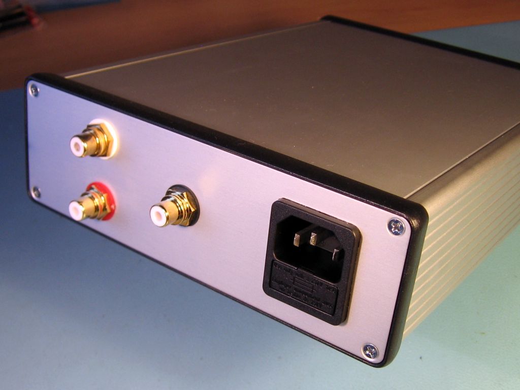

I finally got around to wiring up my ezdac. I always dread having to drill out and file an IEC power inlet. I used double sided sticky tape to mount the ezdual (for now). The Lansing case I picked for it has a vinyl coating on it (so my ezdual should be safe).
I've got to power it up and test it now. I know I'll have the right voltages out of the ezdual.
Yes, that's absolutely one of the most annoying things to do :yes:. I always do it first, to get it over with. I usually mount them from the back so the hole isn't covered, but last time I used a few snap-in units, with integrated fuse. They are very easy to mount and the hole is a simple rectangle. The edges don't have to be that straight because the inlet covers it 😀.
Fingers crossed...
Ray

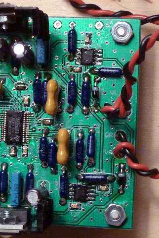

Differential Signal Traces/wiring
Reviewing the attached notes on "Differential Signals" and their paths (traces), I now see a preference (real or imaginary here?) to maintain the receiver OPAmp on the EZDac board, rather than bringing it out to a companion board with the Headphone Amp. I was hoping to use of some of the AD712 OPAmps I have on hand (not SM frames).
http://www.ultracad.com/articles/differentialrules.pdf
Anyone here do the "off board" receiver mount? .... any EMI pickup problems?
Louis

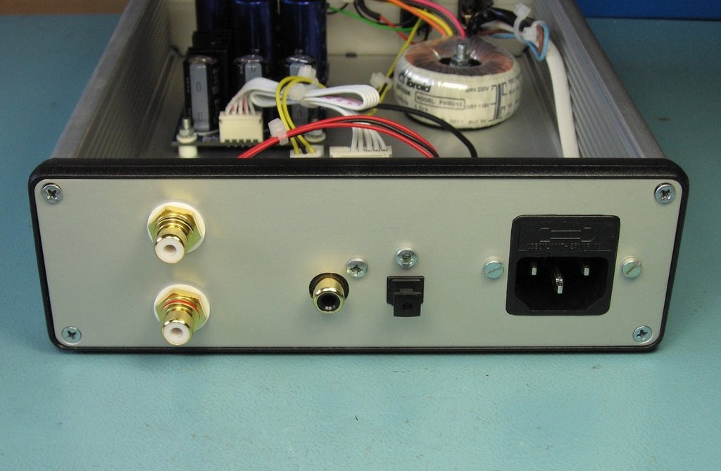

Hi All,
I finally got around to installing a second PSU to separate the digital and analog sections. And while was at it I also installed a TOSLINK optical input module. Ao I can input either optical or coax by fliping a switch.
The extra PSU did make a noticible difference for the better. The DAC seems to have more depth, detail, and dynamics. Very nice.
PJN
Louis
No, not me Louis, I use the on-board opamps. I can imagine doing the I/V-conversion closest to the DAC gives best results, but it would be even better to use separate opamps for both current outputs, and do the summing with a third (or use an other solution for that, maybe discrete). But the DAC outputs are current-out into a low impedance (I/V resistor or something like a virtual opamp ground if you use off-board solution), so noise and other disturbances have a limited effect on this.
Hi All,
PJN
That's great, I also noticed improvement doing this. It reduces digital noise entering the analog section. You should also try the luxury version with separate discrete regulators for each supply 😀.
Ray
