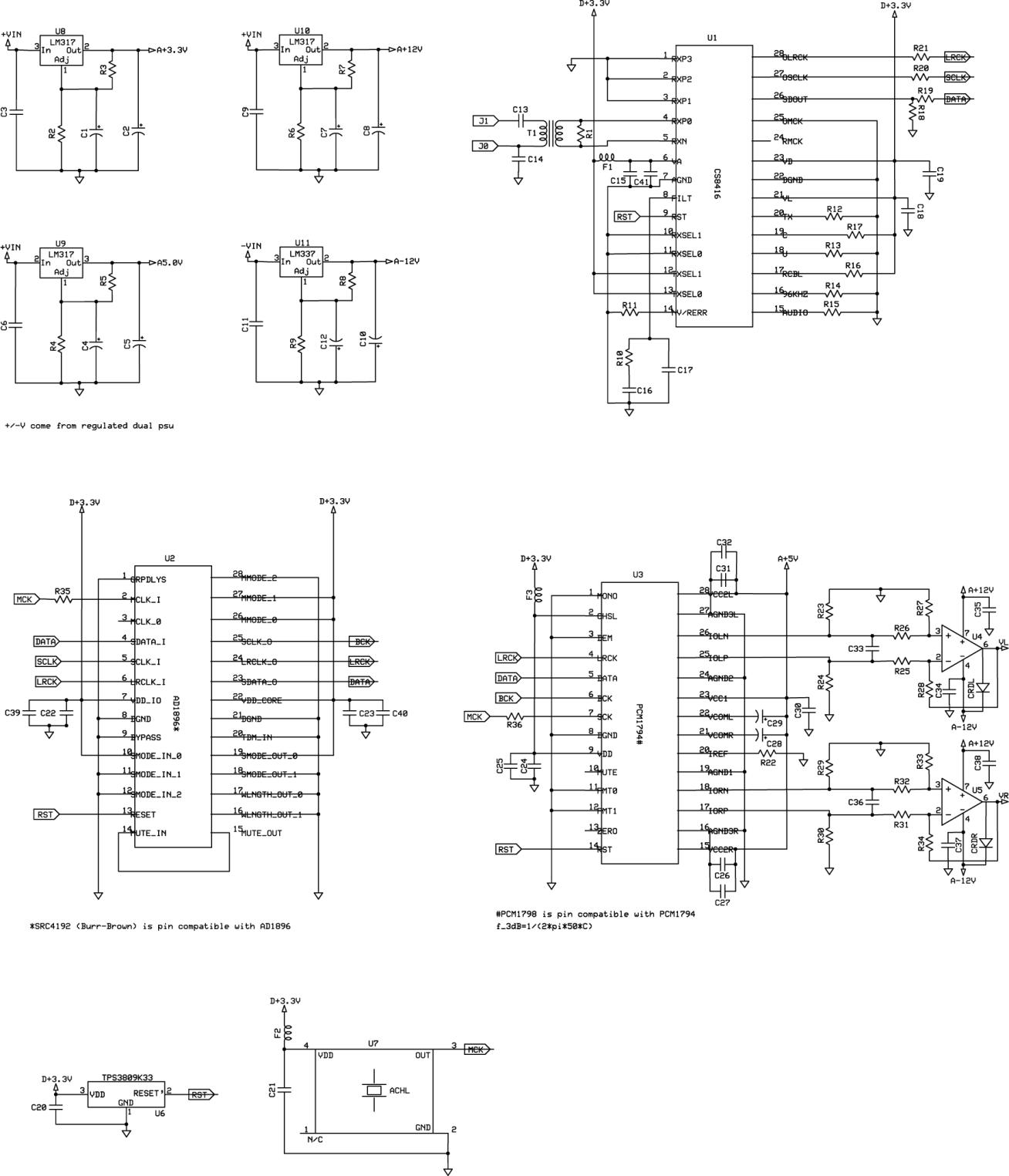

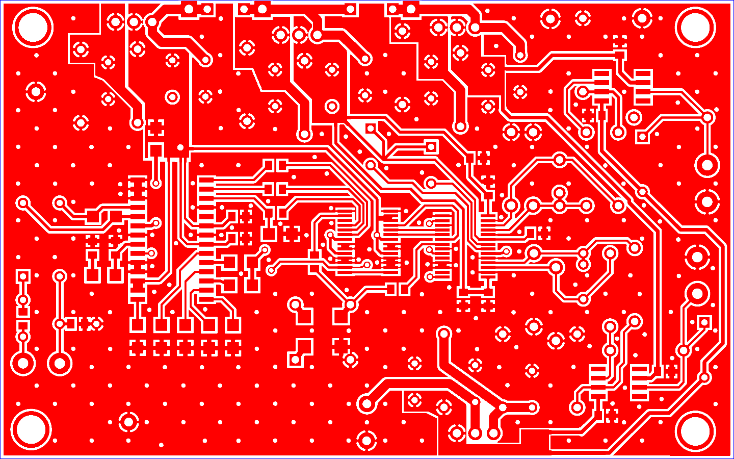

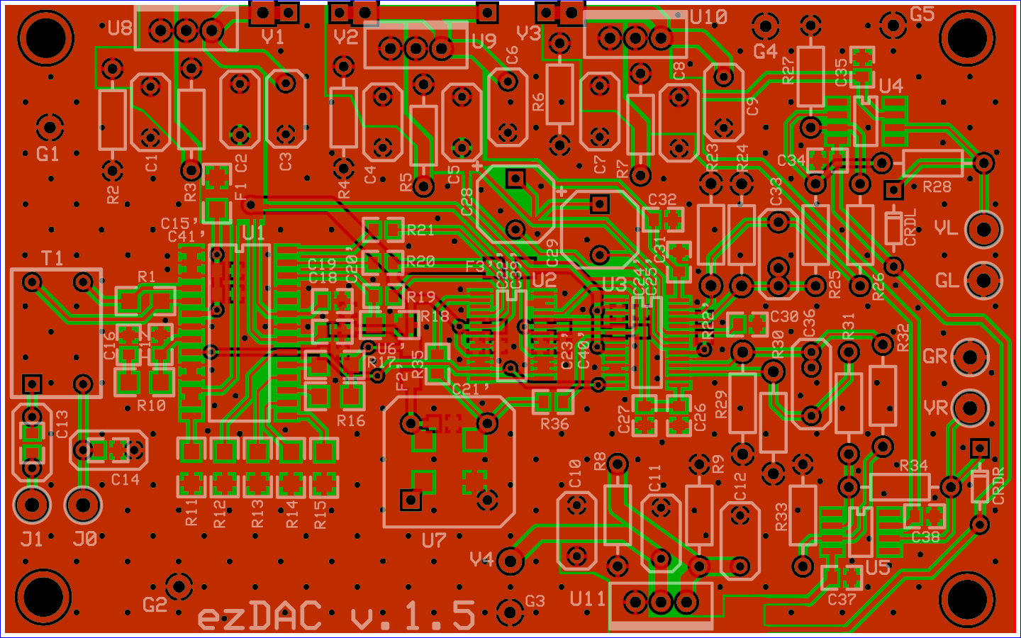

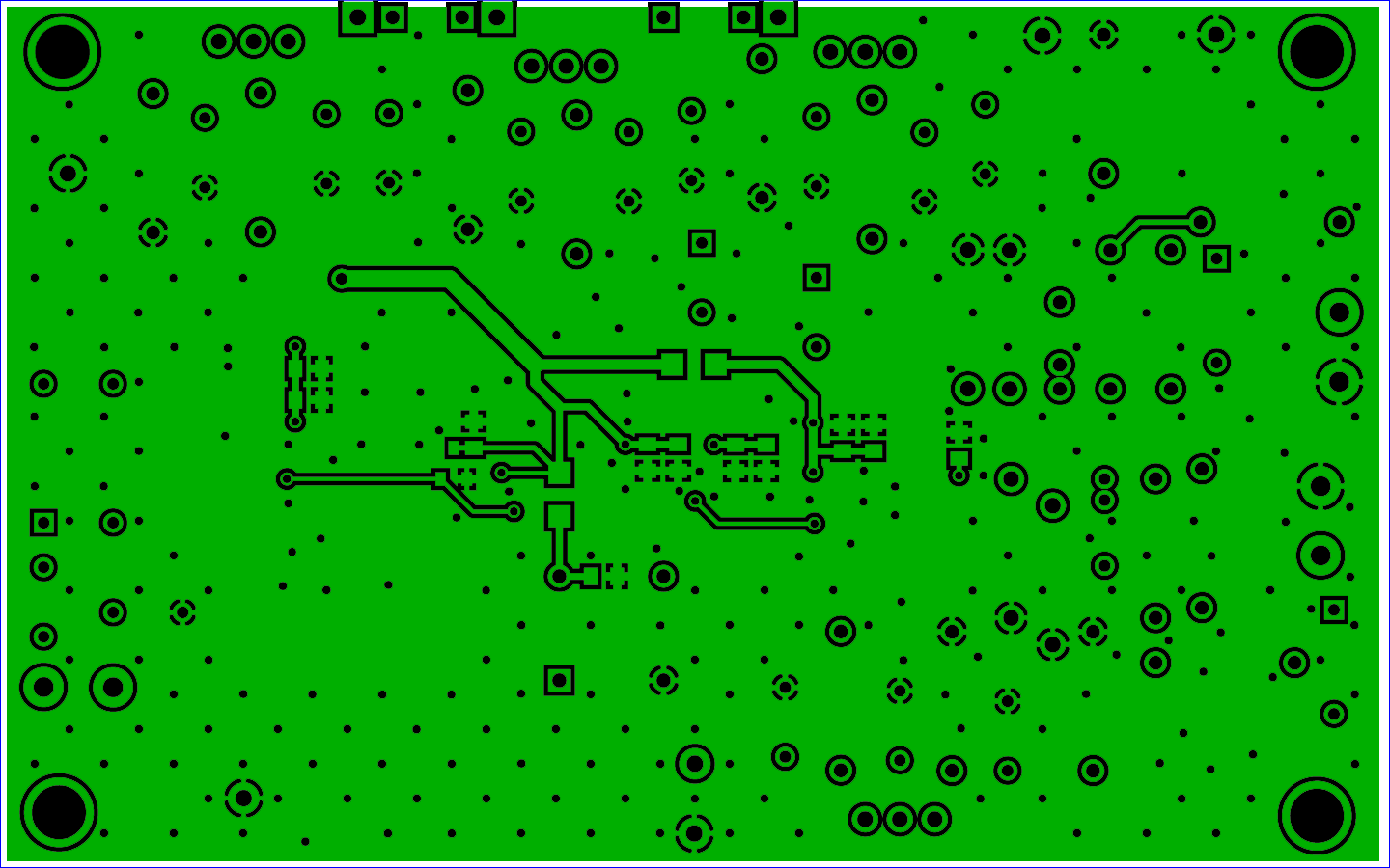

Sadly, http://ezdiyaudio.com/ doesn't seem to be working anymore. I attach the schematics, the BOM and the PCB artwork from the original website. The rest of the website is currently available from the Internet Archive.
  • BOM_v1p5.pdf
    BOM_v1p5.pdf

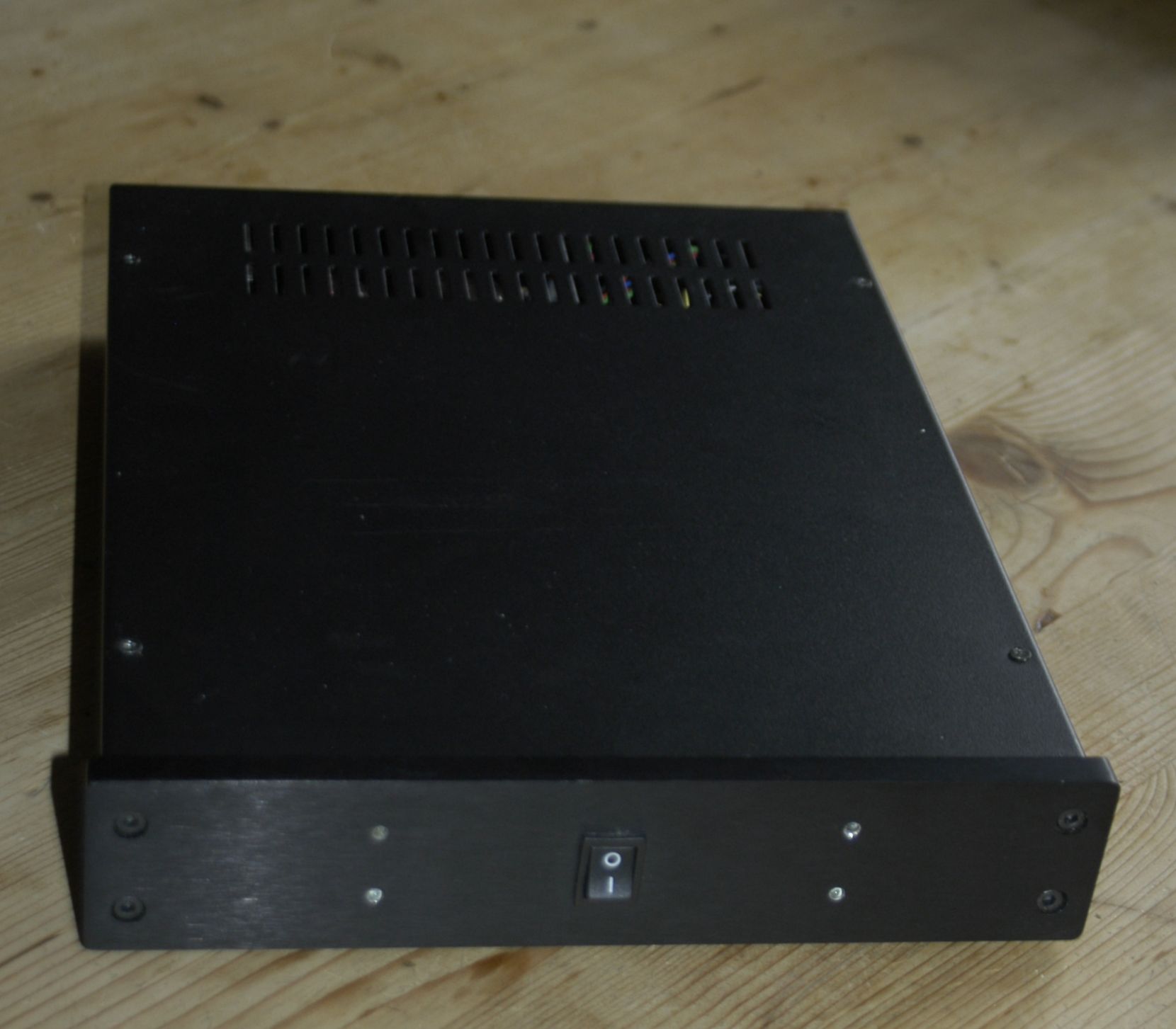

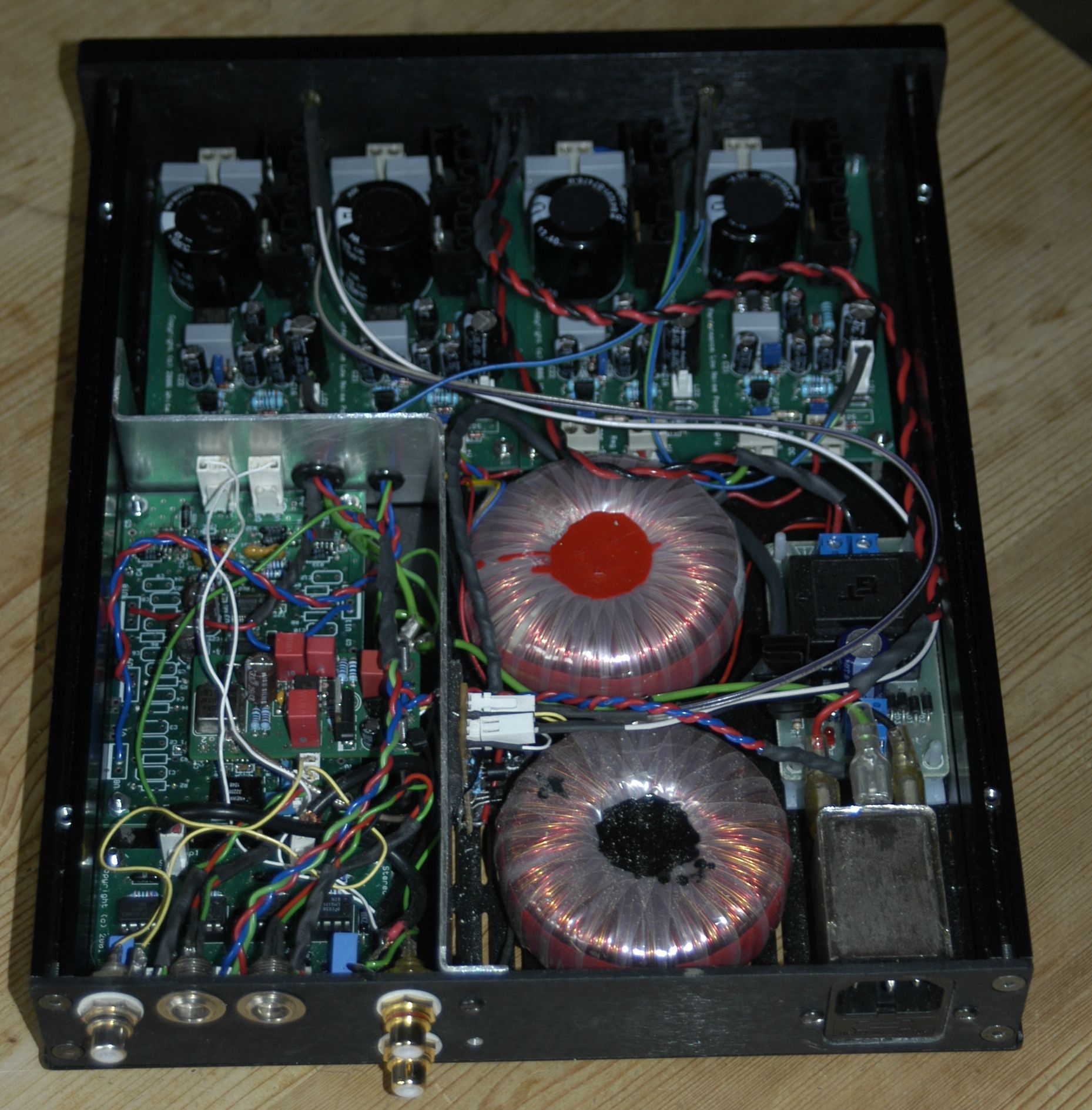

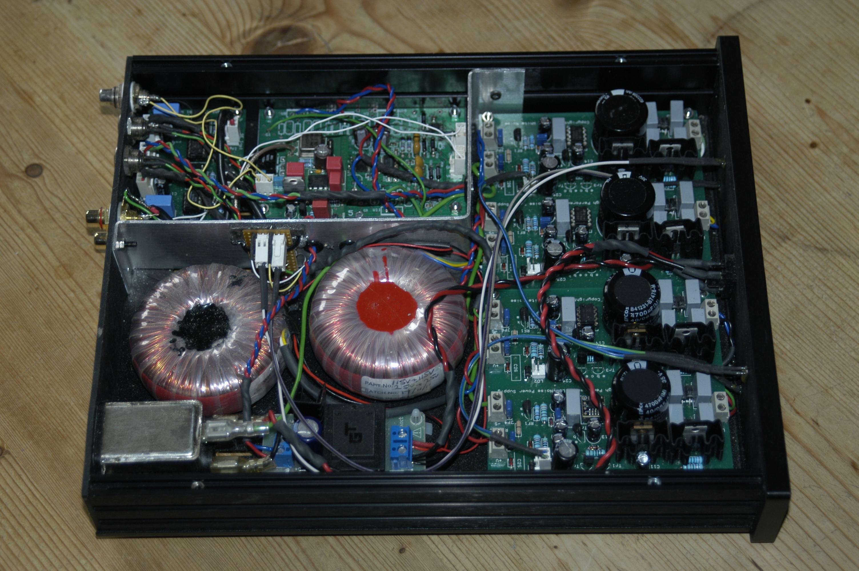

Yes it is mostly power supply but the result is worth it.
How does it sound? - I find that a very difficult question to answer:-
About 6 years ago I had a dCS Delius DAC and Purcell Upsampler. Didn't buy them new - couldn't afford that - but got them reconditioned from dCS for a resonable price. I was usind a squeezebox receiver as source and using 4 WNA MOS125 power amps to bi-amp various speakers (Mission 757, 782 - I change speakers quite often or I did 'till I aquired a pair of Pink Triangle Ventricals) Anyway I was really happy with that sound - it was very musical, warm and detailed. Never tired of listening to the system. My ezDAC is very similar to that system although I'm now using a Squeezebox touch and am listening to 24/96 music (Same amps and Pink Triangle speakers). I've also recently purchased a Audio GD NFB 3.1 (for when the ezDAC wasn't working) and have been compairing the 2. Keep coming back to the ezDAC as it's so easy to listen to, althought I'm nowhere near the 200 hours that Audio GD recommend for burn in of thei DAC.
