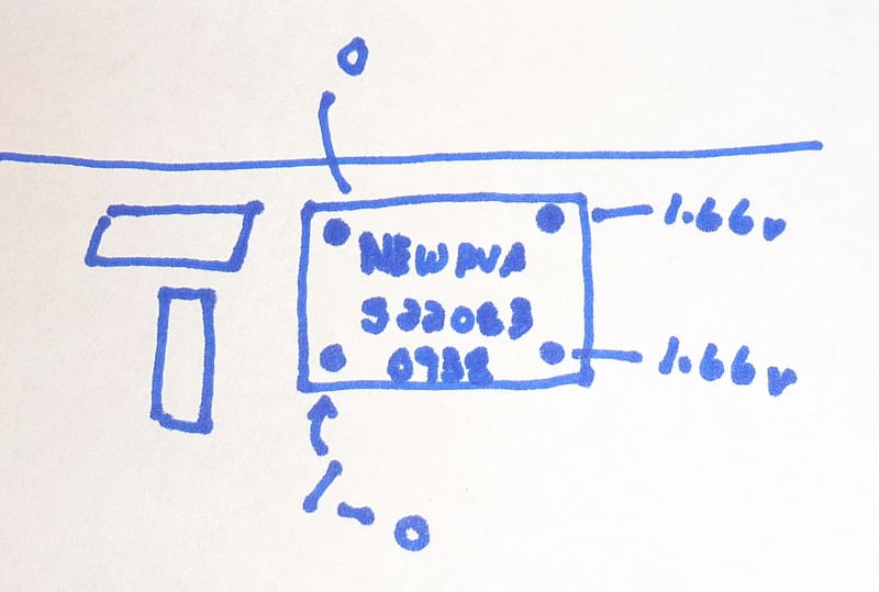

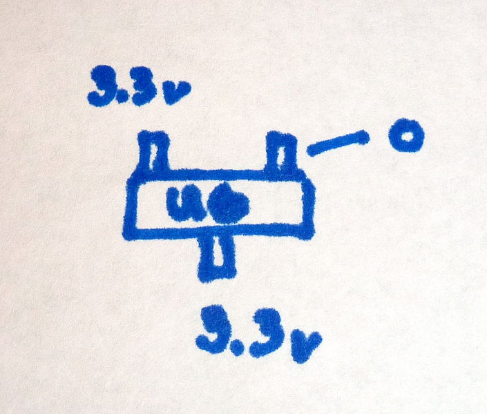

You were right, I had a bad joint on F2, I fixed it and I am getting 3.3v on pin 4 Vdd and 0.73v on pin 3. But unfortunately still not singing.
I checked voltages around U6 and the pulse transformer they are shown in the pics attached.

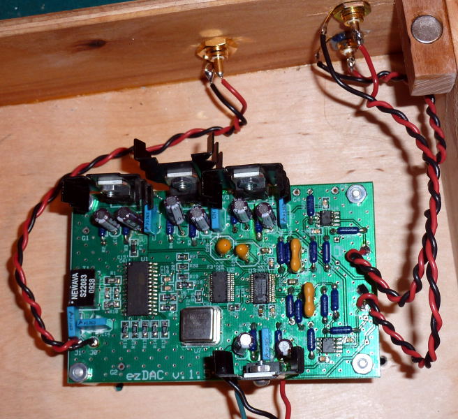

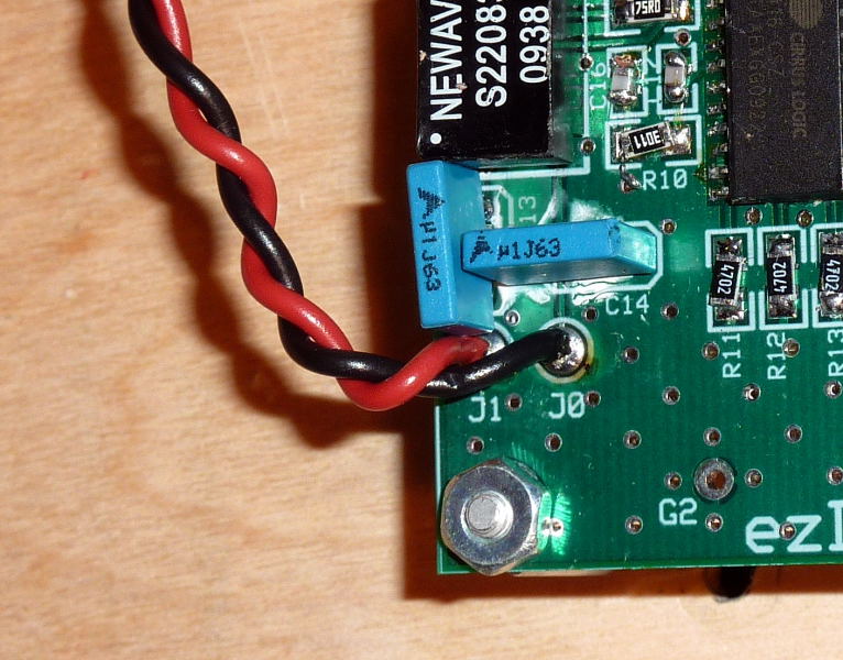

Hi Ray,
Yes I did and I verified that the digital source was working correctly by trying it on my other system. Here are some pics of my hookups. I also checked the rca's back to the board for continuity they were all fine.

Well, I think for further investigation you need a scope, to verify the digital signals between the three chips. It could be something tiny like a resistor or cap in the 8416 PLL circuit, or around the other chips that's causing the problem. A good DMM with frequency measurement capabilities would also work. Then you can verify the bitclock and wordclock signals.

PJN, sorry for saying that, but your soldering looks very messi.
I think you should accept Ray's offer. This was my idea too, to help you
bring this project to a sucsessful end.
All SMD have to be tied up. May be something is toasted or shorted.
Without a scope I guess you have no chance to bring it up to live.
Let me know if I can do something.
regards Michael

I did take Ray up on his kind and generous offer to take a look at my board and he was able to get it singing in no time. He discovered that I had screwed up one of the pads on a cap feeding the reciever and had a loose pad on the reciever. Thank you Ray, I could have never found those faults myself.
So now there is one more EZDAC in the world. My build is the bog standard, single PSU. But so far my impressions have been very favorable. It easily sounds significantly better than the modified DVD player it is replacing. Much more relaxed with very good imaging and detail. I'll let it burn in for a few days and try to do a head comparison against the opus DAC from twisted pear audio that I built last year. They have very similar features. Next moves will be to add a separate PSU to separate the digital and analog sections, and add CRDL and CRDR. I'll report back with my impressions of these changes.
