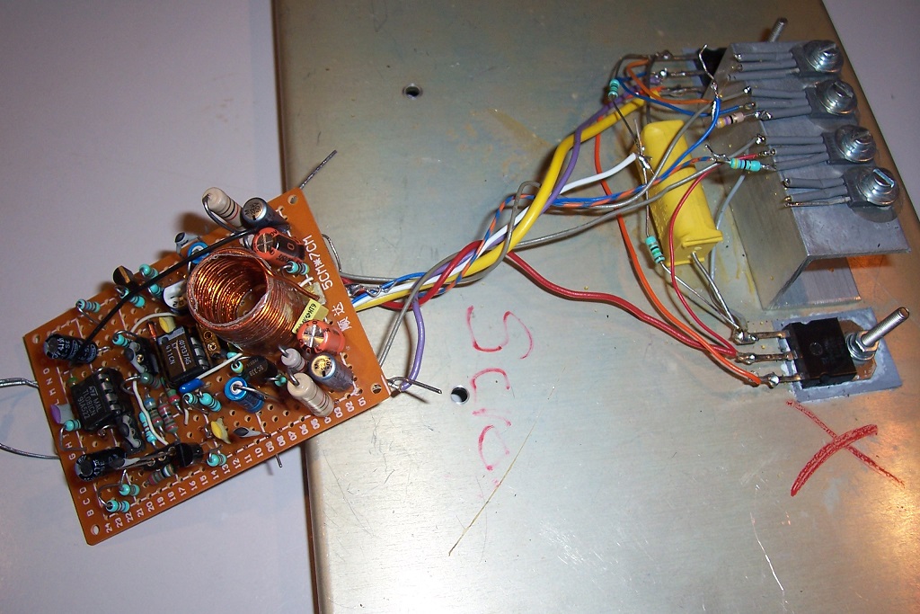

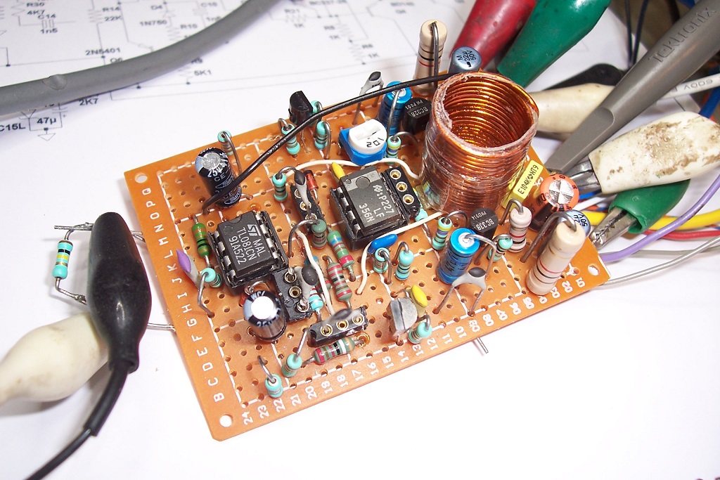

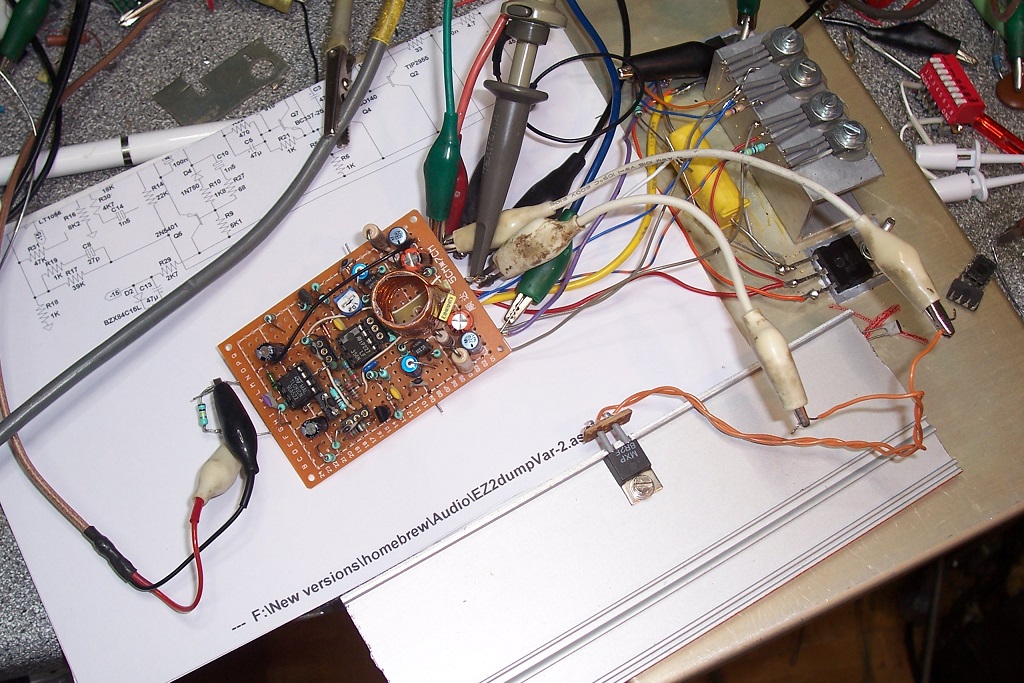

Here are a pic or two of the (now working) prototype:
attachment.php
attachment.php
The main mods I had to carry out is to use a LF356 instead of a TL071, for HF CMRR reasons, and move the collectors of the buffer transistors at a place where they couldn't introduce a RHP zero causing instabilities.
Some verification work is still required before I can release a working, tested and provisionally definitive version.

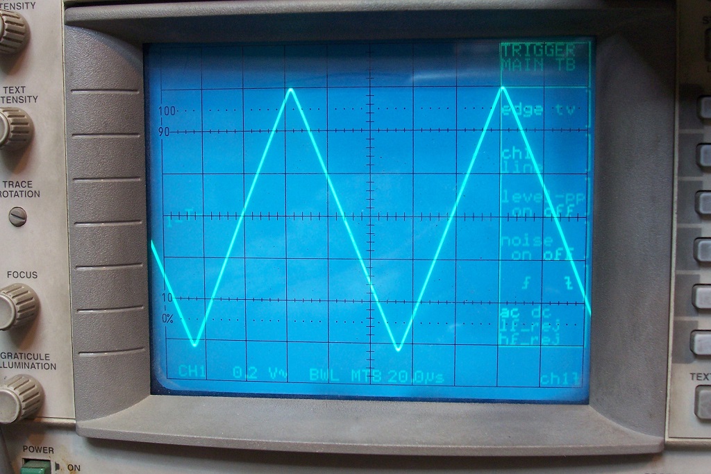

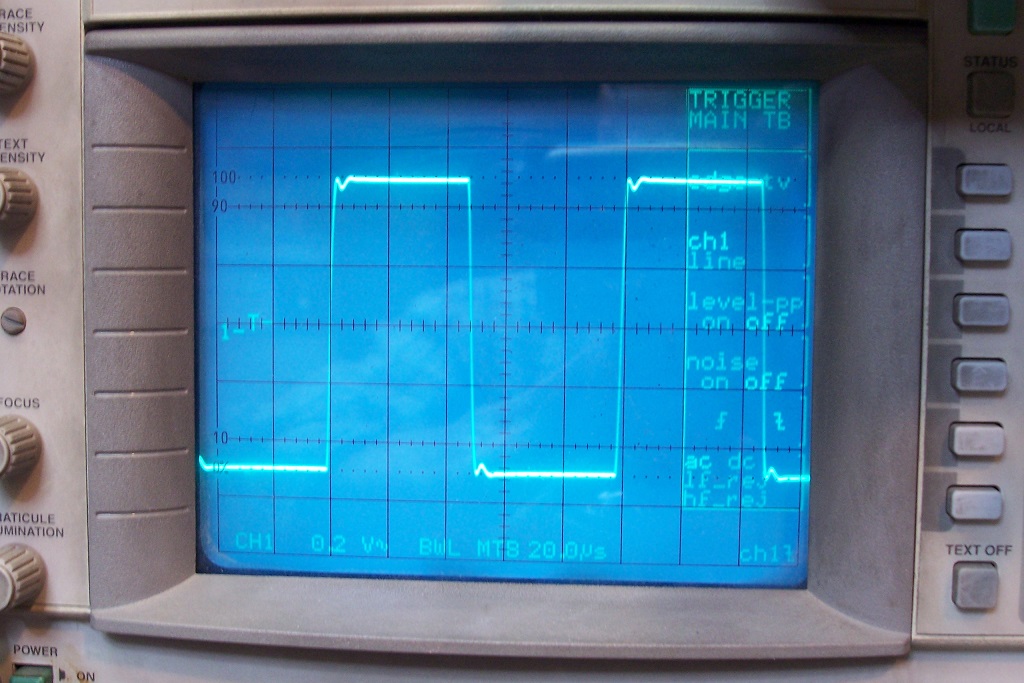

In the mean time, here are some 10kHz oscillograms showing the linearity and squarewave response (op transistors are BD249C/BD250C):
attachment.php

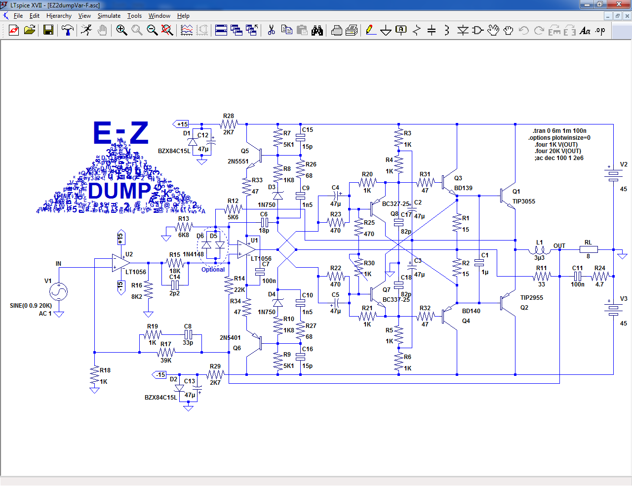

Here is the stable, tested version. It might not be optimal, but it already works well enough:
attachment.php
There are relatively little changes, but they have their importance: the collectors of Q7 and Q8 are now returned to the emitters of the drivers.
These are stable, low-impedance nodes which is important because the collectors carry an antiphase signal wrt. the main output, and if they are connected to the output of the class A amplifier or the class B (or C) one, they can temporarily reverse the phase of the feedback, wreaking havoc in the loop.
Other changes mainly reflect the reality of the circuit: the second stage is floating, and is at a potential close to the output, meaning all of the outside world is "hot", and injects small capacitive currents into every node.
The - input of U1 sees a relatively low impedance, and is not too affected, but the + input is more sensitive and requires a compensating cap C14 which introduces some negative FB.
Ideally, everything around U1 should be guarded by a low impedance screen connected to the potential of the inputs, but such a node doesn't exist in the circuit as it is, meaning other measures are required.
Ideally, U1 should have a good HF CMRR, something the TL071 does not have (it is not specified).
Initially, I was able to get the circuit working by substituting a LF356, but with the additional fixes, any BiFET amp now works, including the TL071.
I also tested a LF411.
The additional mods are the connection of the bootstrap caps to the class B amplifier, base stoppers for the drivers and small capacitors C15 and C16 filtering the HF out of the floating supply controllers.
All of this will be somewhat layout-dependent, because of the floating VAS, but it is a good starting point.
A reasonably compact construction would be desirable: my initial build had random flying wires connecting to the heatsink assembly, but the loop areas were atrocious and caused parasitic inductances and inductive crosstalk, resulting in low-level HF oscillations (~6MHz).
A single twist of the PCB wrt. the heatsink was sufficient to cure it.
Regarding the performance, the CD scheme seems to work perfectly: I can turn the base-spreading pot all the way without seeing any difference, and I am not going to be able to measure the THD directly.
The step response leaves to be desired, but the HF balance of the bridge can probably get a perfect response: partially inserting a ferrous tool into the 3.3µH improves the response to near-perfection: a mix of added inductance and losses.
I have included an optional pair of diodes between the inputs of U1.
They are not required for normal operation, but I noticed that bench mishaps, like a supply wire disconnecting or a probe slip could drive the circuit into latchup.
The diodes prevent such an event, and do not seem to have adverse effects.

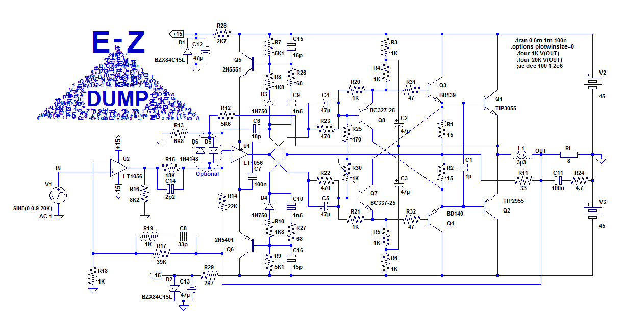

Here is the circuit, updated with the stoppers, twist, etc.:
attachment.php
U1 is the most critical, but now with the mods any type can go anywhere.
The LT1056 is promising: it is more modern, and has better performance than the others (but I don't have one in my stock to test it).
You can install IC sockets and test a variety of different types

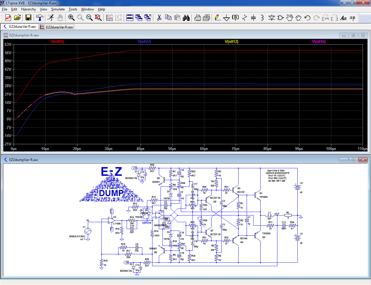

In the end, the simple passive bootstrap seems to have unexpected issues: the latchup occurs as soon as the input stage is included in the global loop, not especially with the rationalized single bootstrap I tried earlier.
I have tried to adapt the resistors R12-> R15 to keep the inputs within the supply limits, but to no avail.

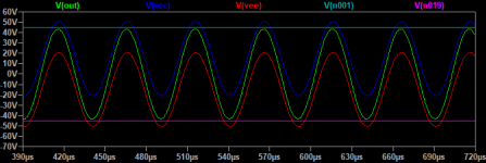

Red and blue traces are the floating supplies, yellow and magenta the inputs.
At some point, the inputs go astray and the circuit locks into latchup:
attachment.php
I tried the same in reality, but it didn't work better: the behavior was completely different, but completely anarchical: huge, uncontrollable oscillations, but no latchup.
By contrast, the active bootstrap remains well-behaved, both in sim and reality.

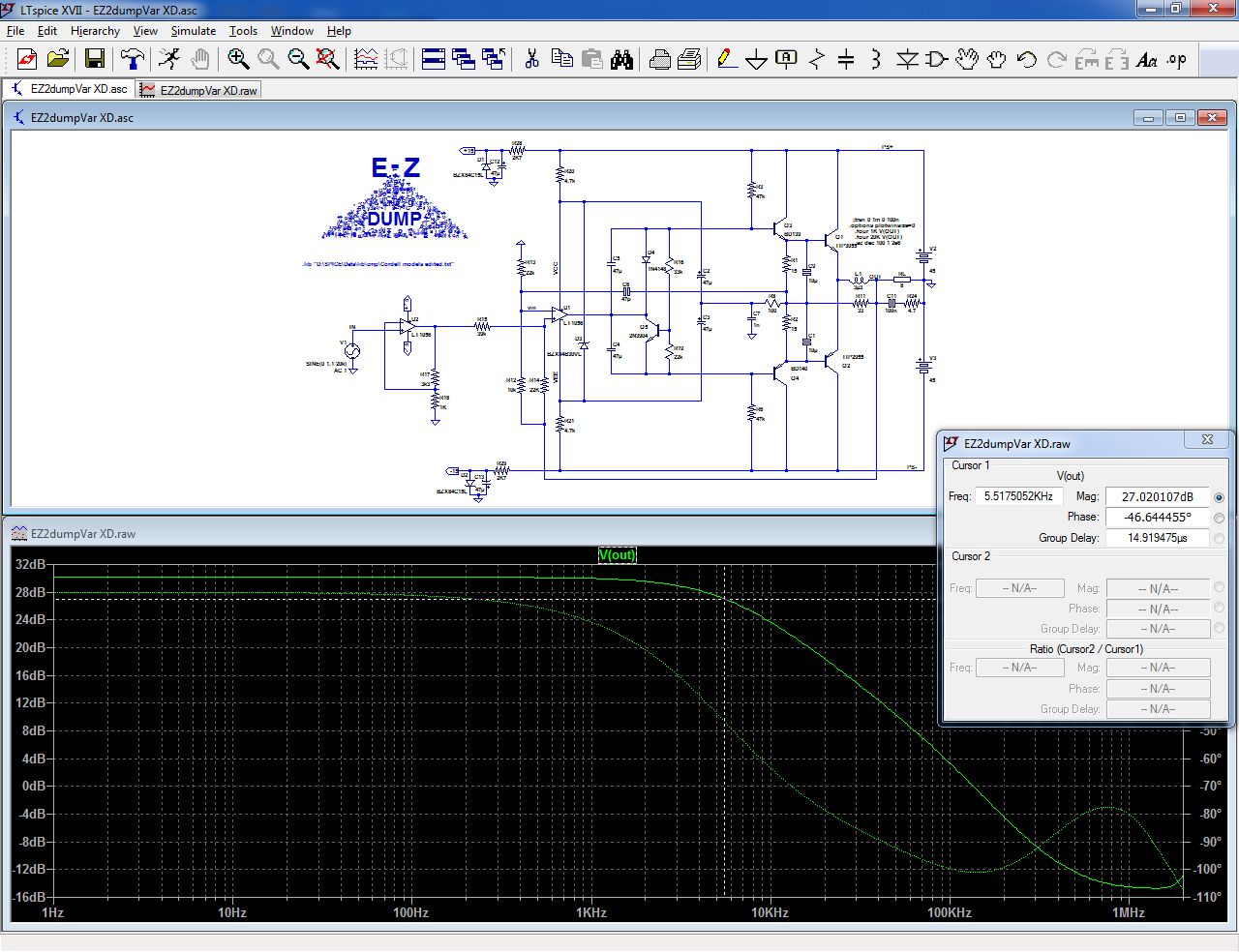

The difficult part of the circuit is the second stage: once it is stable in isolation, closing the global FB loop is a mere formality.
The overall stability is not really an issue, and needs not be conditional: the second stage operates in closed-loop, at a nominal gain of ~5 (it depends on the frequency and the amplitude), meaning the input stage operates at a gain of ~Gtot/5.

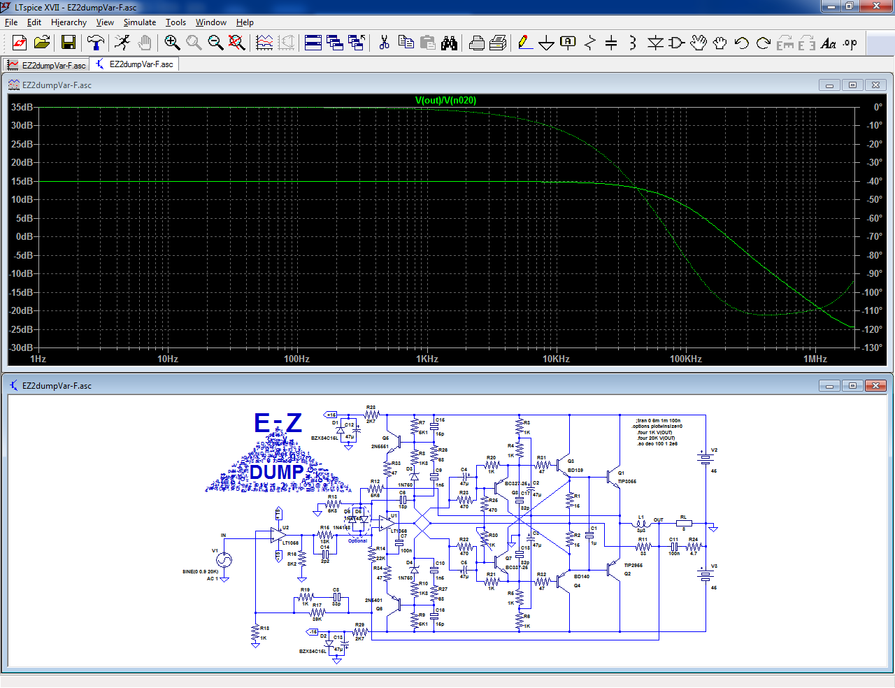

This is the gain plot of the second stage:
attachment.php
Since both amplifiers operate in controlled conditions, at a gain >1, they tolerate two stages + OP in the loop.

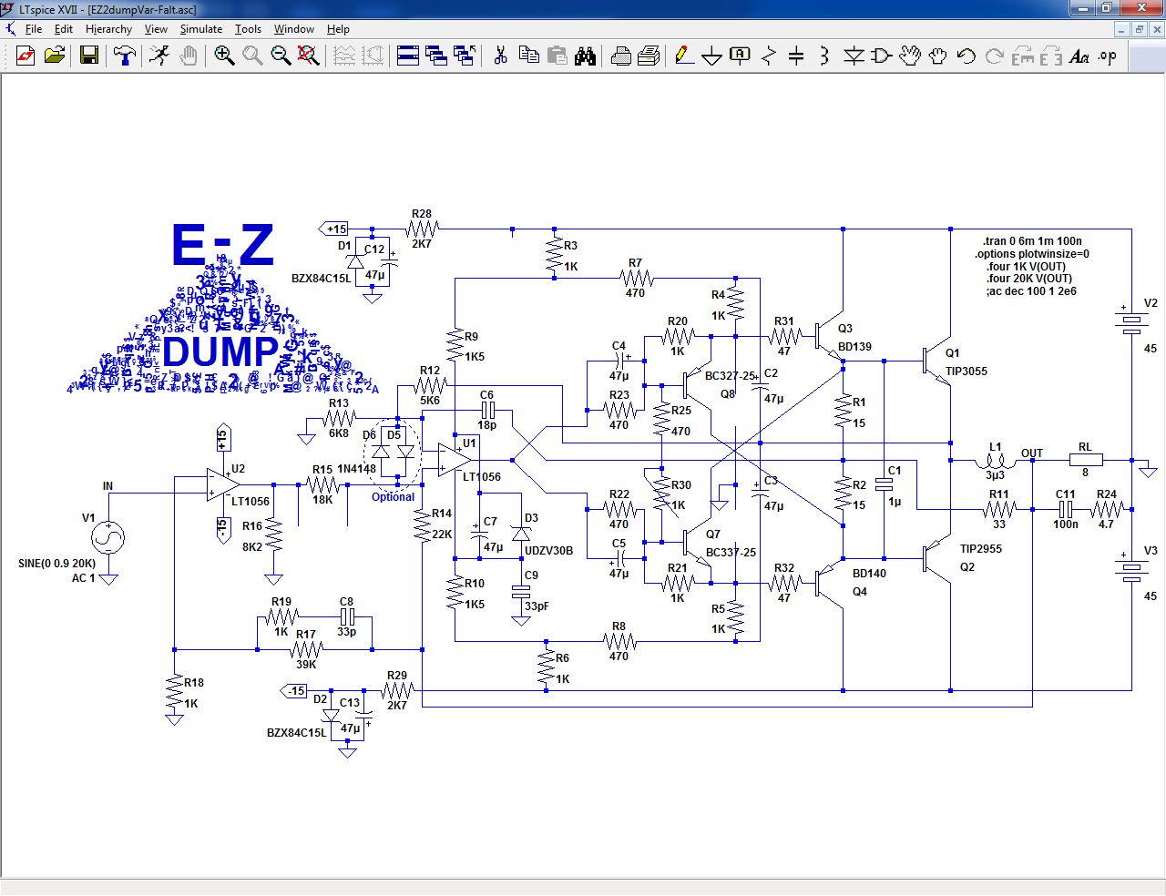

I finally managed to use a single bootstrap in reality:
attachment.php
It is not very docile though, and requires a small capacitor between the bootstrapped supplies and GND, C9.
The value of 33pF is quite critical: oscillations appear for C9<22pF or >47pF.
The instability is completely confined to the bootstrap: the wiring, base stoppers or shunt caps have no effect, and the outlook remains the same for a LF356, LF411 or TLO81.
