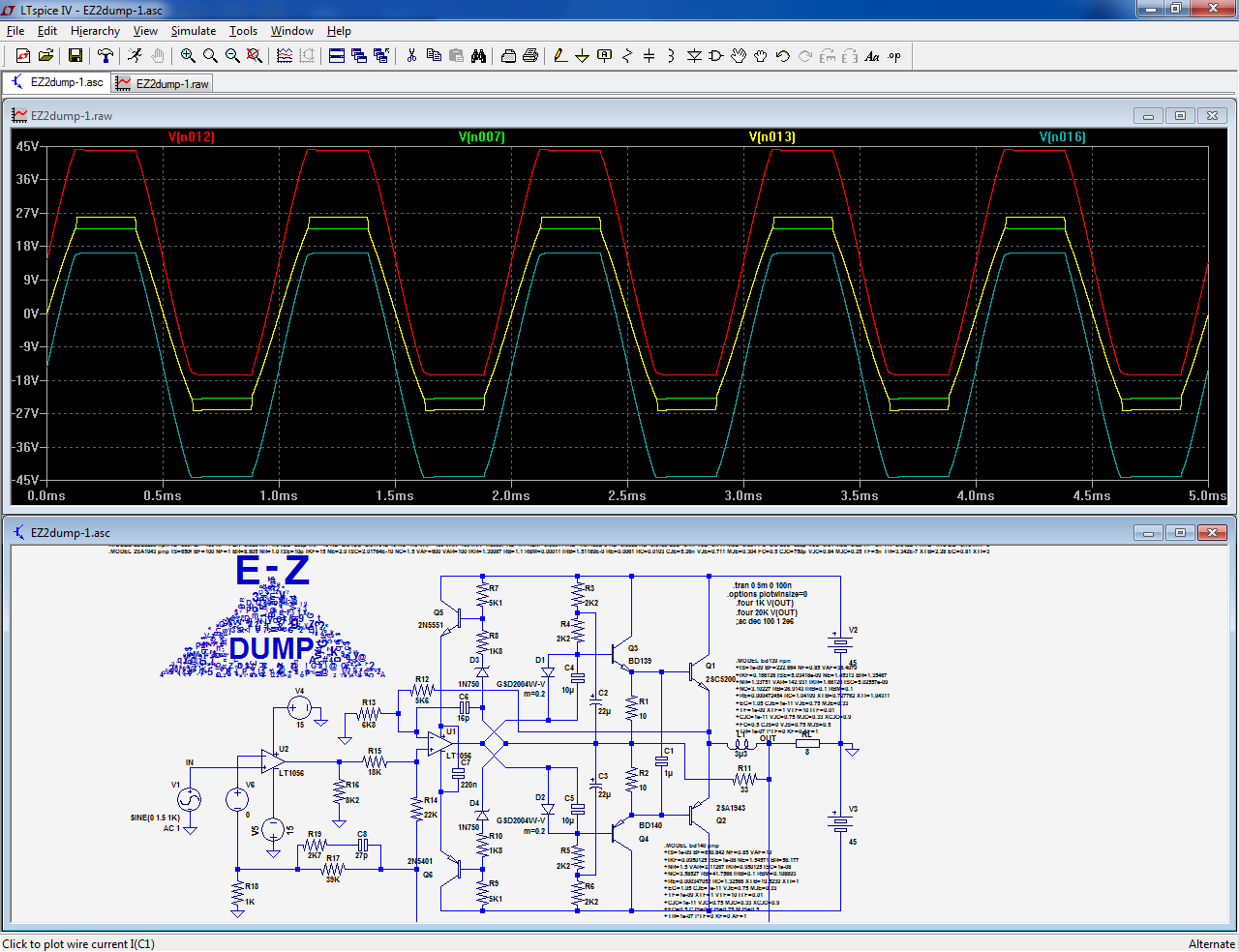

Regarding the CM range, it seems to remain well within the bounds of the bootstrapped supplies, even under heavy clipping.
Red trace is Vcc/U1, cyan Vee/U1, yellow and green in+ & in-:
With a CD amp, some results can look disconcerting, because the modes of operation with just the class A and with class B are very different

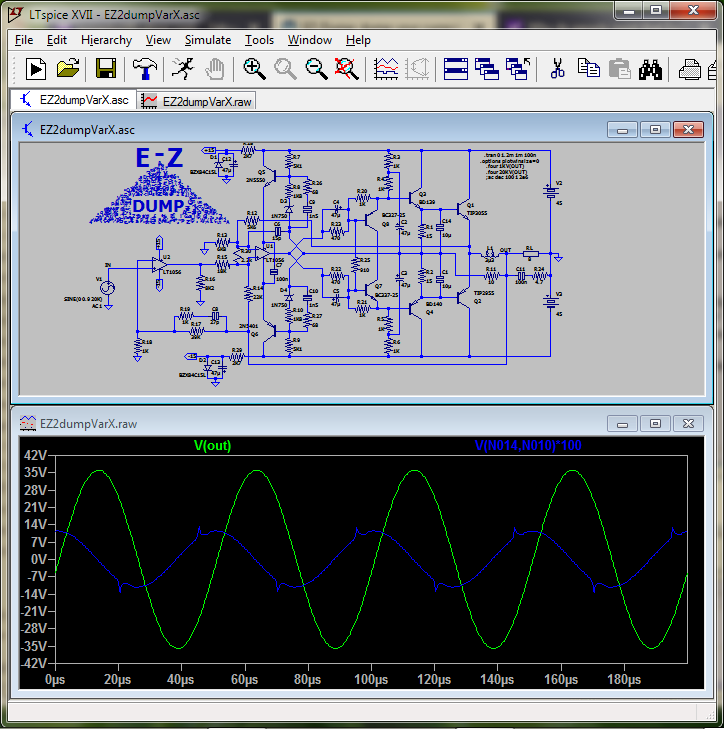

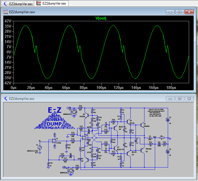

Fair enough. This image shows an example of the instability I see At 20KHz. It is very touchy and different xx3055 or xx2955 models dramatically change the result. BTW, 90VDC is too much for xx3055/2955 so you should use 5200s or similar.
So here are some things that stabilize this circuit.
1. Reduce the op-amp gain by hanging a resistor across in+ and in-.
2. Reinforce the driver coupling to cover the class-C gap.
3. Lift the collectors of Q7,8, relegating them to VBE multipliers with no gain. I'm not sure exactly why, but this helps stability.
When the design is stable, simulation happens in a flash.

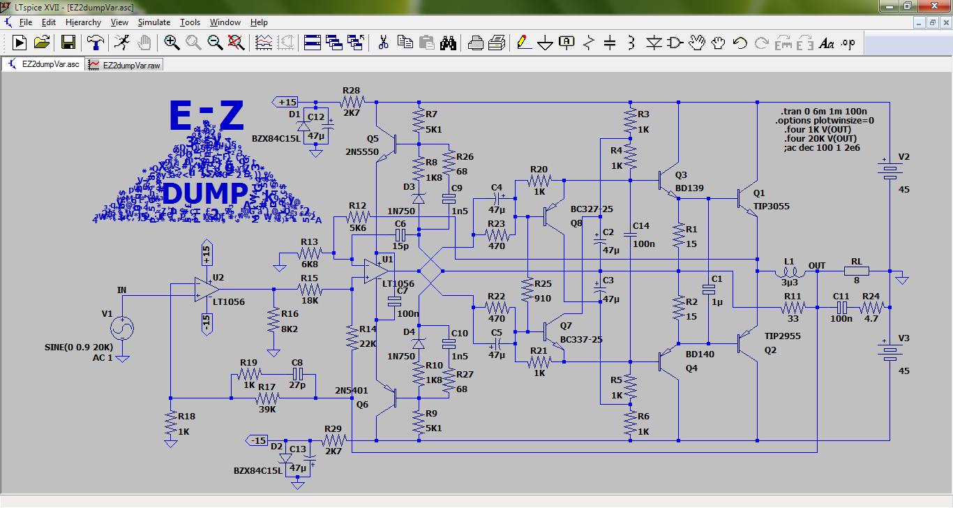

The problems seem to be partly a simulator issue: in october 2014, the 20K sim didn't show anything, but now with LTspiceXVII the instability is present.
It disappears with just a capacitor of less than 1nF across the driver bases.
It could be a sim artifact, or have some real bases, but with such small variations, reality is the only possible arbitrator.
If the problem appears in reality, a 100nF cap across the bases should solve it.
So what's the value?If the problem appears in reality, a 100nF cap across the bases should solve it.
In the post you say "less than 1 nF", then "100nF", and on the spice schematic it's 470pF.
I'm assuming 100pF - 470pF is correct.

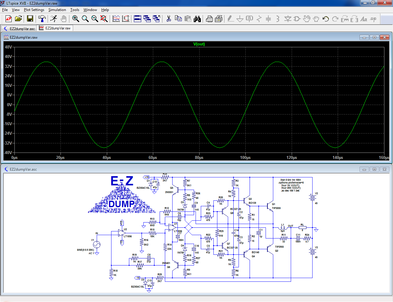

I tried to run simulations with models of actual transistors (MJLs),
and tried different models for drivers, etc...
I see this artifact/instability goes completely away with B-B capacitor of 1nF.
Smaller values help, but did not removed it completely...
But in my simulations this artifact/instability was much smaller than in Steve's simulations...
Barely visible.
With TIP output devices, this artifact/instability was not showing up at al.

That's funny, because I see it (now) with the TIP's, but back in 2014 I didn't see it.With TIP output devices, this artifact/instability was not showing up at al.
This probably means that it is related in some way to the sim configuration, but it could point to potential issues in a real circuit.
In my simulations, values higher than 1nF (e.g. 100nF) made this artifact to have smaller amplitude, but lasting longer.
1nF removed it completely.
Also I noticed that removal of Zobel RC makes this artifact look worse.
Anyway, I'm planning to avoid this cap in initial build, and see how it looks like...

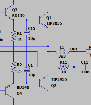

Another possibility?
The speed-up cap seems enough for Minek's models but not enough for LVs. But I found another "solution". Ie put some voltage on the collectors of Q7,8 by moving them to the bootstrap voltage. To avoid early effect? I avoided going directly to the rails due to the limited voltage capability of Q7,8. Another possibility is use the op-amp voltages.
This seems to happen when Q1 stops conducting and the revision of R1,2,11 and caps works well.
