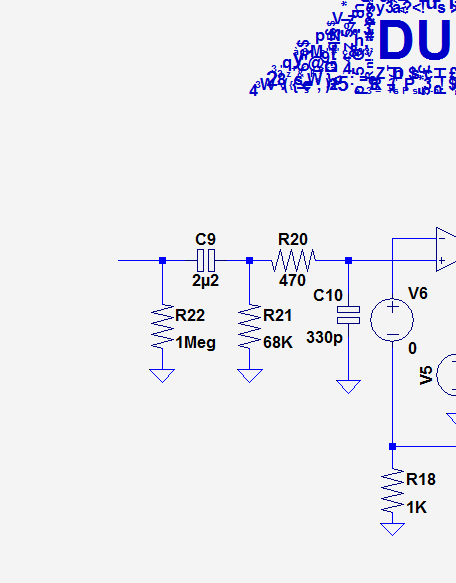

The input should have the standard DC blocking cap + the HF filter, like the circlophone, or any normal amp.
So say like in Circlophone: 330pF to the ground, 470Ohm in sequence to the input cap (say 4u7)
Any resistor to the ground after the input cap?
If so, what value? Circlo has 10k..

Something else I forgot to mention: in its present form, the amplifier is completely DC-coupled. Some see it as an advantage, but in general people prefer AC coupling, because it keeps the output offset well under 10mV.
To make it AC-coupled, all that is needed is a 47µF or 100µF cap in series with R18; polarity is indifferent a it will never see more than a few mV, and the voltage can be as low as 2.5V.
Should be easy to implement if required
