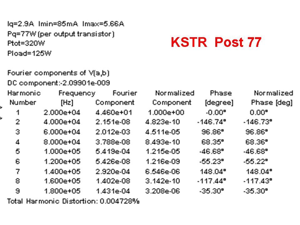

See KSTR Post #77 for original data. KSTR's simulation distortion information shows very low total distortion, but higher percentage of odd harmonic than even, especially upper odd harmonics. The ExtremeA supersymm topology cancels out even harmonics, leaving a higher percentage odd harmonic content.
Has anyone run careful listening comparisons of this ExtremeA design against a single ended topology with low odd harmonic distortion? This ExtremeA amp would provide a good test of the well debated topic: Do amps with very low measured distortion sound better than amps with modest even harmonic but very low third harmonic plus very low upper odd harmonic distortion.
Does anyone have an LTC Spice schematic file for ExtremeA they can post?

LTspice and Spice were used during the development phase of the ExtremA as the amplifier was extensively modelled prior to building up the first prototype. I'm not posting the files here for obvious reasons.
Having said that I do need to comment that using LTspice, or any other simulation, for a comparison between amps is a fool's errand. You can't compare amps based on a simulation that doesn't take into account all the issues you'll run into in practice.
It is simply another tool in the toolkit that allows you to achieve your goals more quickly, as less prototypes need to be constructed and optimized, but it is hardly conclusive. Besides the simulation's results are greatly influenced by the accuracy of the models used, I spent considerable time making sure that they were. Asking just 'someone' for a LTspice schematic file is a bit of a gamble, as who says the models used are accurate?
Sander.
