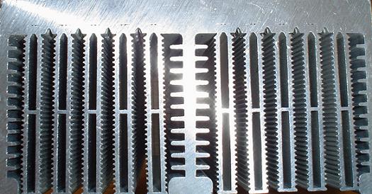

All things relative, shipping costs for ordering bulky stuff from California or Canada is just as painfull from this end, overhere even the mailing ticket receives a 35% sales and import tax surcharge.
Indeed a nice shop, 15 years ago it offered OPA627/637 and LT1028 at half the rate that was charged by the single supplier overhere, and without the requirement to buy a minimum (+uneven number) quantity.
It surprises me to see so many bite the bullet.
Assembling this amplifier for a lower continuous output power level would make logistics and thermal issues a lot easier.
A 250VA would be enough for a 50W/8 version, and a 0.25-0.30C/W heatsink is easy enough to find.
(not as much fun as superchargin though, like this one, as used for the A'd GB50d, <<0.1C/W )
