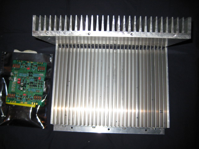

About heatsinks, I have no idea what rating these have but I do have four pieces of them.
Size is 30cm x 20cm x 4cm which should be about 12" x 8" x 1.6". The "baseplate" is 1cm thick and there are 30 or so grooves/fins where 1/3 of the material is left.
Any chance that one sink is enough for one channel or should I play safe and use two sinks from start?

Peter,
You can easily find out what rating they are. Simply attach a case style 20 or 50W resistor, for example 10-ohm, if possible via a copper plate to spread out the heat better. Then apply a known current and voltage and calculate the dissipation of the resistor. By simply measuring the temperature of the heatsink after 30-mins or so and determining the deltaT vs. the ambient temperature you can make a good guess of the heatsink's K/W rating.

Sander,
thanks for your quick reply. Actually I was thinking along those lines and I'll try it to see what it will give. I have a couple of Arcol HS100 6.8ohm which will be just about perfect for the job.

Peter (aka Pan),
your heatsink looks like the SK 56 from Fischer Elektronik in Germany (www.fischerelektronik.de) - with a length of 200mm it will have 0.3K/W (if it's anodized in black - in 'naked' (bare) aluminum the value would be slightly higher or, in other words, slightly worse).

Thanks!
It's not identical but close enough I'd say so the 0.3K/W rating seems close. My sinks have 28 fins between the outer pair while the one in your link has 24.
Seems I made the right choice when I decided to go with two fins per channel.
I was to lazy to measure the way Sander proposed.
As mentioned earlier I'll bridge two heatsinks with a thick slab of alu. I think it will be enought and if the slab becomes to hot I'll mount yet another slightly smaller heatsink onto the slab. It will be an frankenamp but who cares as long as it pass all the goodies that's fed into it! 🙂
