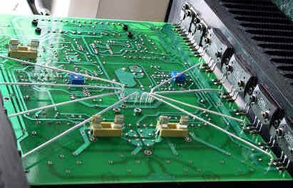

Question- is it ok to extend the leads of the Sanken output transistors a small amount by soldering a very short wire onto each terminal and then onto the board?
Reason1- these are going on used (large) heatsinks and its either extend the leads a tiny amount or mount the transistors on top of a small screw hole.
Reason2- the L/R channel boards are quite compact and they do not space the transistors out as much as I would like, so the transistors will be pretty far off center on the heatsinks reducing efficiency. I would need to extend the leads as much as 6 cm from each side of the board to get them centered on the heatsinks. I assume this is too much of an extension?
So 1 cm extension avoids mounting on top of a hole and 6 cm extension centers them on the heatsinks.
Answer : use extension boards (diy).
Reason 1 : You'll need something to mount/solder the base resistors on, they need to be acap to the base lead of the power devices.
Reason 2 : Why start with hardwiring if you have such pretty amp boards.
On the other hand, there's also the option to go for both stretch limo boards and hard (possibly even silverplated solid) wiring.

almost there...
Almost there.
See I'm really not extending the leads that much.
Have to put the transistors in these spots
since the heatsink was previously drilled in a lot of places.
Anyone got some spare thermal pads to spare that can be cut to the big Sanken size?
(or know where to by a sheet?)
Hi Igreen, what's the dimemsion of your heatsink?
It seems like your almost done. Let us know the results. 🙂
Fred
Yep, after I obtain some thermal pads I can turn this thing on (thanks for the recent post on this). Oh wait, I've got to remove the broken tap from the other heatsink too.
FYI, heatsinks are approx 17.5" (44 cm) long by 8" tall (20cm) by 1.5" (3.8 cm) thick.
