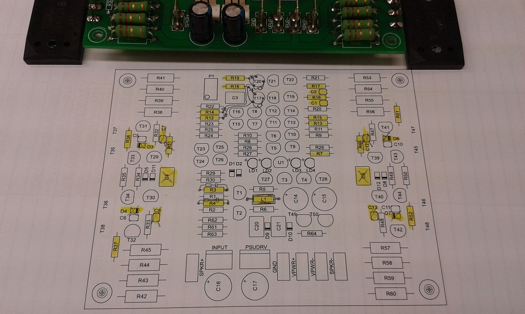

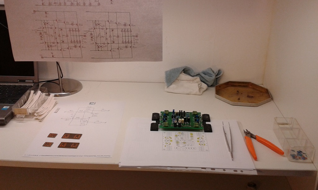

I fitted components to the PCB according to the simulation model created by BV. Today I could measure how the new circuit works.
What are the differences in measurement?
What are the differences hearings?
What changes are these exactly? It helps to be very meticulous here as the devil usually is in the details.
According to the diagram... post #415 http://www.diyaudio.com/forums/solid-state/96853-extrema-class-strikes-back-42.html#post4126803
No, according this one.. Improved clipping behaviour.

Thanks for the feedback and the .asc. Could you perhaps post a list of changes and explain what you've done exactly. I can see a number of diodes being added, some others removed and a variety of capacitors being added, as well as multiple RC networks being added/changed.
I am very curious about results that JMD01 will get from the modified circuit. I believe he will share the results with us.
This is the amplifier built that I have measured and analyzed in Prague and posted some measurements here.
Ah, excellent, if JMD01 is willing to explore other options as well I'd be very interested in seeing the results of the less invasive modifications I've proposed previously.
I don't have good news. The amplifier is needed to fine tune. Currently is slightly unstable.
Best regards
Bohdan
Best regards
Bohdan
Adjustments are unfortunate modifications lead to high frequency oscillations and instability.
