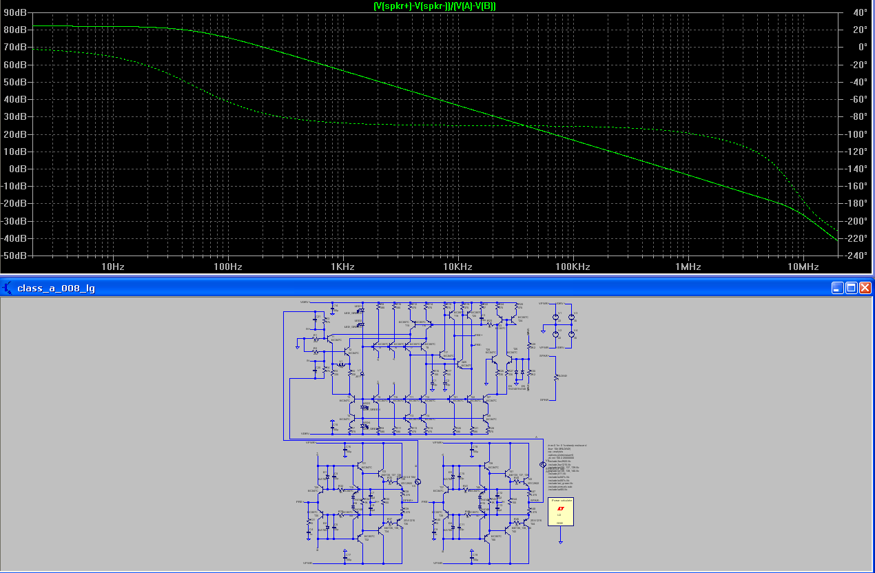

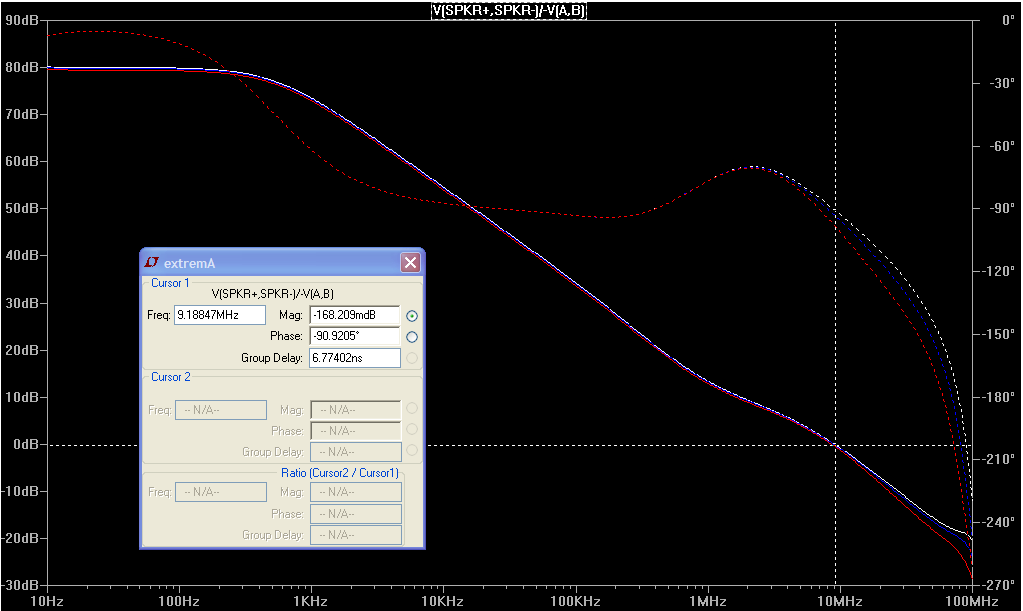

Seems to me there are two loops here: the bias control loop, and the main global loop and they are interacting.
@PMA,

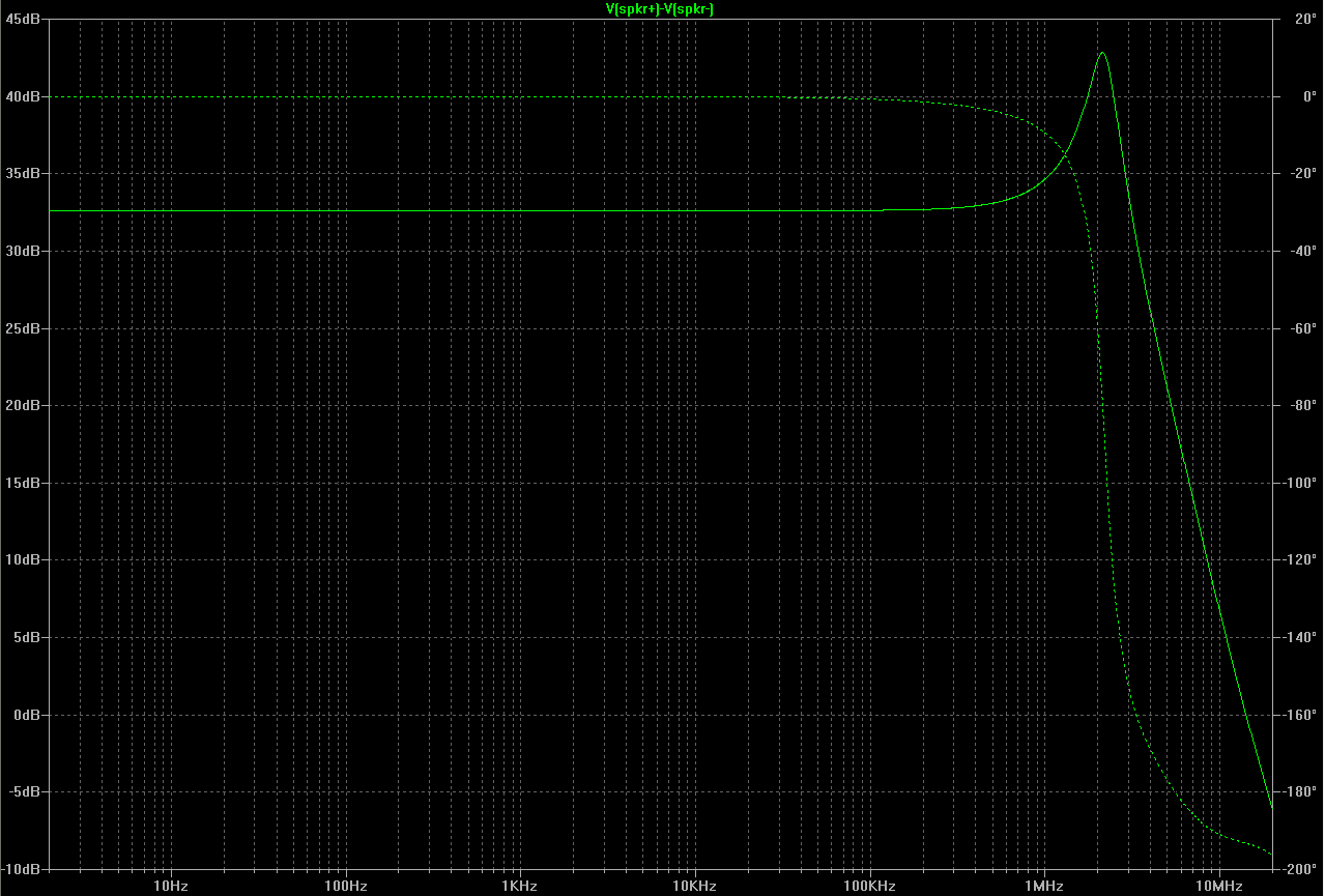

Those little caps are Bruno's solution for not needing an output Zobel/Thiele network, I never gave them much thought as he seemed pretty sure of himself that these would be the ticket.

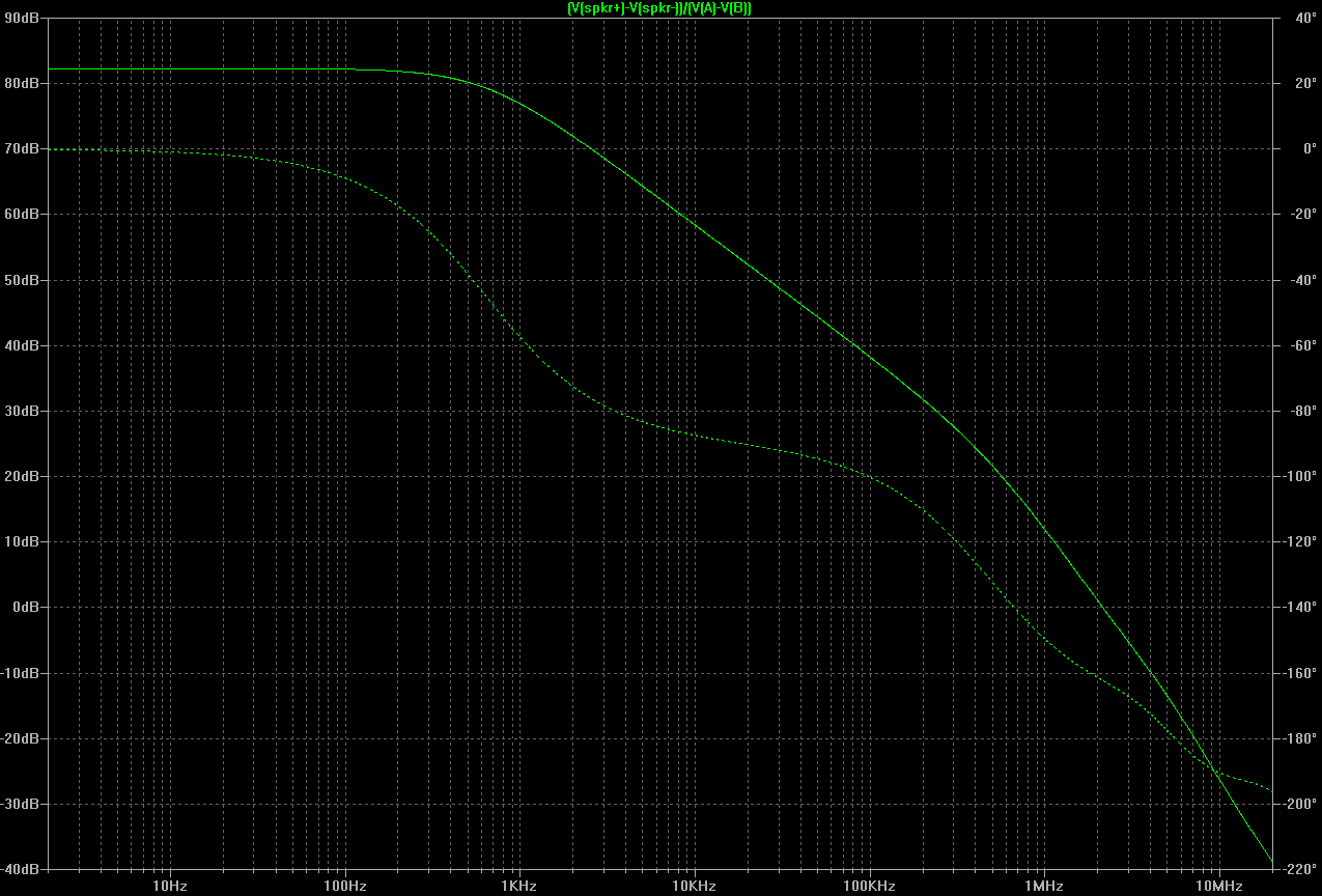

Regardless, thanks for posting the loop gain plot, I was meaning to give that another try tonight as my day was jam packed full of other stuff and I simply didn't have time.

Let's forget for a moment that these caps are connected to the OPS emitters and pretend they're connected directly to the output. In this case they are in parallel with the feedback resistors (47k) ; since they're 2.2pF, they'll provide some phase lead around 1MHz, which fits very well with the open loop gain/phase plot on the previous page.
Now, they are connected to the emitters and not the output, and that's why the zobel seems to be unnecessary.

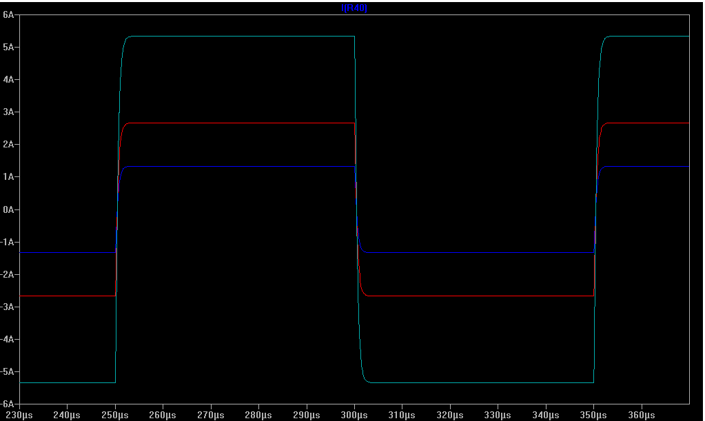

ExtremA with minor modifications.. Distortion in bridge configuration , load stepped from 16,8,4 ohm (4ohm-excursion in class AB)
square, load current for 16,8,4 ohm, SR (for load voltage) cca 50V/us, RC response
AC plot for loop gain

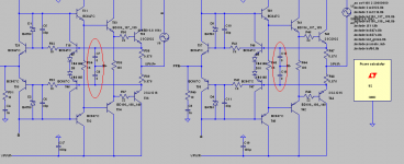

Mainly, I am wondering if this concept can be used here for the ExtremA to keep the distortion down when leaving class A.
