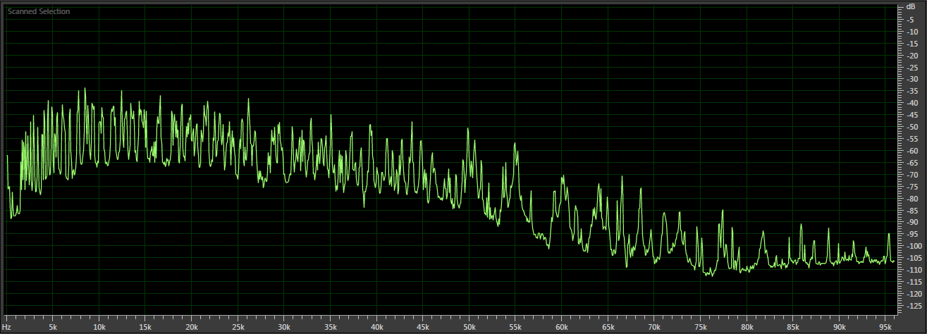

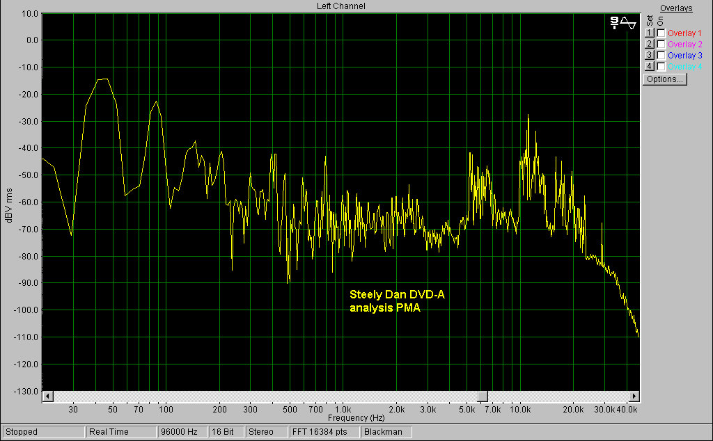

Regarding high frequencies >10kHz, some recordings have very high content of frequencies about 10kHz and above 10kHz.

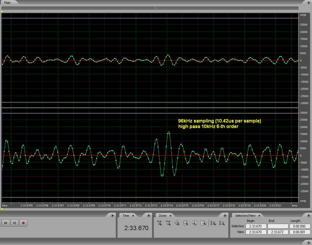

Pavel why not plot a distribution of rate of change directly, the FFT carries neither this nor crest factor information? I have done extensive studies with xDSL/multitone signals and the results are interesting.
many audio sources will push against the maximum rise-time envelope on a regular basis.
With op-amps with 100's of V/us of slew rate routinely available now you will eventually have to give up on this line of reasoning.
John . . . I cannot think of one modern OP amp for audio that has a slew rate problem. Not one.
The content of high frequencies does not mean that it should be a high rate of change.
Only the knowledge of the voltage gives a comprehensive picture of the need for speed.

I have posted a time domain record (not only FFT) with 96kHz sampling rate, you can read dv/dt directly and multiple it to get output SR at the amplifier output. Your suggestion that 1.6V/us is enough for a 100W/8 ohm amplifier is a nonsense. Even 10V/us that ExtremA measured is very low. You are also forgetting that low SR affects bad TIM/SID behavior and CCIF 19 + 20 kHz distortion.
My time record plot shows 30% full scale peak - to - peak swing step within 2 samples of 96kHz frequency.
